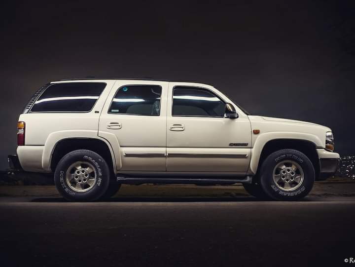

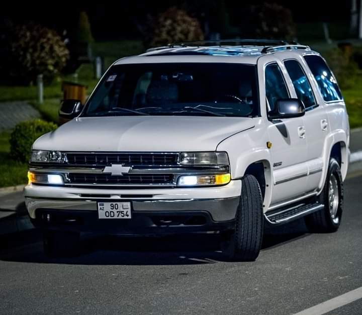

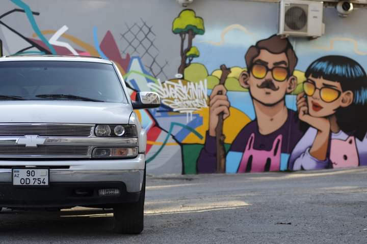

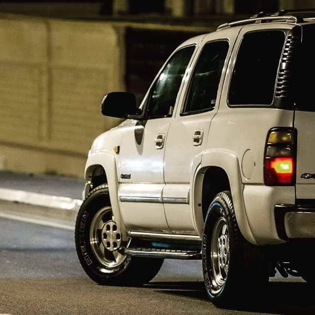

I am following the advices. Will update on what i discover. Attached are some older photos of my rig
