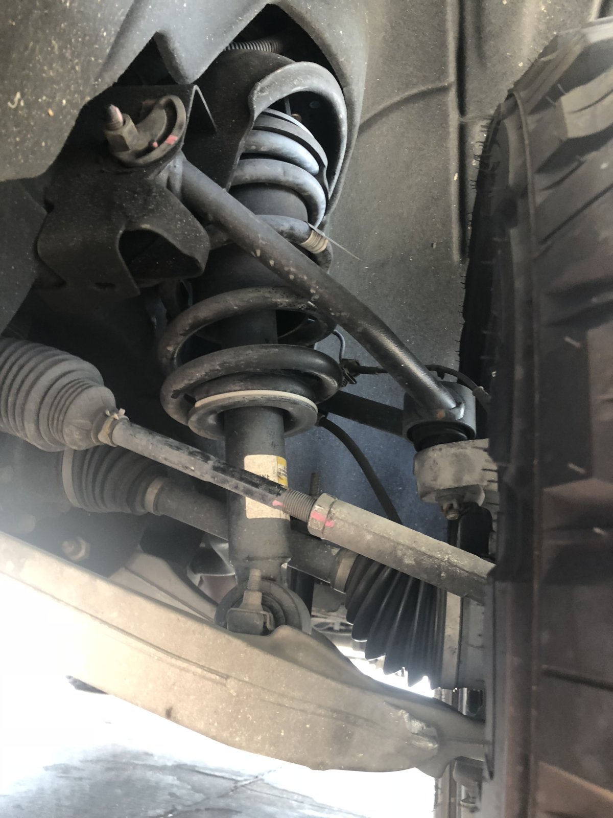

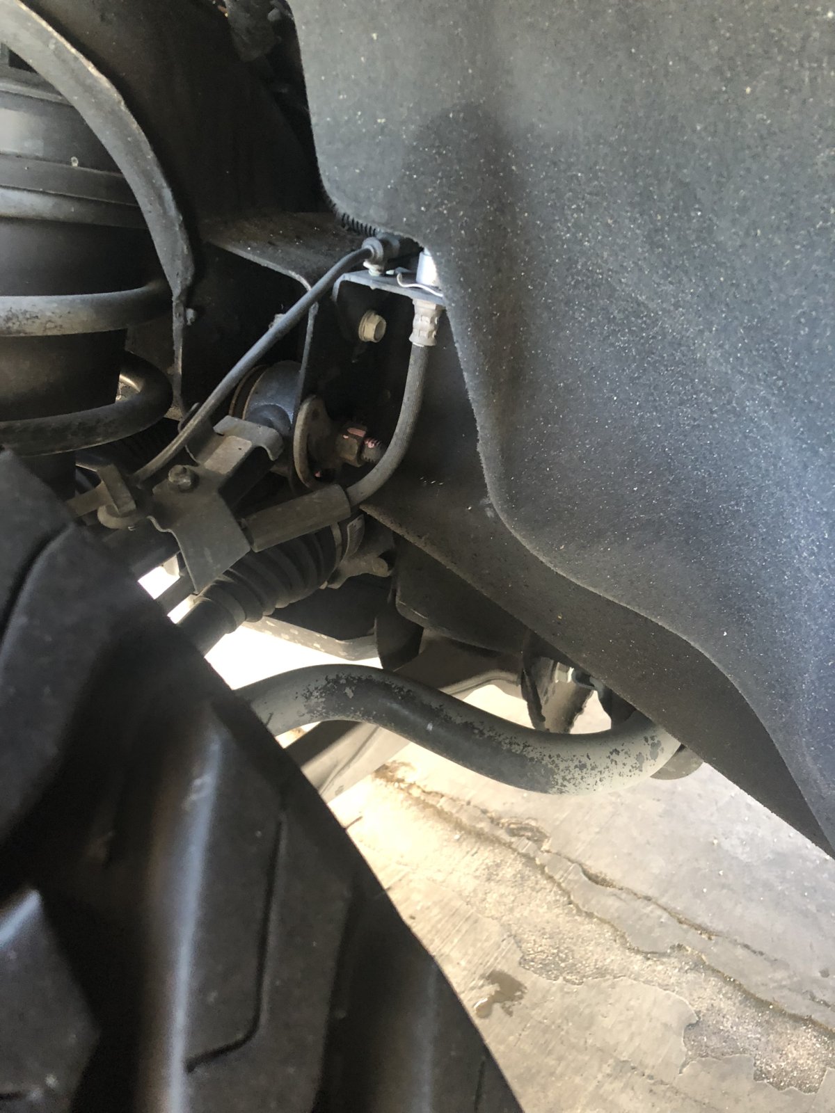

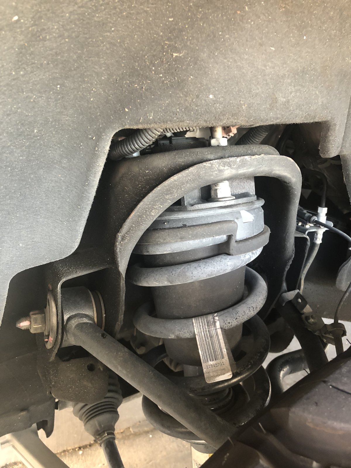

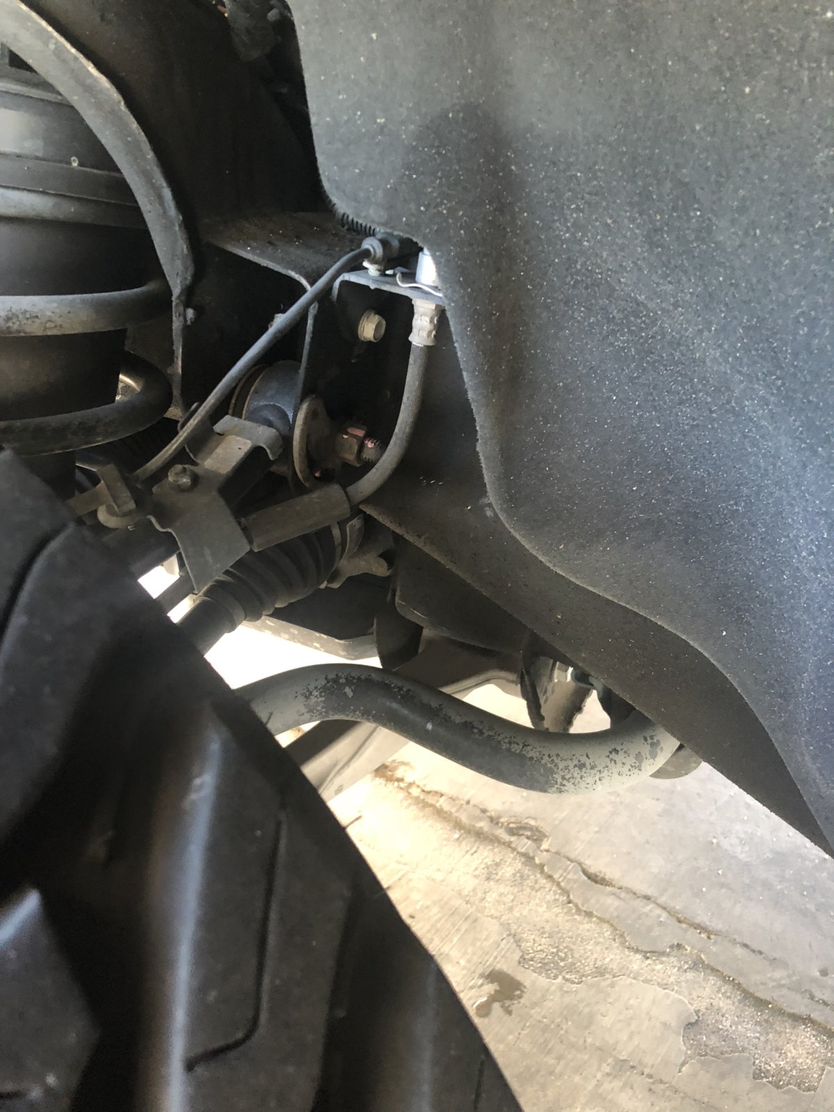

Photos of the underside to get ideas?
Let me know if this helps at all - the rattle sounds metallic, and it not blunted it sounds like something is hitting the frame of the car and then that sound is carrying up to the drivers front side
The sway bar does not rub, btw, although it may look like it I added a pan hard bar too a while back to keep everything straight

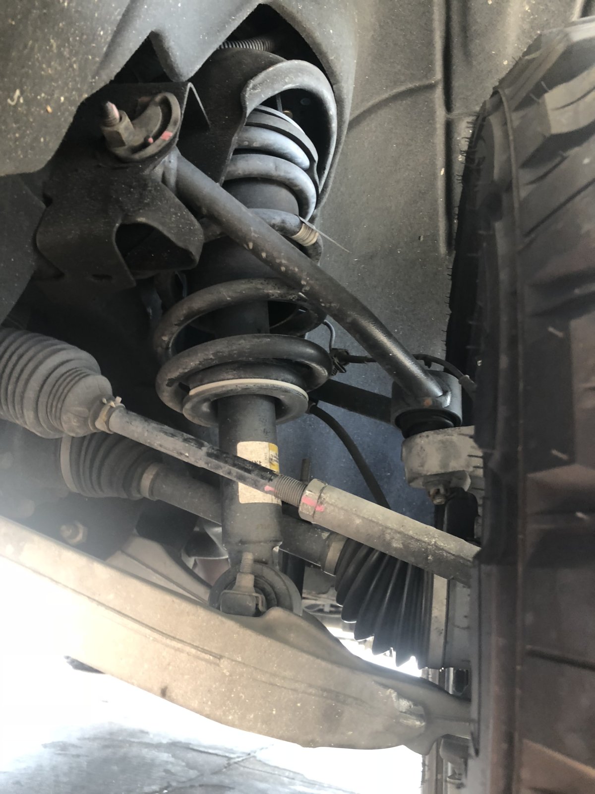

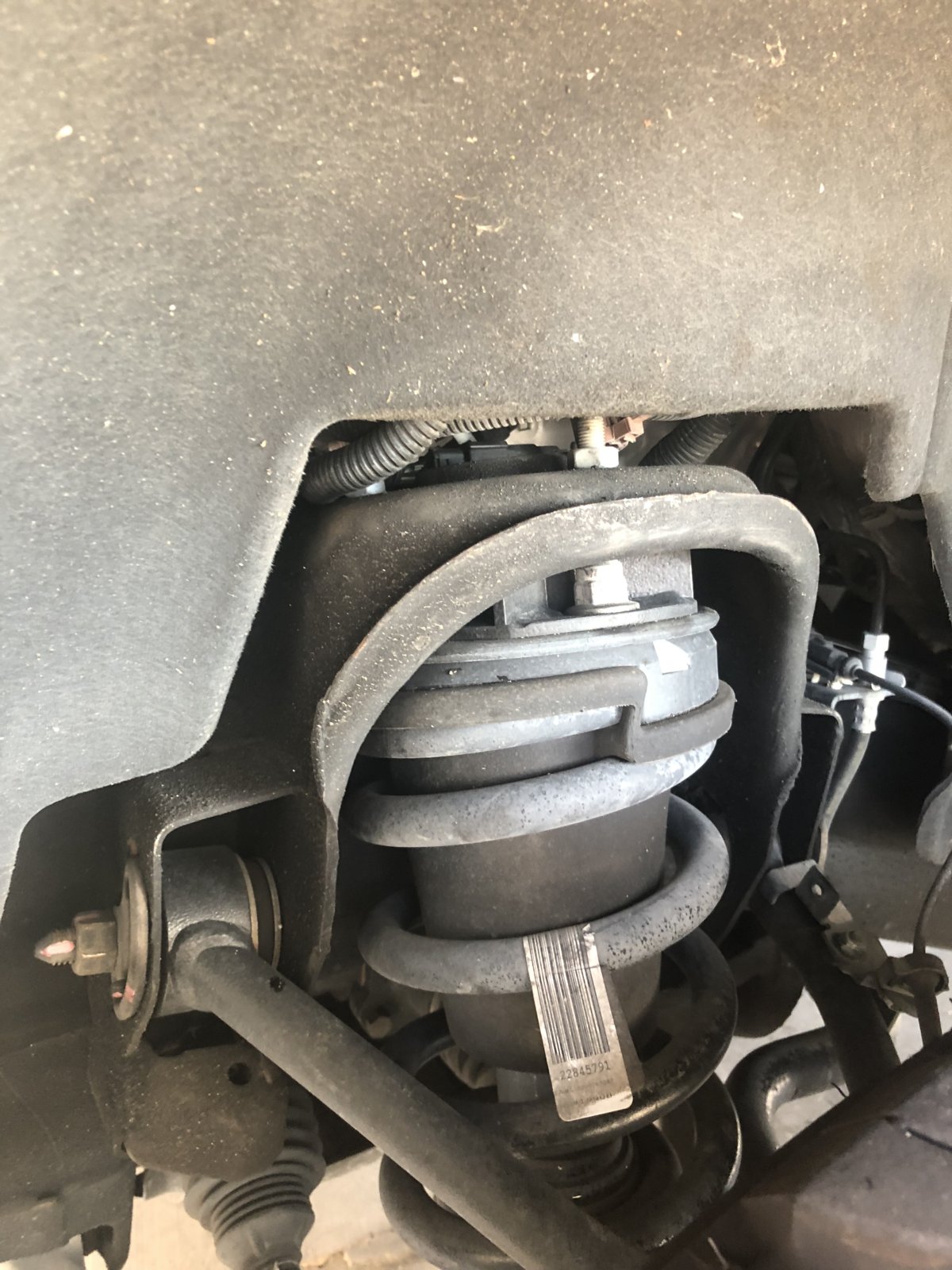

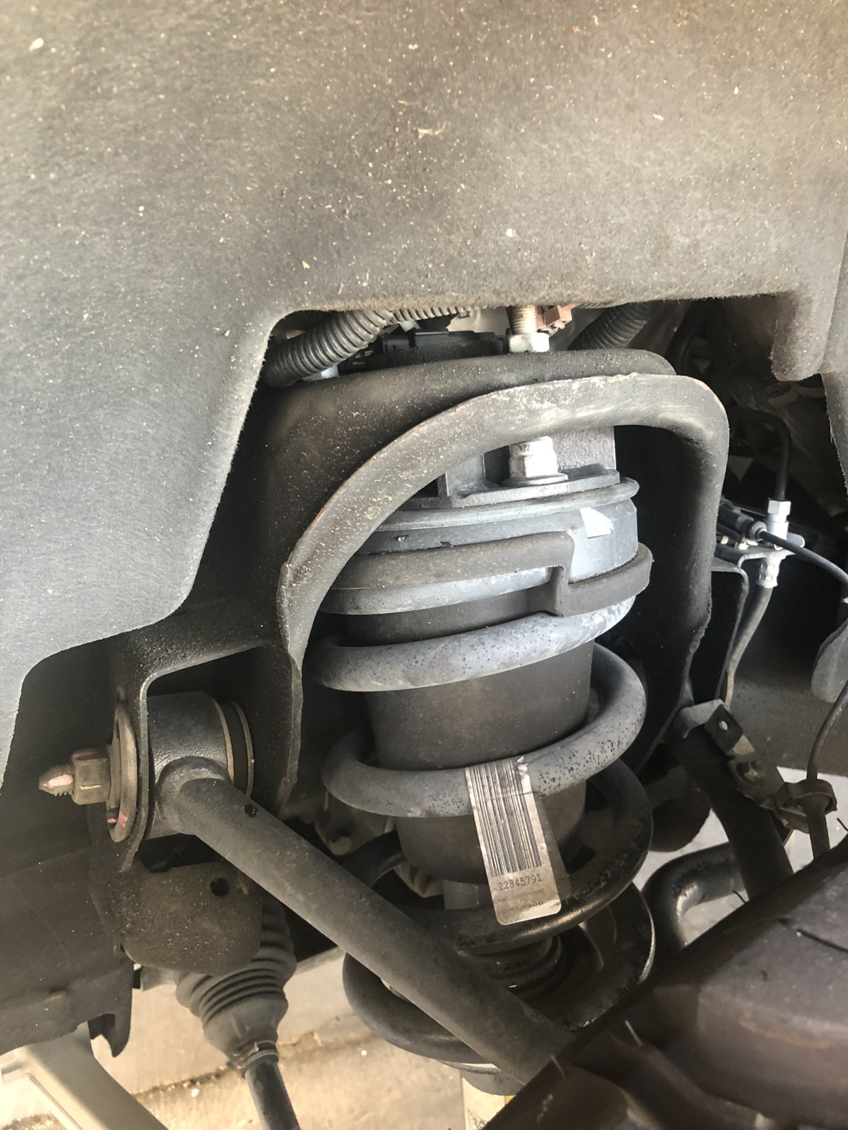

The sway bar does not rub, btw, although it may look like it I added a pan hard bar too a while back to keep everything straight View attachment 201559View attachment 201560View attachment 201561View attachment 201562

And here is the offender

If you hadn't said "left front," I would have said exhaust heat shield. You may still want to check it though...
yea I will check it. Listening to the rattle now. Really ruins the driving experience.
