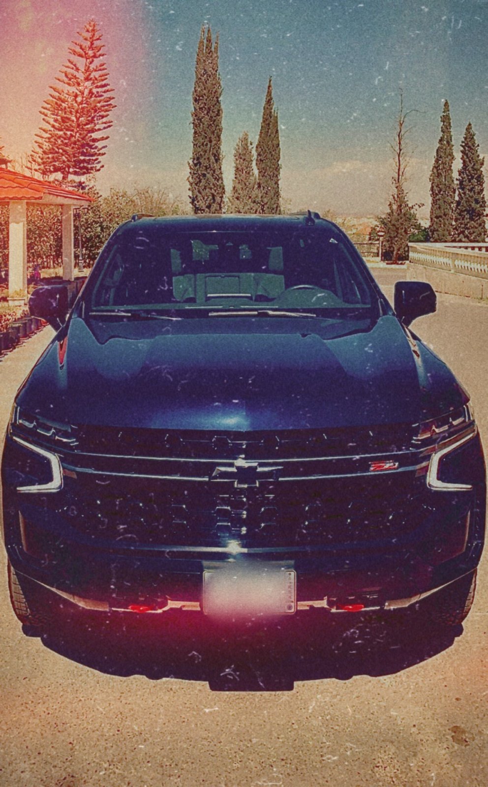

Thats a 34.5" in tire, in essence a 35. Are you lifting? Aside from the potential wheel issue, I have yet to see anyone fit a 35" tire without at least a 3.5" lift and thats with some trimming.
Good luck and let us know how it turns out for sure!

Dwsmoot I live in KSA I have zero options here for trimming or leveling up :(
and your car looks fantastic
