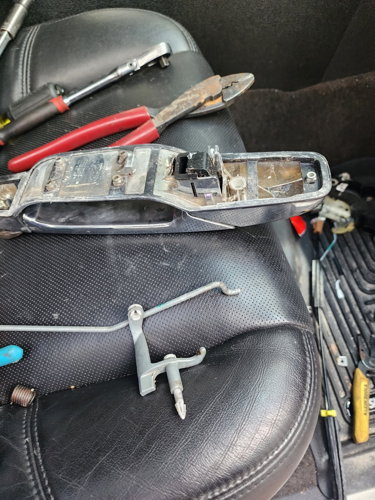

and my damn passenger door handle broke, just pulls out now so have to pull the door card off and see wtf thats about. wasnt hard to to pull or anything. not sure if the rods or cable is stuck or something

Handle broke, can't get gm for a week or two...so against my better judgement going to try the dorman
