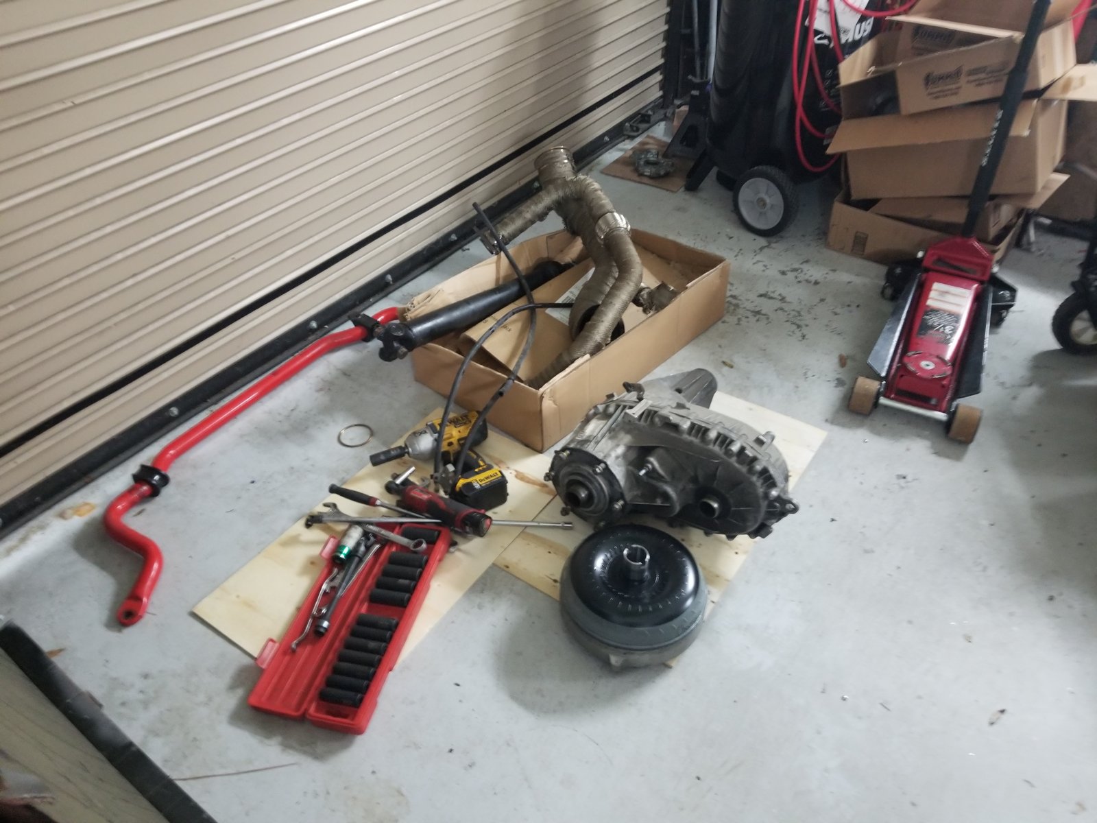

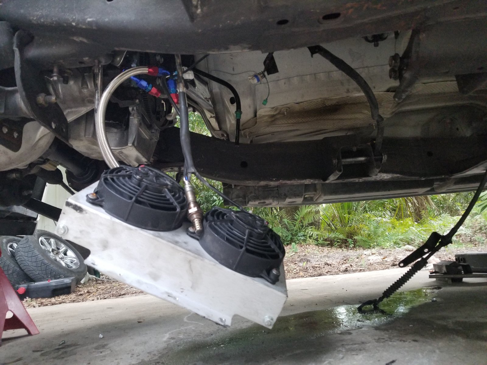

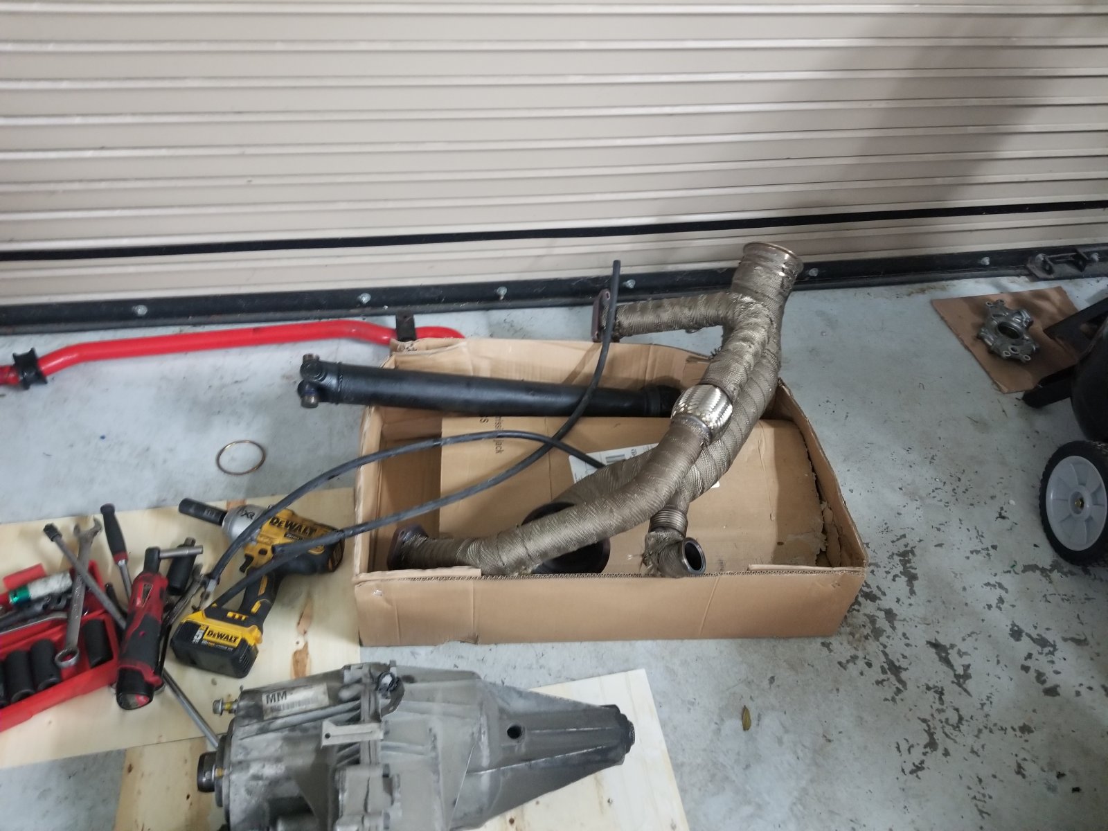

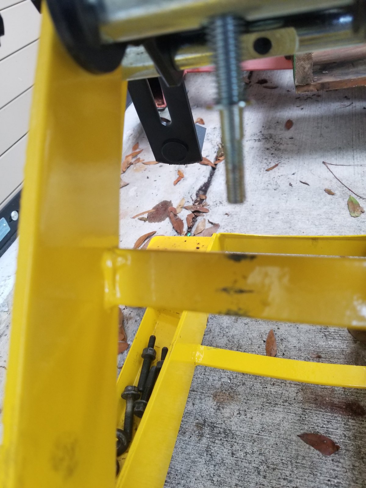

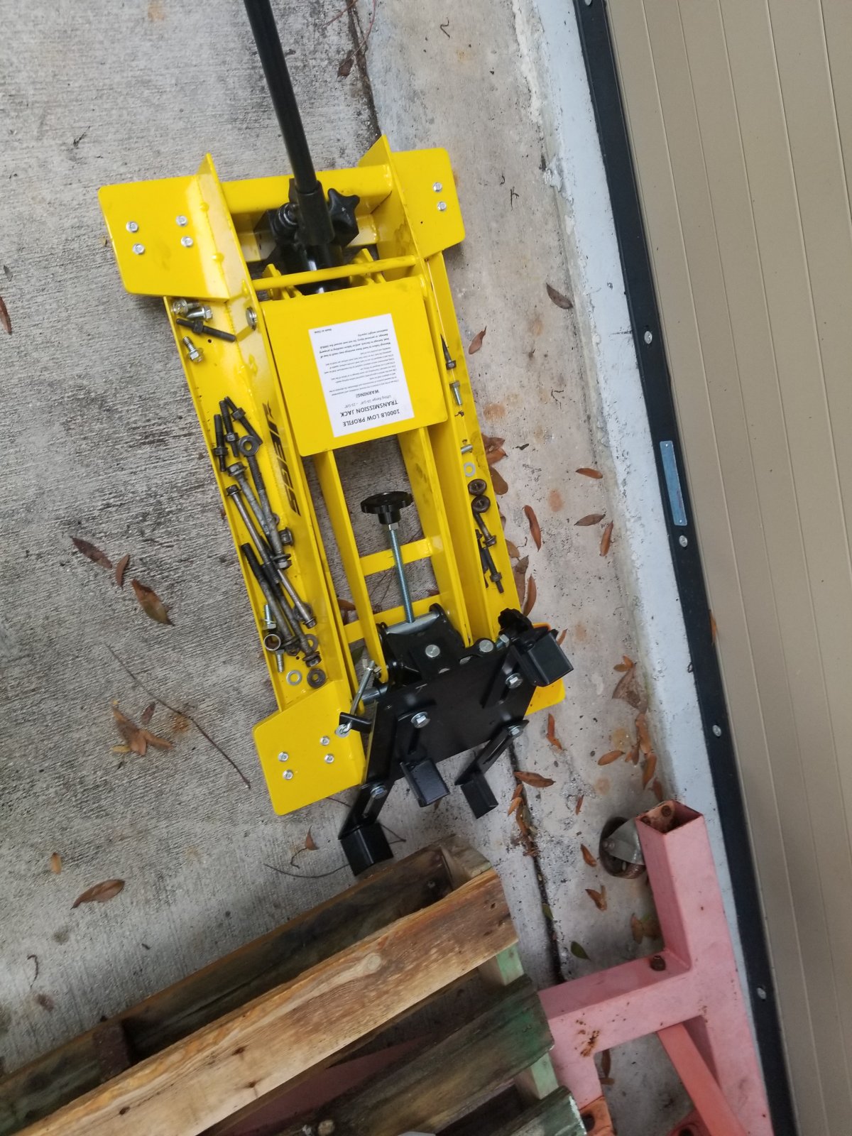

started out the day with the goal of atleast getting the transfer case out so i can bolt it to the 4l80 adapter and get an output shaft measurement. to do that had to drop drive shafts, to do that had to pull the front sway bar and crossover... to pull the cross over i have to pull the down pipe... to pull it i had to remove a section of exhaust, etc ,etc. took out the aux trans cooler cause the 4l80 lines are on the other side and will prob have to redo most of them.

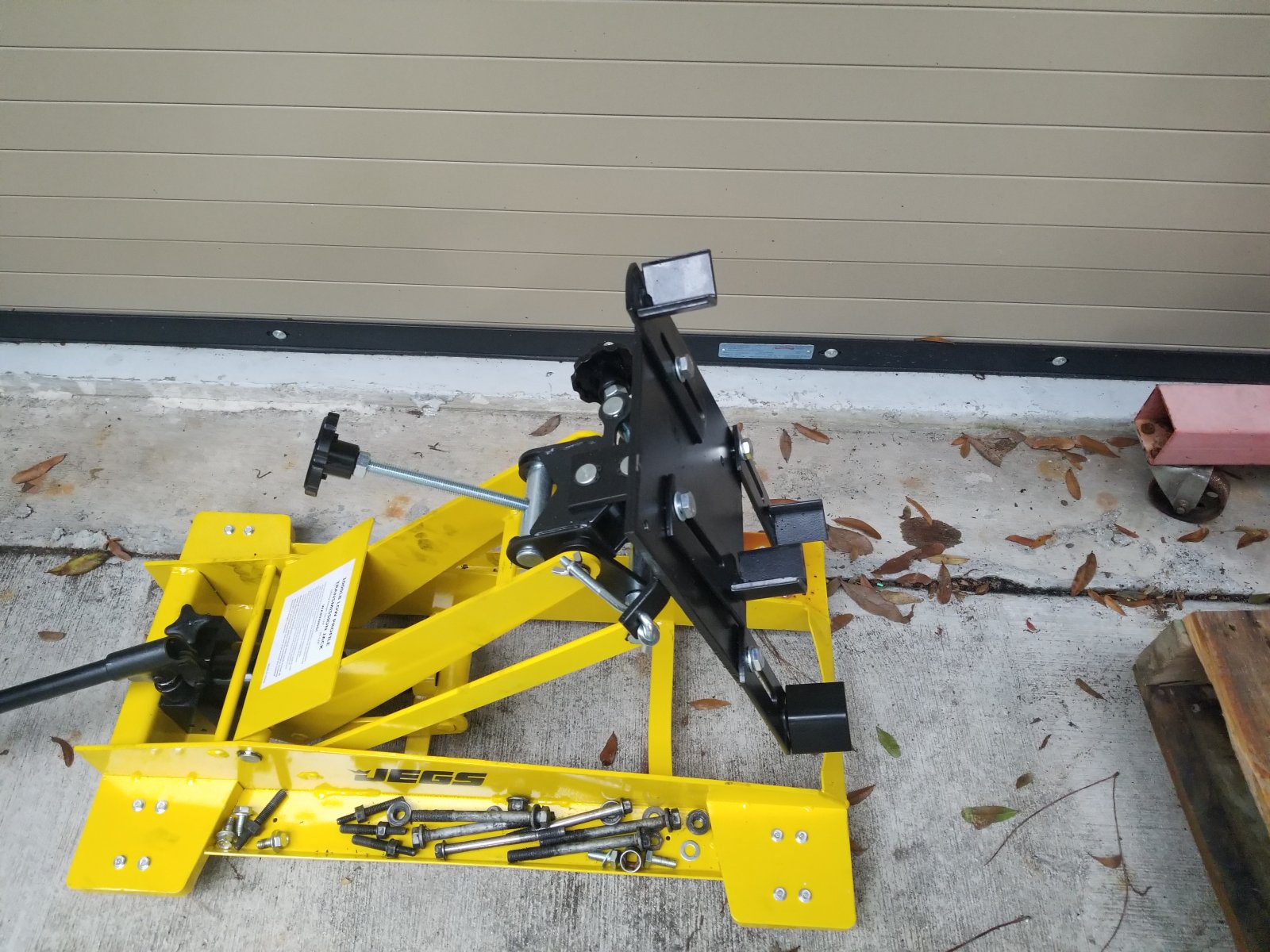

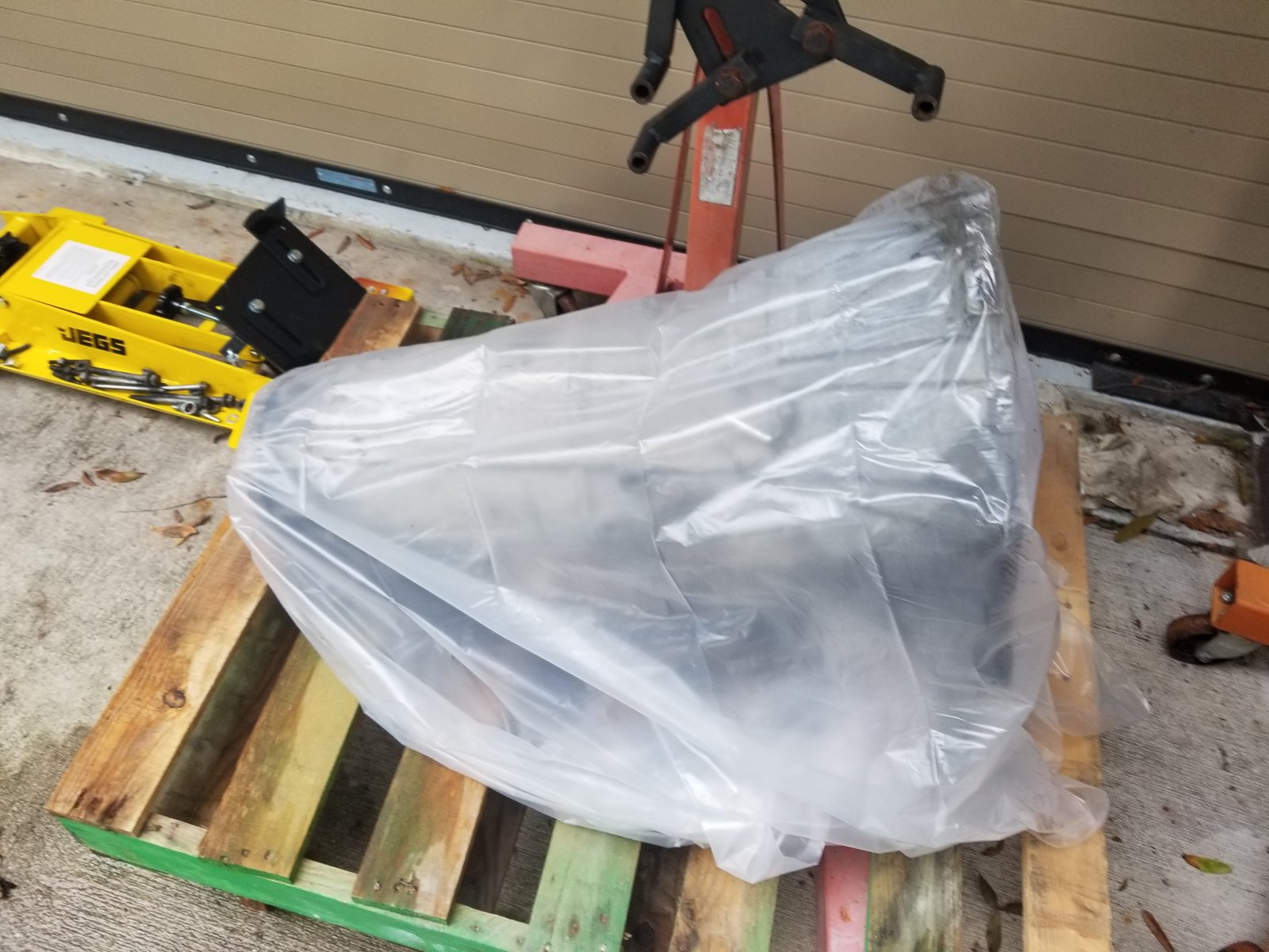

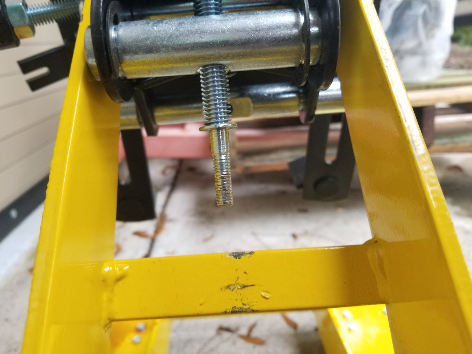

removed the transmission crossmember to get the transfer case out, wasnt to bad top bolt a little bit of a pain in the ass, but just really need to break them loose then can remove by hand. at that point there really wasnt anything else holding the bellhousing bolts on. removed the shift linkage, fuel line supports, and wiring to the trans. took it old school and used three feet of extensions and got all the top bolts out of the bellhousing with the trans jack under it to support it, removed the rest. she came right out. at this point i was thinkin damn trans jack really makes this easy. started lowering it down leveling it out with the pedestal knobs n crap got it almost all the way down and the threaded rod for the tilt just ripped the nut off of it and front of the trans hit the ground lol, what a pos. so i dragged the trans out from under the truck just threw it on a pallet and wrapped it up for now.
i need to pull the flex plate back off and replace the rear main seal, had a little mishap with pcv system and blew some oil out of it, after i fixed it there was still a little drip but not sure if it was residual or seal bad so i grabbed new gasket and seal no real rush to get that done anytime soon though.

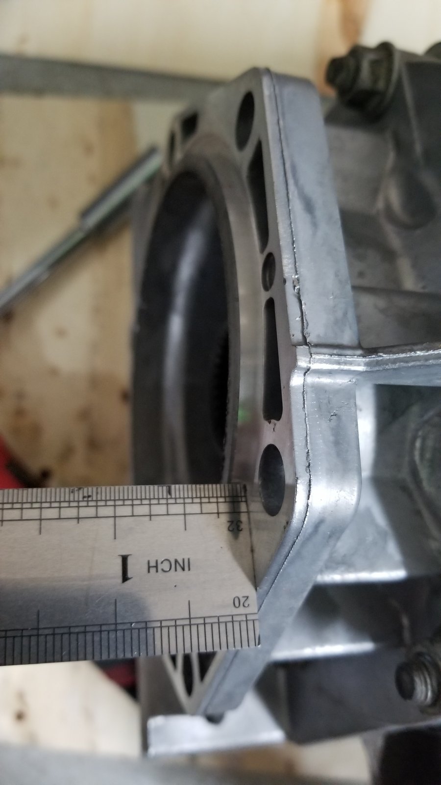

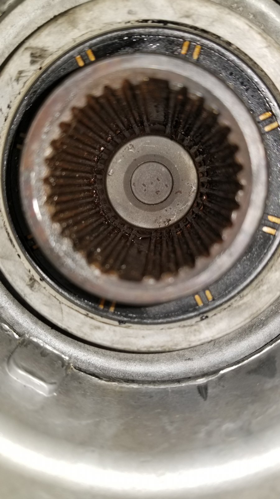

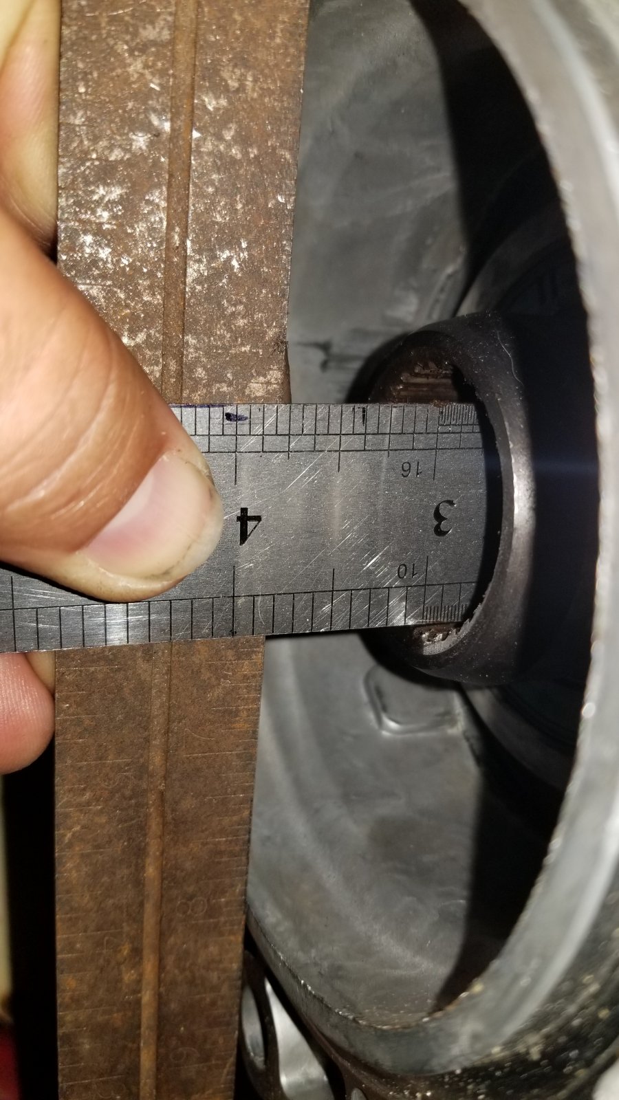

Measuring for 4l80 output shaft...you can see the 6l80 is about 1/2" from bottoming out so guessing this doesnt have to be so critical.
Looks like 3-3/4 to the lip, about 3/16 for that lip, hold it off the back atleast a 1/4" ...should be fine at about 3-1/4" of output shaft

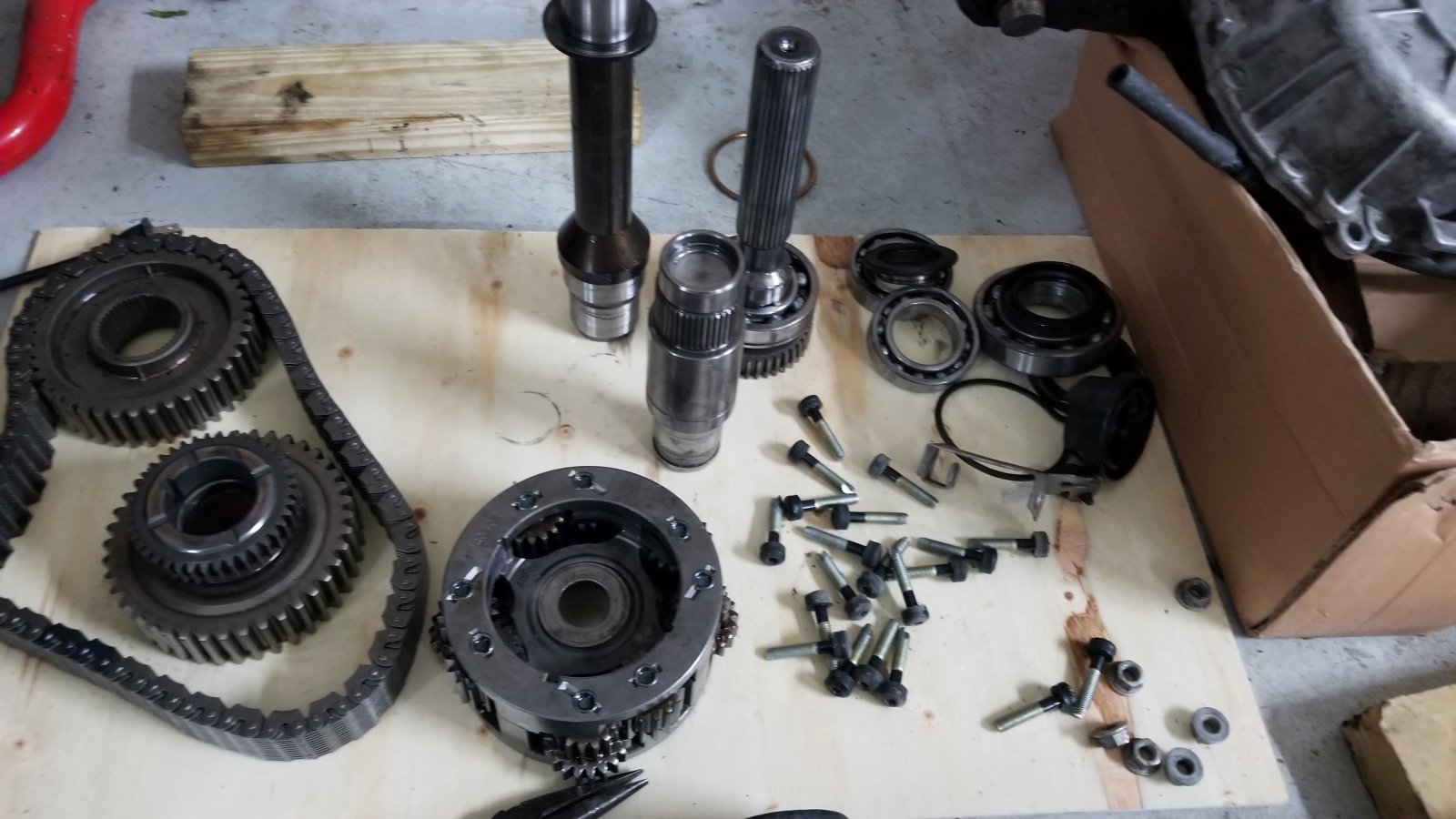

Also, transfer case sounds a little crunchy , will probably split tomorrow and see if it's worth saving. I have been eyeing the older np149 awd transfer case as it uses a viscous coupler to split power between front/rear. But would require a machined input shaft to mate to 4l80 (or 6l80)

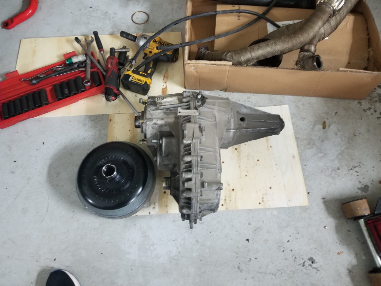

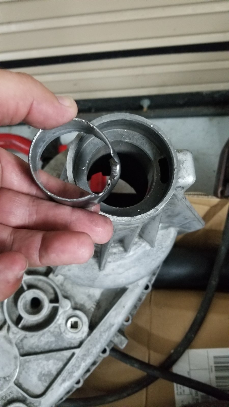

Took it apart and actually everything looks fine, will prob just do bearings, seals, and chain ~ $250ish for now to get it back on the road. Swapping xfer case later I can prep everything and should only be down a day
There is a bronze bushing at the rear outlet of the case that I'm not sure if I am supposed to replace but it was a mfer to get out. Not clear if it comes in the rebuilt kits, trying to find

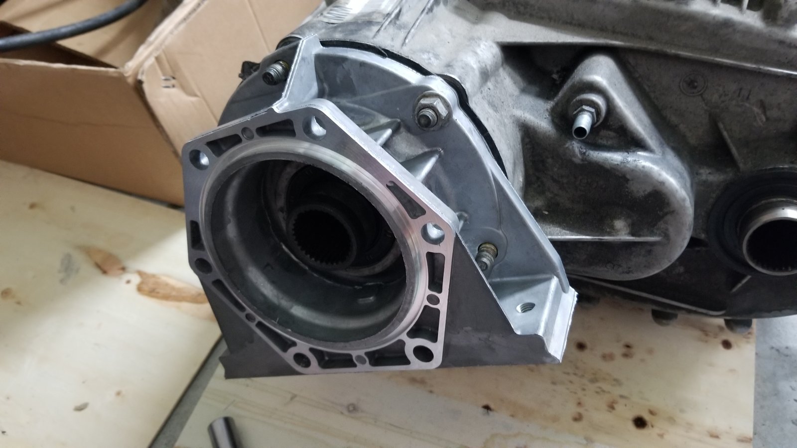

Bw4485, Nothing needed to mount to 4l80 has same 32 spline input and uses a transfer case adapter between trans and case like the 6l80. Just needs the correct length of output shaft. There are a few different case adapters not sure how much shorter you could go than the one I have
