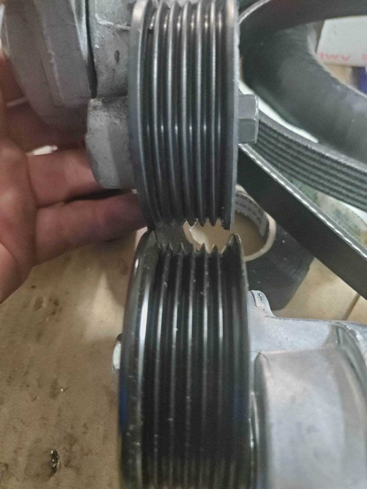

Them edges got some meat on em...pulley is a little bit larger, may have to get longer belt but looks alot better.

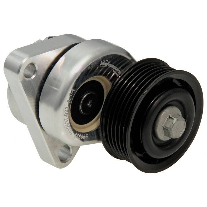

maybe something like this...
https://www.shoplitens.com/ls-series-racing-tensioner.html
52,954
nah the bracket for low alt only bolts to the front of the it, and it sits "through" the bracket in a halfmoon shape. the stock truck one doesnt even work with it - and the offset it wrong. turns out the tensioner is an ls1 fbody tensioner, i ordered a gates one? couldnt really find any upgraded hd ones that were still stock shaped
i think the steel pulley with the right belt should work good. not sure of the quality of the included tensioner either so swapping it to a name brand might help
Well of course it’s an $850 belt tensioner. They’re real proud of that one aren’t they? Jezus

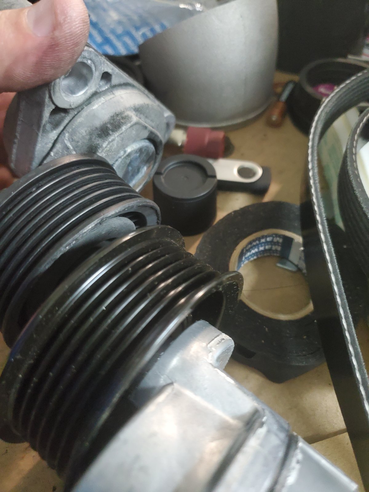

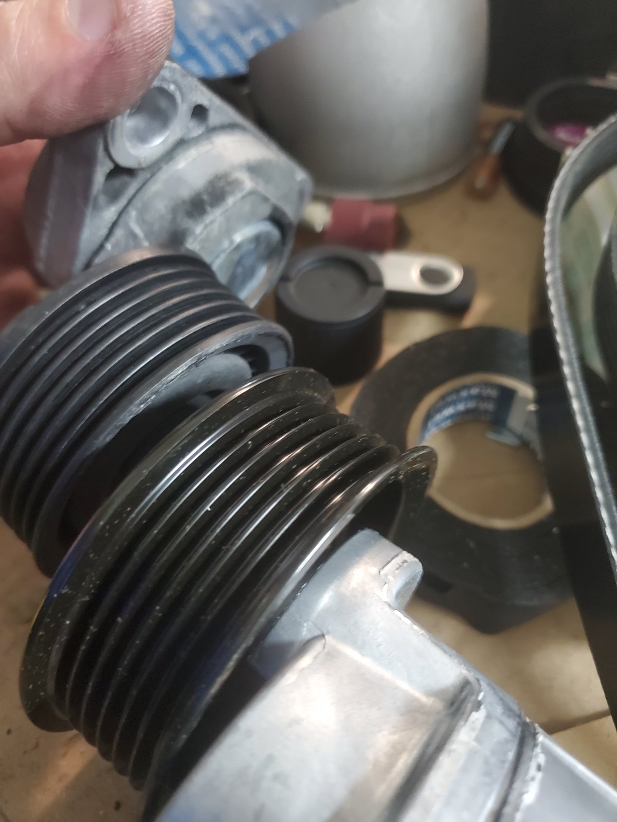

couldnt wait, and figured amazon would dik me over by waiting untill 9pm to deliver belts tomorrow.
stopped by auto parts store and grabbed pretty much the same ones i ordered. a 514 and a 520, swapped the pulley back to the larger, higher sider, and steel pulley. the 514 i wrapped it around and it was still pretty short lists as 51-7/16 tensioner would have been pretty much max'd out - put me right back in the same spot but with pulley. the other belt i got ~520 lists as 52-3/4 so i gave it a shot, fit seems just a hair too big. its sits at like the first line on the body.
there is 1 belt in between these two, they didnt have it amazon shipping was next week so i wanted to try these two out first and no matter when i ordered it was going to come next week. i think one between the two of these will still keep it in the middle of the tensioner marks nicely so ill give it a try. first couple rips with the longer belt stayed on pretty good...is pretty easy to throw on also so i'll keep them as a spare

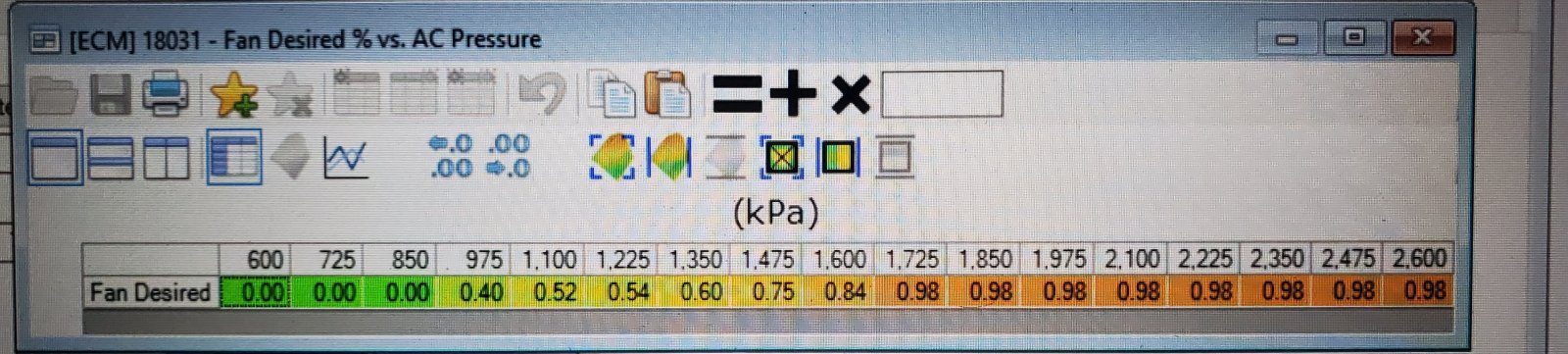

Sorry for the boring ac updates....

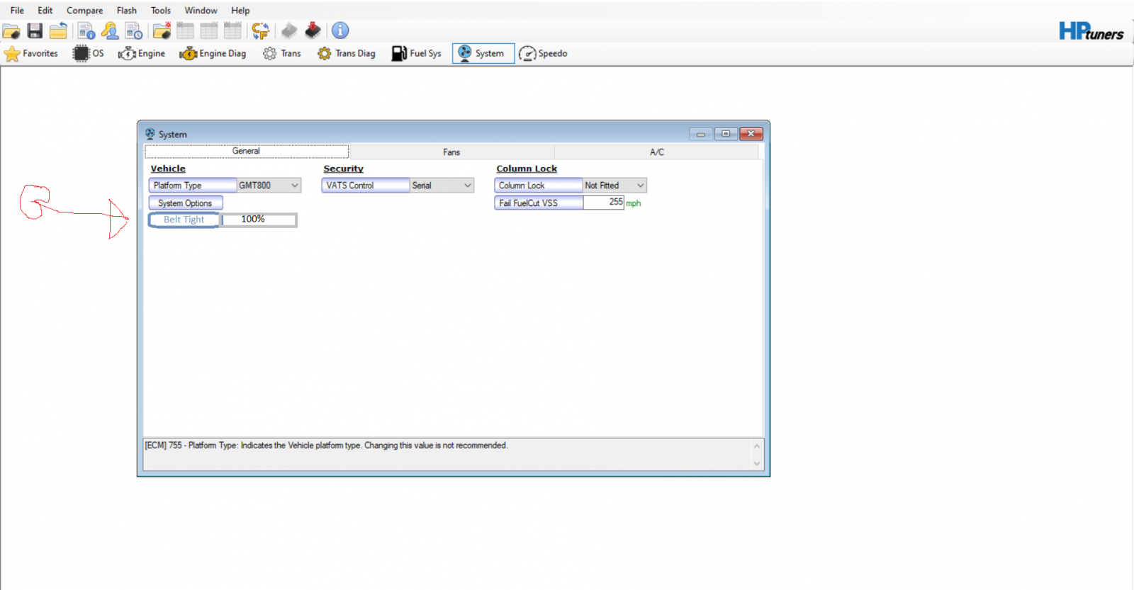

There's this table in hptuners
With chiller was instructions to have fans on 100% pretty much when ac is on...but I guess the way gm does this crap is they allow the heat itself to help with building ac pressure. And then turns fans on when pressure is up. So in my case I'm going to turn the fans on shortly before 240psi~1600kpa. Cause when I'm driving around the compressor cycles and pressure only goes up to like 140psi or so cause fans are on full blast
