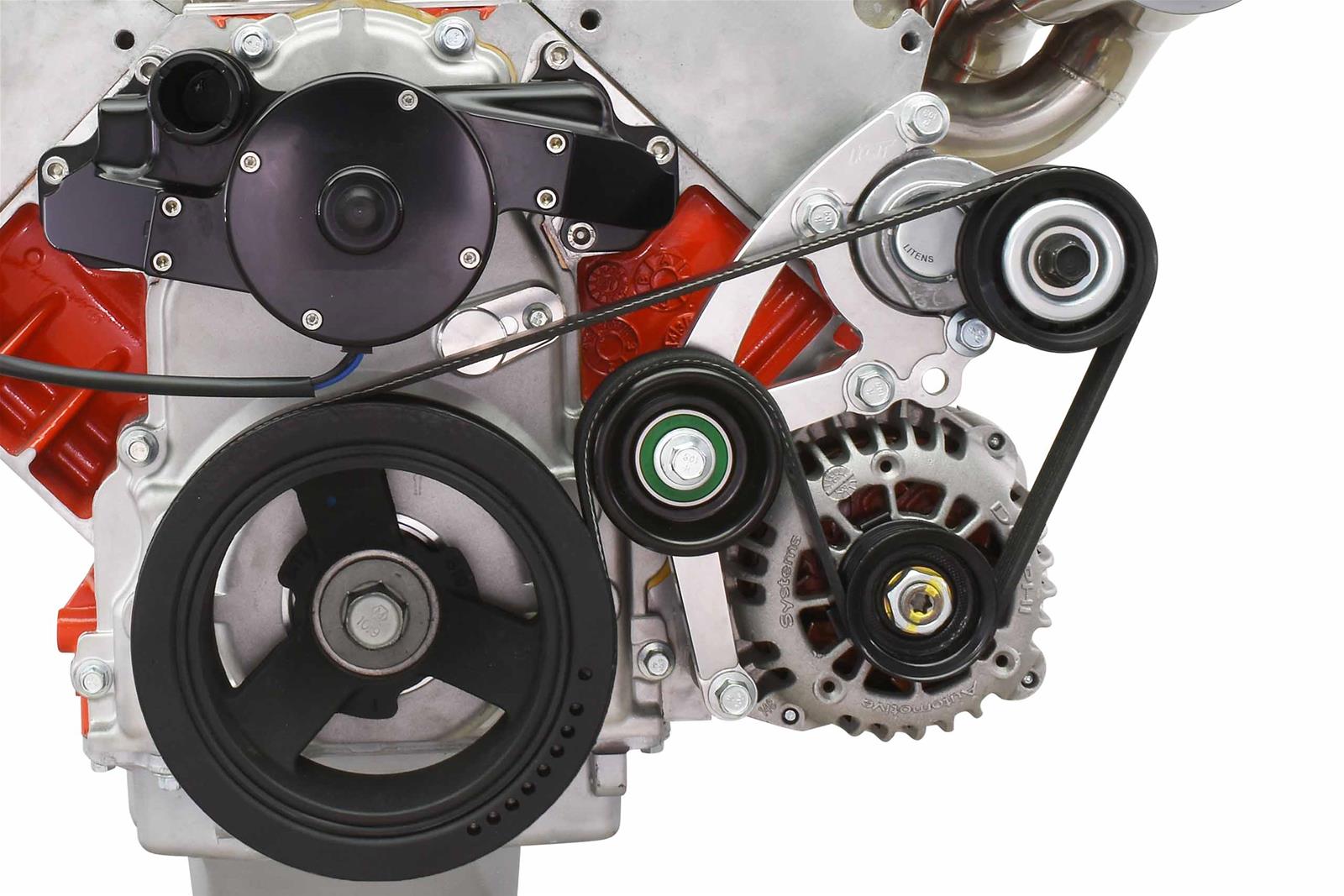

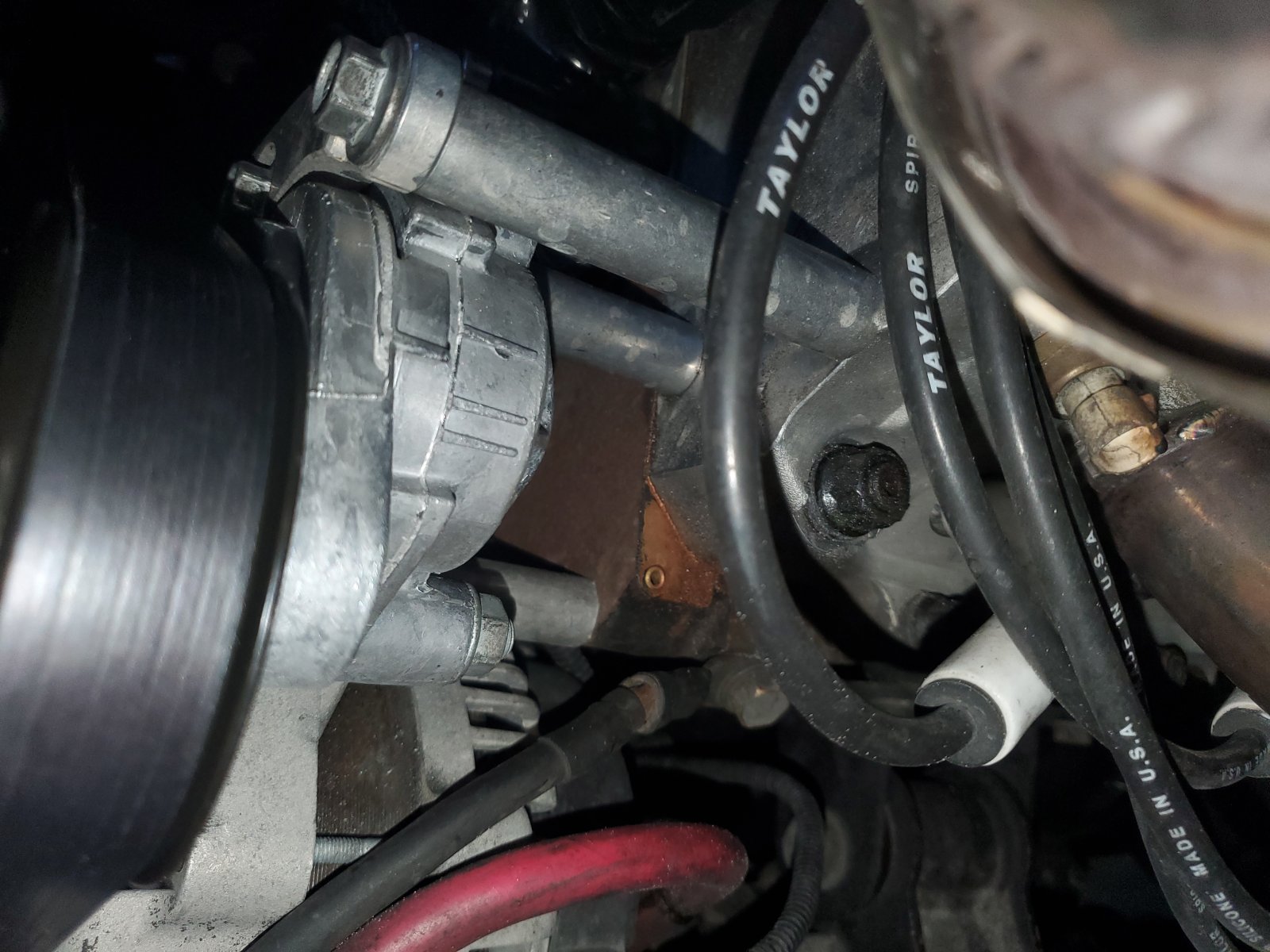

K060516 belt looks the best...the 520 belt was above the top notch but hadn't came off since new tensioner. I have 514 belt also but it says almost a whole inch shorter than the 516 so I think tensioner would be maxed out. I'll try 514 if I go thru the rest of them but I'm going to run this one
Is there no room to make one of the accessories adjustable so you can adjust where the tensioner runs?

negative, alt mounts to the block, this bracket grabs the two alt holes and attached the idler to the block*, tensioner mounts to the bracket with one to the head and another to the head
i think we're good tho at this point, new tensioner, better pulley, belt in the right spot on the tensioner

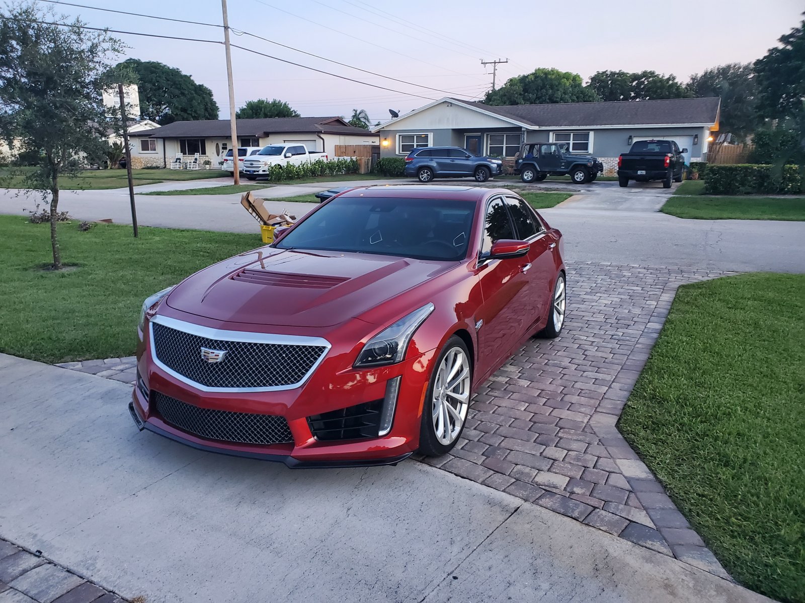

But I "needed" a new nice car. Since I completely ruined my denali. Something for weekends dinner etc. Ford hybrid is just feeling ragged out lately, wind noise, gotta slam all the doors to close, dirty.
randeez
randeez
Sep 29, 2017
8,170
25,874
south florida
2017, supercharged 6.2 LT4, 8sp, carbon fibre hood, lip, rear diffuser thiingy lip, abunch of accents on the interior also carbon
30k miles, certified pre owned, bolstered recaros, kind of upset it doesnt have ac seats but beggers cant be choosers. was bought, serviced, and traded at the same dealership, one owner .
Still under factory powertrain warranty for like 19 months and 40k miles.
You can see the cf while driving on the back of the hood :drool:
