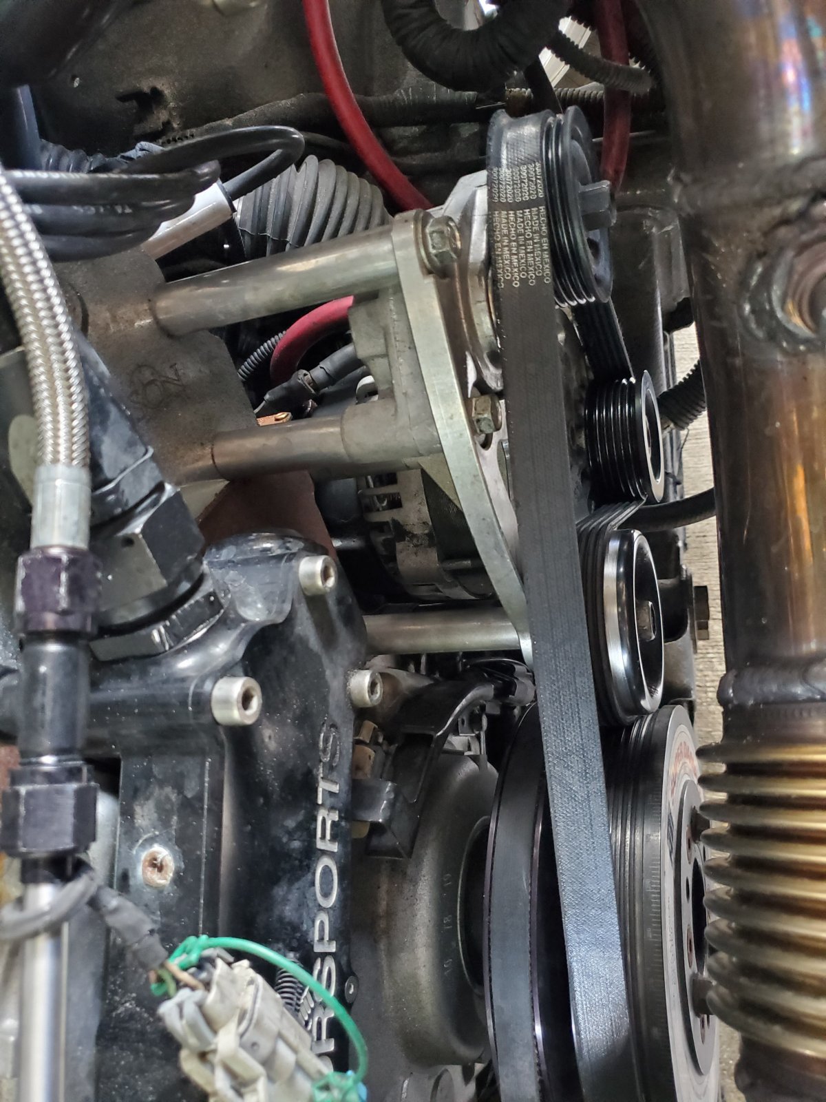

back to throwing belts fml :emotions122:
ive lost 3 belts today, two new ones and the old one i had it before i took it apart. ive got a new tensioner but it doesnt feel any stronger than the one thats on it now. i may try and space the pulley out a washer or two. the outside of my og belt started to fray up. i dont know. i ordered a couple more till i figure it out.
also ordered a generic coolant overflow tank seemed to want to spit some out and pull it back in after it cools down
I have a laser belt alignment tool set if you want to borrow it.
i might take you up on that. rode around town and grabbed all the 505k6 belts, spaced the pulley on the tensioner out a decent washer, prob a little less than 1/8 in and it made a trip with a couple pulls and stayed on. the plastic pulley itself kinda wobbles, maybe bearing a little worn, so i may see if i can find a steel one to replace it with

Err nevermind, popped the hood riding the inside of it a little bit lol, going to take the washer out , maybe shorten the spacers that came with this kit a hair

havent really messed with the belt - i just pulled the washer out from behind the tensioner pulley and threw a new belt on it, you can see where its rubber in the tensioner i would need to move it closer to the block to make it quit doing that, but it only happens high rpm bracket flexing or something i dont know. may see if i can find a pulley with some higher sides to keep the belt between it

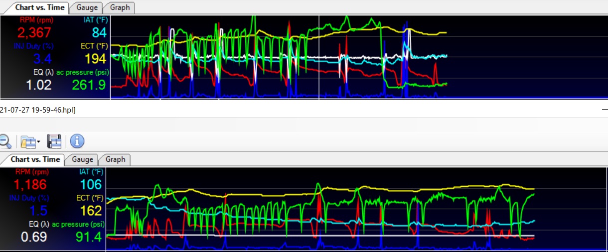

alrighty...so im down a big pump so all i can do is putt putt around anyway, so i decided to go out and see how hot it would get with the ac on, and of course it stayed perfectly cool, under 200 just how i would like it too. which in a way confirmed exactly what i thought lol.
so i graphed the ac pressure (green line) in the log next to the ECT (yellow line)
top cut was from a few days ago you can see the ac pressure cycling for a while - then all the sudden it just goes up and stays on a little over half way thru, thats when ECT starts to rise. where the pointer is its already at 261 so it continues to rise in pressure from there. also log shows ac clutch engages the whole time and fans off (fan off may be because of speed) but odd that compressor stayed on
bottom cut it it worked exactly like it should, temp rise over the entire trip went from 176>194 which is what i would expect it to do with the ac on. only real difference being i didnt do as many pulls (because no fuel pump) but cruising without ac on at all yields temp around 170 a couple degree rise after pull but comes back down pretty quick

So what's confusing is: it seems like when the fans come on, even on low they drop the pressure/temp, but the fans aren't even coming on. Which they should be because of the ac pressure and because of the ect (low to high should happen at about 190*) but they aren't coming on at all
im going to try and set the stock settings back for the ac pressure x fan % and disable/enable rpm and crap. basically i tried to make it disable the rpm over 3500rpm (enable when it drops back under 3400) stock was set 0/0 so im thinking it may be control by the bcm elsewhere and whatever ive done is causing a problem

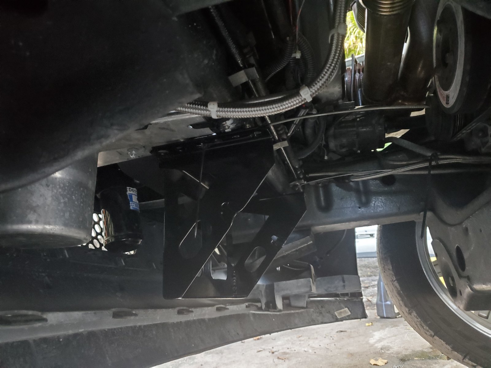

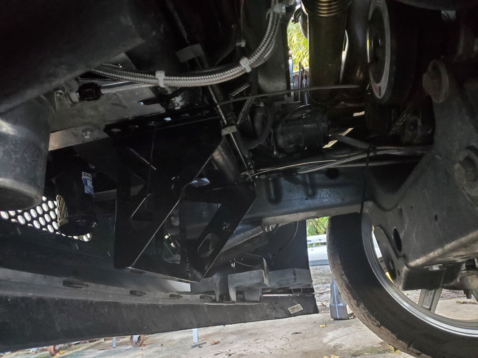

talked with fab guy about building a surge tank to go in the driverside battery box, i measured to make sure there was enough height there and we confirmed it with a similar truck up at his work, pump needs minimum 10" which seemed good had a comfortable 12" if we need it. and he doesnt need my truck sitting there the whole time to do it, since about any chevy truck from 2000+ has the same tray and theres a few there at any given time. i will prob bring mine over there before he does finish welding to make sure it fits 100%
tank a little bigger than the battery should yield ~2gal capacity. lines to the fuel rail will be short, going to route stock pump feed to the surge tank, keep the flex fuel sensor in that line, probably add a very fine 5-10 micron filter on it and hopefully not have to put a filter on the big pump outlet, and possibly add a fuel cooler tied into the chilled water or at least provisions for it if needed, and run a huge return 10/12an back to stock tank, make some changes in the tune to lower the psi it targets.

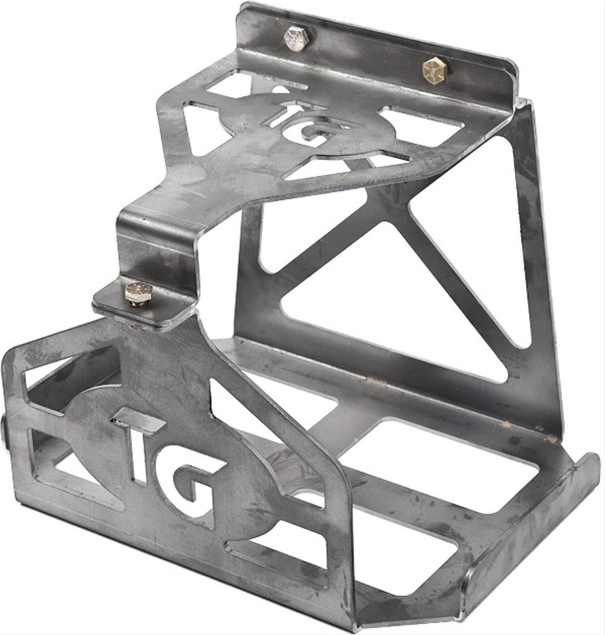

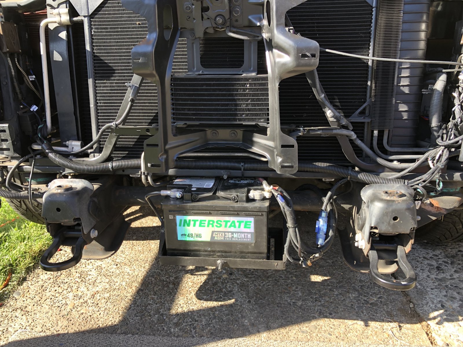

i was probably going to get a more "rugged" battery tray and face the battery back towards the engine, one that the clamp/brace encloses the whole thing, jacking it up i would be able to get it in and out it looks like, would make wiring a million times easier than installing it back where the spare tire was and running wire all the way forward. i dont think its going to take any more heat than where its already installed, if anything it would prob have more air circulate around it down in front. obvious downside is hitting anyone/thing, its about a a foot behind the crash bar and behind lowered any car i hit wouldnt go under it...crap on the road im pretty good about not hitting
do you notice the terminals getting gunked up or anything? they look pretty clean in the pic
Hitting or driving over debris would also be my concern. Don't drive through alligator alley and you'll be fine.
Well since I never drive it in the rain…no problem. :cool:
But I doubt you’ll have any issues. I feel that area mostly sees just rain unless you’re eating somebody’s rooster tails. And I don’t see your truck eating anything other than fuel. :head3:

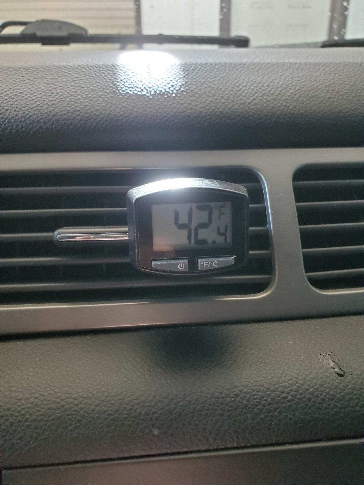

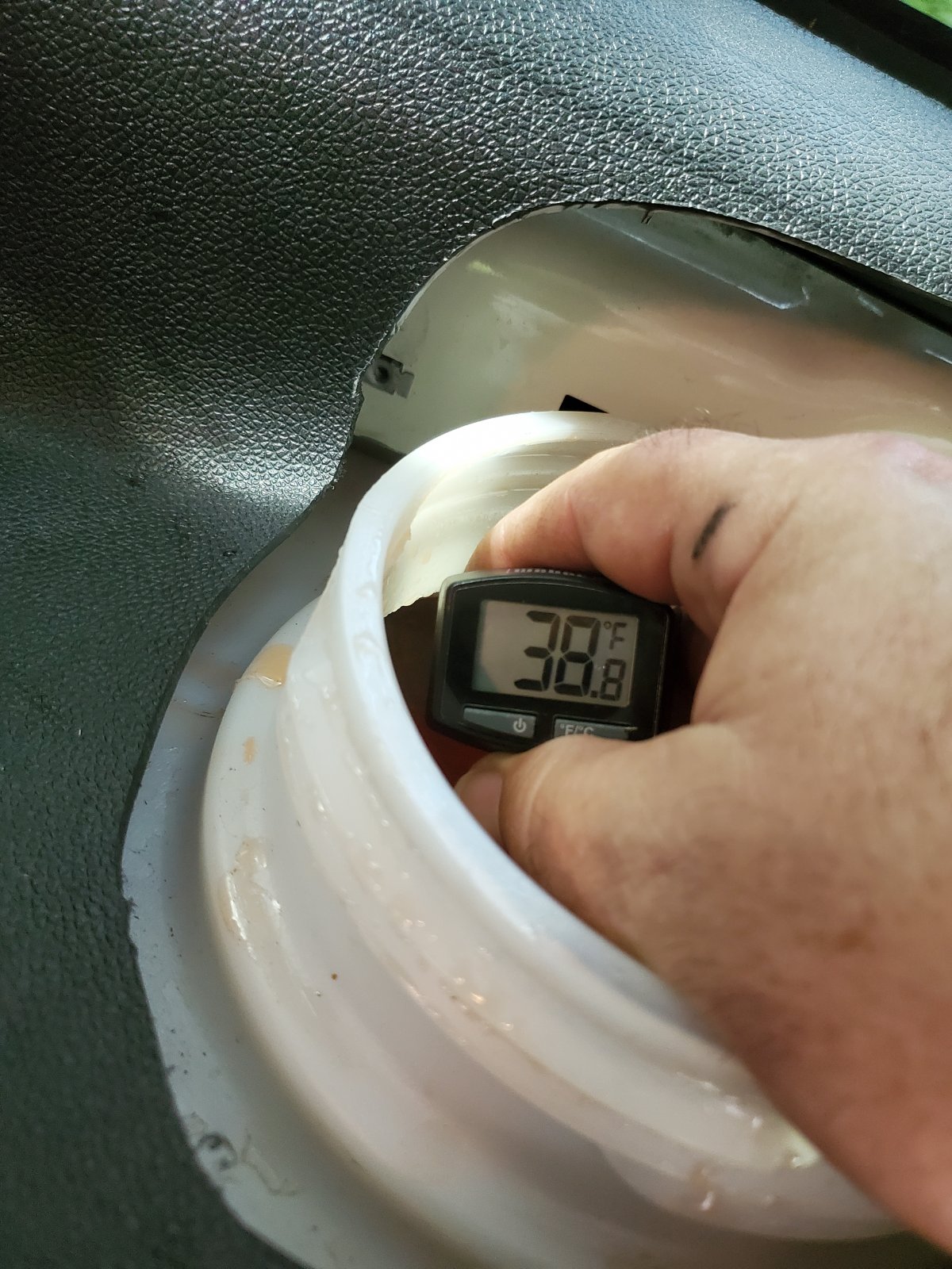

still messing with ac.... after a few test runs, i drove it around till it started with the high discharge pressure crap. brought it back home and hooked the gauges on it then, i "adjusted" the high side pressure then and got it back down in the 260psi range. you can toggle on the compressor with hpt so i did that to keep compressor running, rev'd it up a little, re-adjusted etc.
i cant really turn off the system going to the chiller, it has a thermostatic valve so when it gets cold enough it should close - best i could do, turned off the water flow to it. i was trying to see how much i have of a drop across the condenser (the gauge port is on the cabin ac side and splits to go to the chiller before. the gauge port is way down to like 100psi, when the discharge sensor reads like 150psi. so i dont think that is right. i will prob try replacing the condenser.
with the chiller pump turned off the psi stays like 140-160 temp coming out of the ac vents is low 50s (90* ambient). when you start up the intercooler pump the psi starts to rise and settles around 200psi on the discharge pressure sensor. ac vent rises about 7-8* so i dont know wtf. if i hose down the condenser psi drops back down on the sensor. thinking the condenser might be the prob
Gaining a little confidence with the cooling system, I let it ride with the high pressure and it gets to like 220 before it finally stopped climbing.

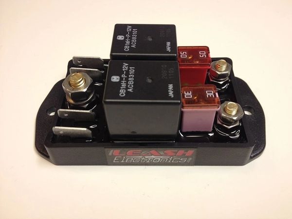

i made up a dual fuel pump relay deal, kinda sloppy though...leash electronics makes a nice, compact dual 70amp relay board, potted, incorporates jcase fuses, single large feed etc all in one deal. should work for new pump also and should clean up that wiring a lot.
That looks like a nice little relay setup I'll have to check out their site. I'm always into cleaning up wiring, maybe they have something I can use.
they have some nice relay boards, i knew they made boost controllers but never really looked at their site - diff forum someone posted a single relay board of theirs and i was like man a dual relay like that would kickass. and there it is, on their website :emotions122:
i like them and the ARC (auto rod controls) relay boards. im still going to end up needing one with 4 or 6 relays probably. ill see how the leash feels when ive got it in hand
