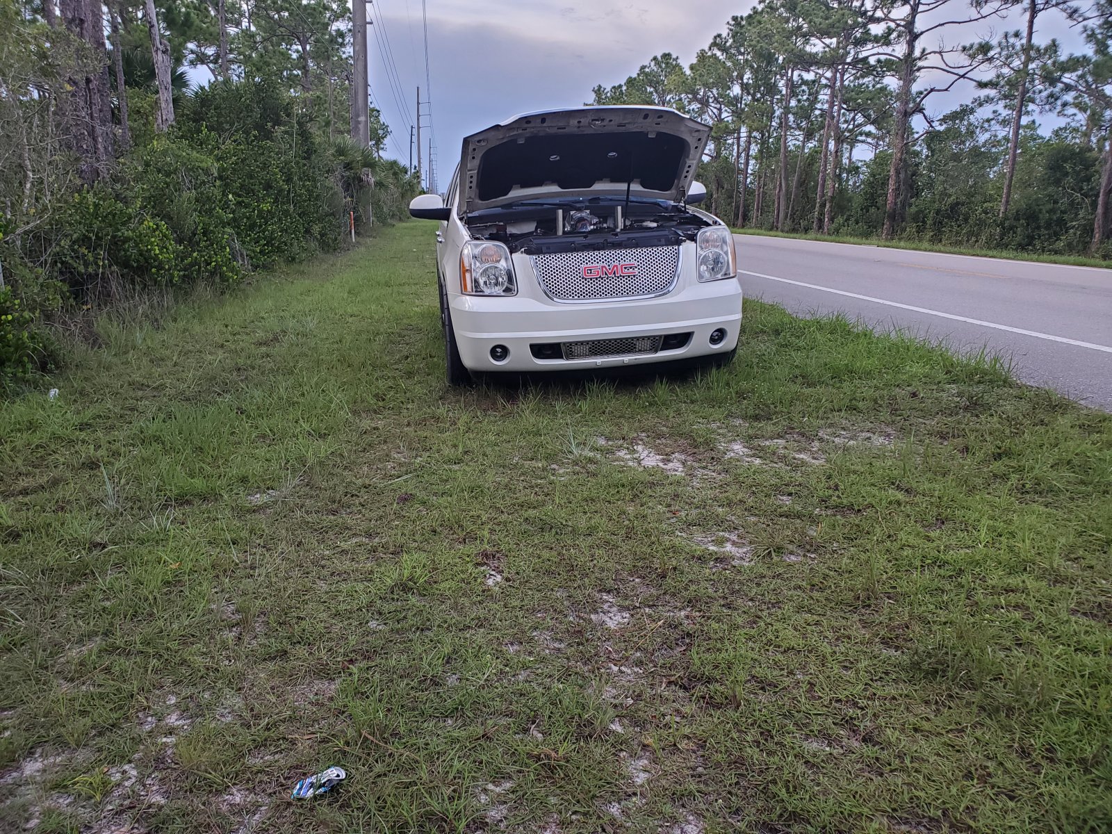

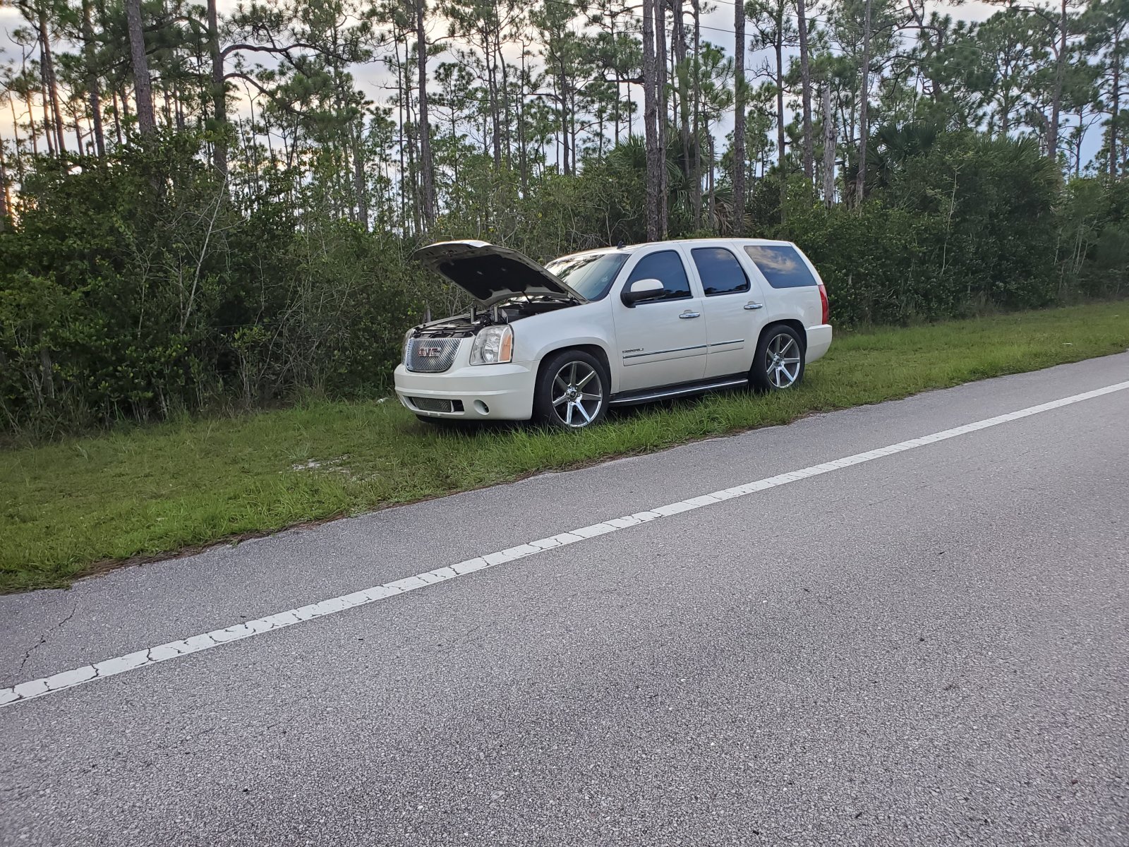

Guessing trans input or output shaft
Top of 2nd gear, not even really into it and it just donkd like it "jumped out" of gear into neutral. Nothing in any gear now
If I'm lucky maybe the tcase? I gotta start by pulling it out anyway. But I hear nothing grinding or anything so whatever broke is clean

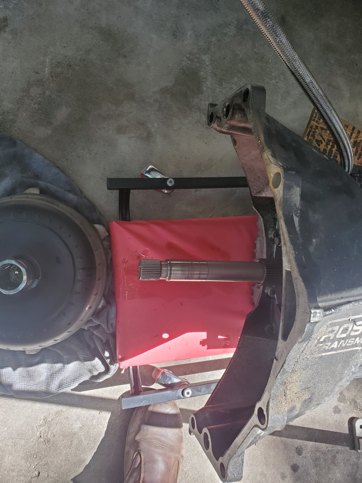

parking pawl still engages trying to roll it in park (not output shaft)...so probably input shaft broke or bolts on the converter?!?! really doubtful

Six broken converter bolts on a second gear pull? You're gonna need a bigger Rossler.
Looking forward to snapped shaft garage art.
dont tell anyone - but im only using three
the converter i have is dual pattern(3x whatever and 3x whatever), and so is my flex plate...but the pattern on the second set is different. so theres a slim chance its that
I have zero bad to say about rossler, just the shipping sucks. there's a place down here called ATF Speed that is pretty popular, i may talk to them and see if they want to **** with it (being someone elses build). had i know about them when i first did it i prob would have gave them a shot

Same on my FTI billet triple disc, and I talked to them about it. iirc they said the 3 bolts are good to well over 1000 hp but you’re past that. TCI flex plate or whose are you running?

OOOOoooh. I remember seeing a pic with the converter chillin in the bellhousing and just thought it used six bolts to hold the high horsepower. My bad, bruh.
Regardless, I hope it's nothing major.
