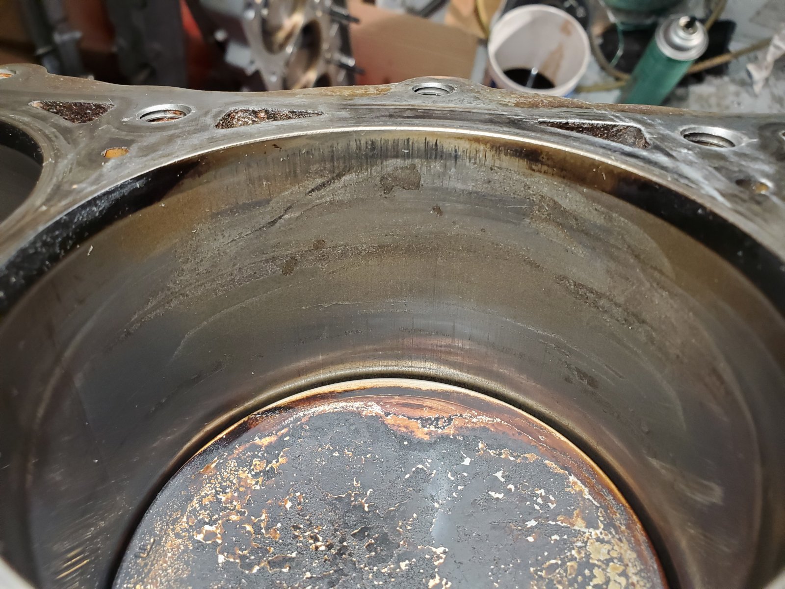

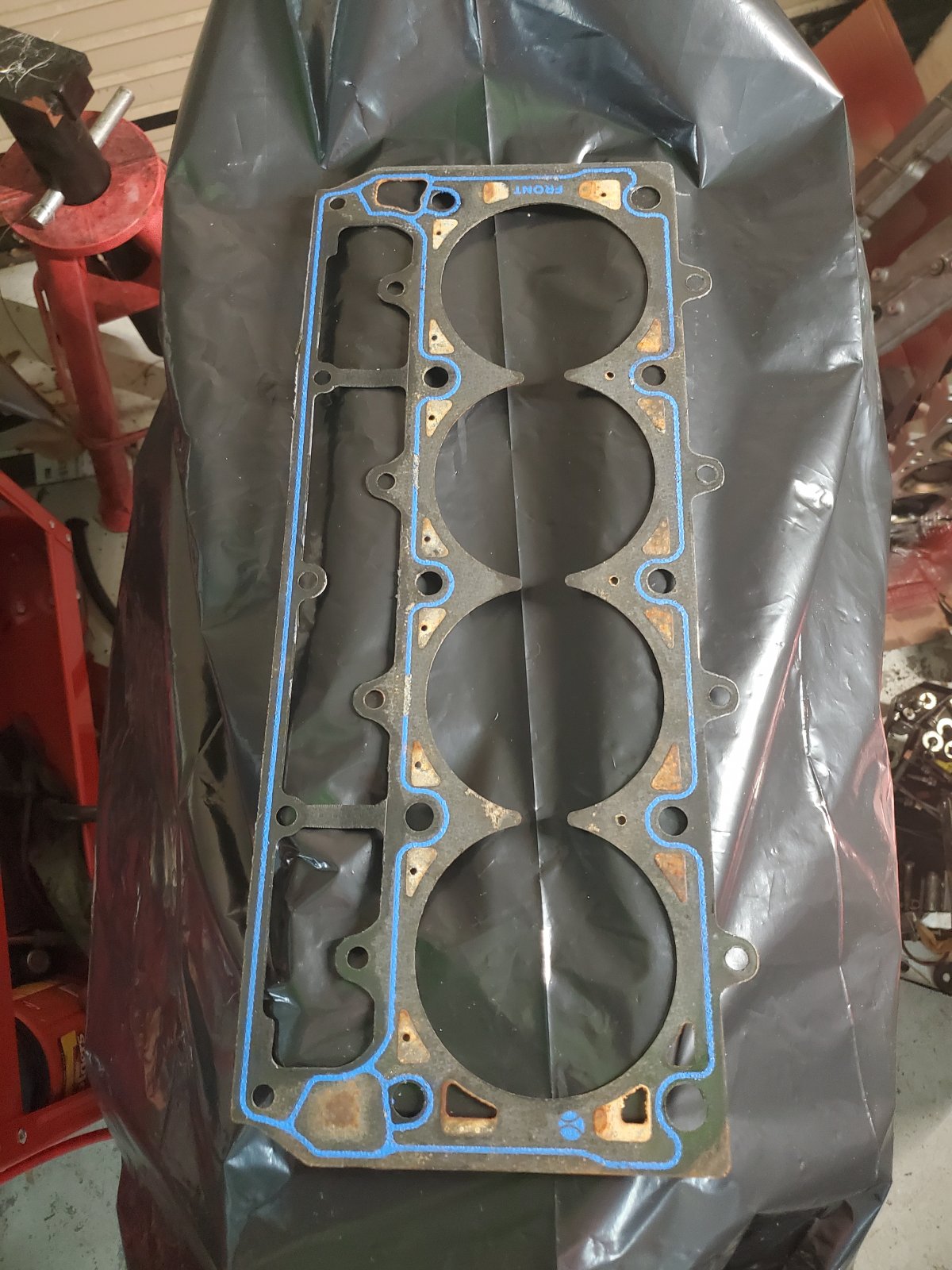

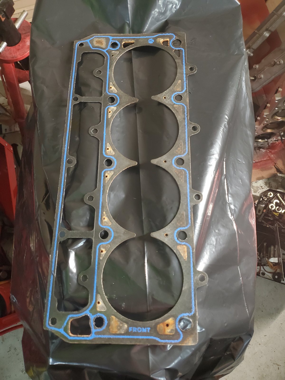

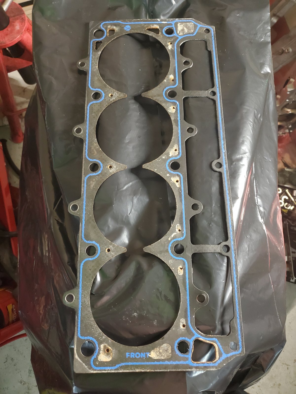

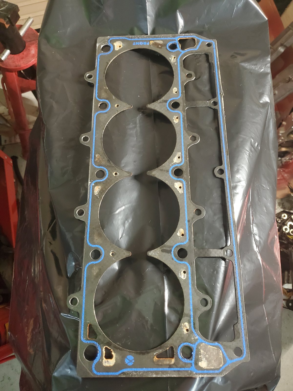

Stumped fellas...I've looked over both of the headgaskets and they look perfect, all the water ports are indented and compressed around the openings no signs of water creeping.

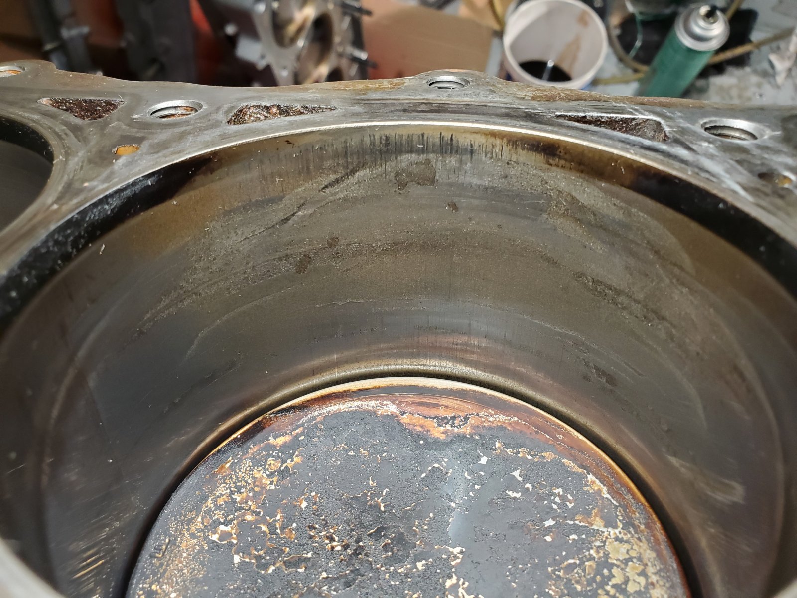

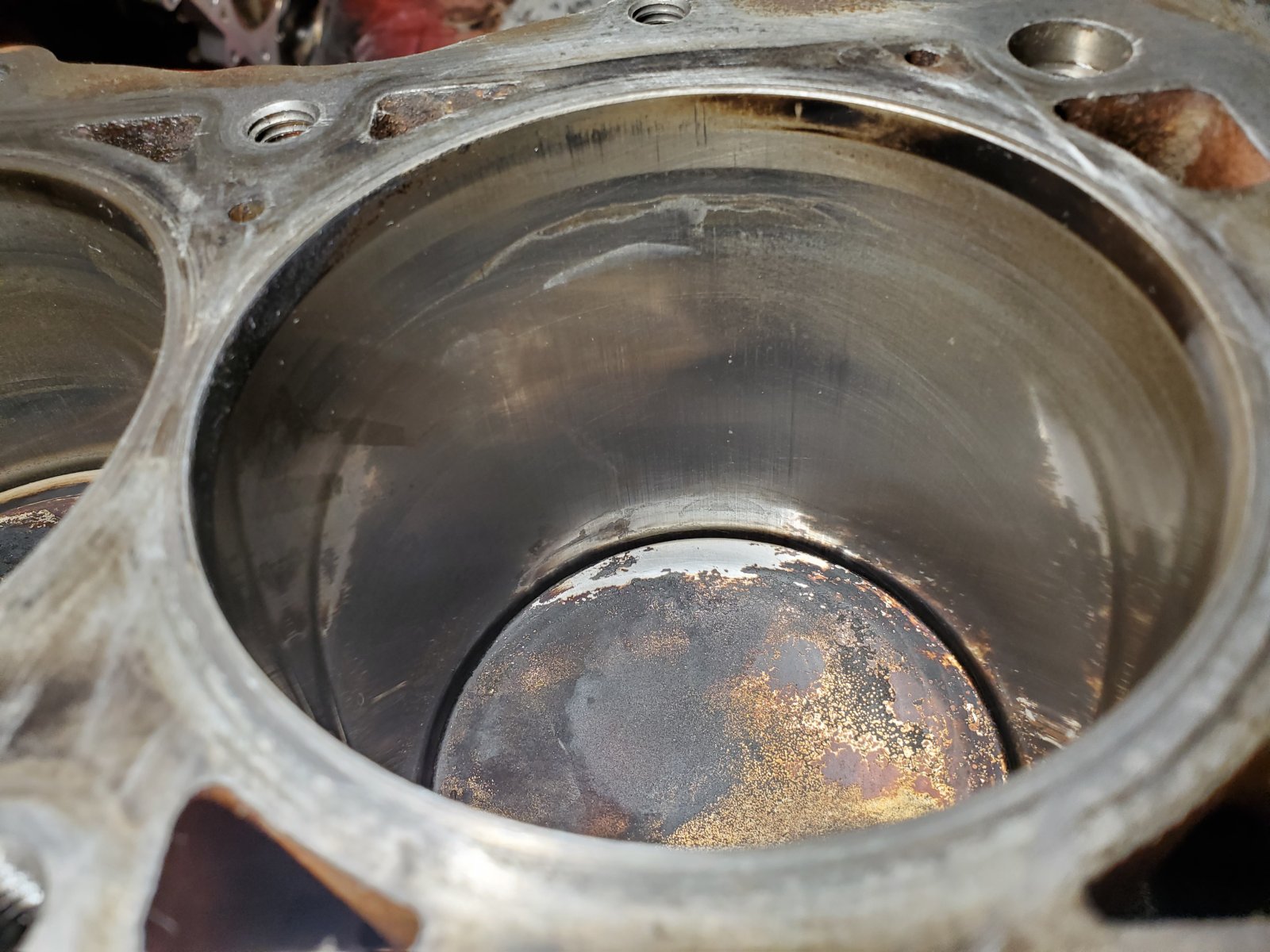

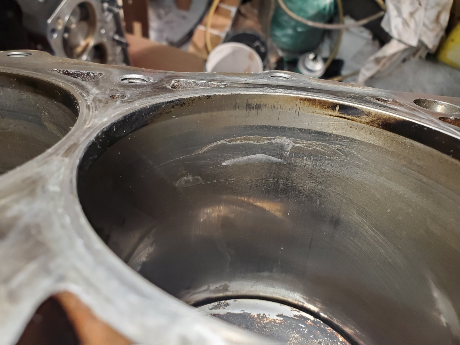

There's a couple spots in the back cylinders 6+8 all the way at the top into the rings.. not sure if just stains or debris riding the rings while it's been parked for one of the many breakages.
Order some penetrating dye and developer, guess I'm going to mask everything off and hit the one spot atleast to see if it is a crack. Tried filling the water jacket up and letting it sit for a day but nothing leaked in- may just open up with heat/pressure tho

Did the water situation ever remedy itself on the last combo? I remember you having problems but I can't remember the solution. Doesn't look like its lifting the heads and everything looks good to me. The staining in the cylinder wall does look odd but nothing jumps out as "broken". Heads look good?

Nah that's why I'm ****** with engine again...I've blamed it on headgaskets but don't know anymore...I've done head gaskets more than a dozen times and never had this many probs

i'll take some pics of the heads, they were freshly resurfaced so no existing stains. you can see where the fire ring dug into them around the chambers a little close. but if coolant couldnt get to any one them i dont see how the gasket could have failed
dont know about this penetrating dye either.... i mean there is something there you can faintly feel it dragging a fingernail across it so dye will definitely sit in it anyway. after i throw the head on it i can try and put about 200psi on the cylinder thru the leak down tester and see if any bubbles make it into the water jacket - but thats prob still no where close to the pressure the cylinder makes running so it may not be enough
