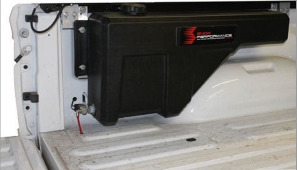

i'm going to try to stuff one of these behind the trim panels on one side or the other.
i dont have any of the jack crap on the driverside, and i may just completely remove the rear ac stuff from the other side
except im just going to use it as a2w tank, by just doin a quick measurement it seems like itll work if i gut everything from behind the panel, keeping it hidden would be sweet
There ya go. You already disconnected the rear hvac so might as well remove the components. The truck is ruined anyway.:rolleyes:

that meth tank i ordered looked like it was gonna be a few weeks out according to summit, but it was shipped today so i'll prob get to pulling out those trim pieces and see if itll work (or what i need to do to make it work). removing the stock refrigerant and coolant lines for the rear hvac i need to pull the running board, rear tire/liner and should come out pretty easy. going to be running 16an lines all the way to the front should nice and $$$. ive seen people use like a clear nylon reinforced 1"+ hose which is cheaper but not sure if itll sweat and drip...the braided rubber hose doesnt sweat so if thats what it needs i'll have to suck it up
