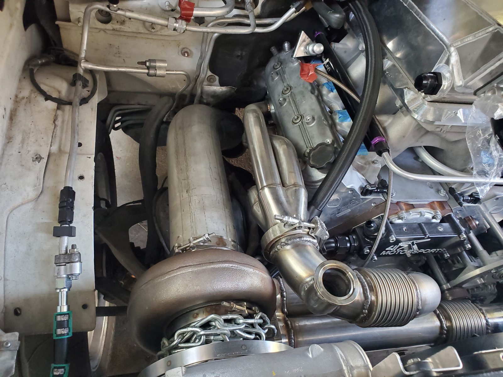

so it kinda worked out ok with the 45*, i cut it down a little bit but its still real close to the firewall and the bend is turned just a hair to keep it off the frame rail. if i cut it any shorter, it hits the frame sooner(cause frame rises there) and i get even less angle out of it. about 10* more degree of bend prob would have been ideal, but gotta work with what i got. thought about cutting a wedge out of it moving closer to the header , that would have let me turn it down even more - but that would get in the way of doing plugs/wires, and have an ugly weld right on top.
ive got another 45 and a couple feet of straight pipe, i cut the 45 down to right after the bend. gotta get it up the in air to see if i can get the exhaust turned under the truck. whatever funky ugly pie cuts i need to do will atleast be way down in that hole. prob not going to carry the 5" very far cause the 4" there now barely fit

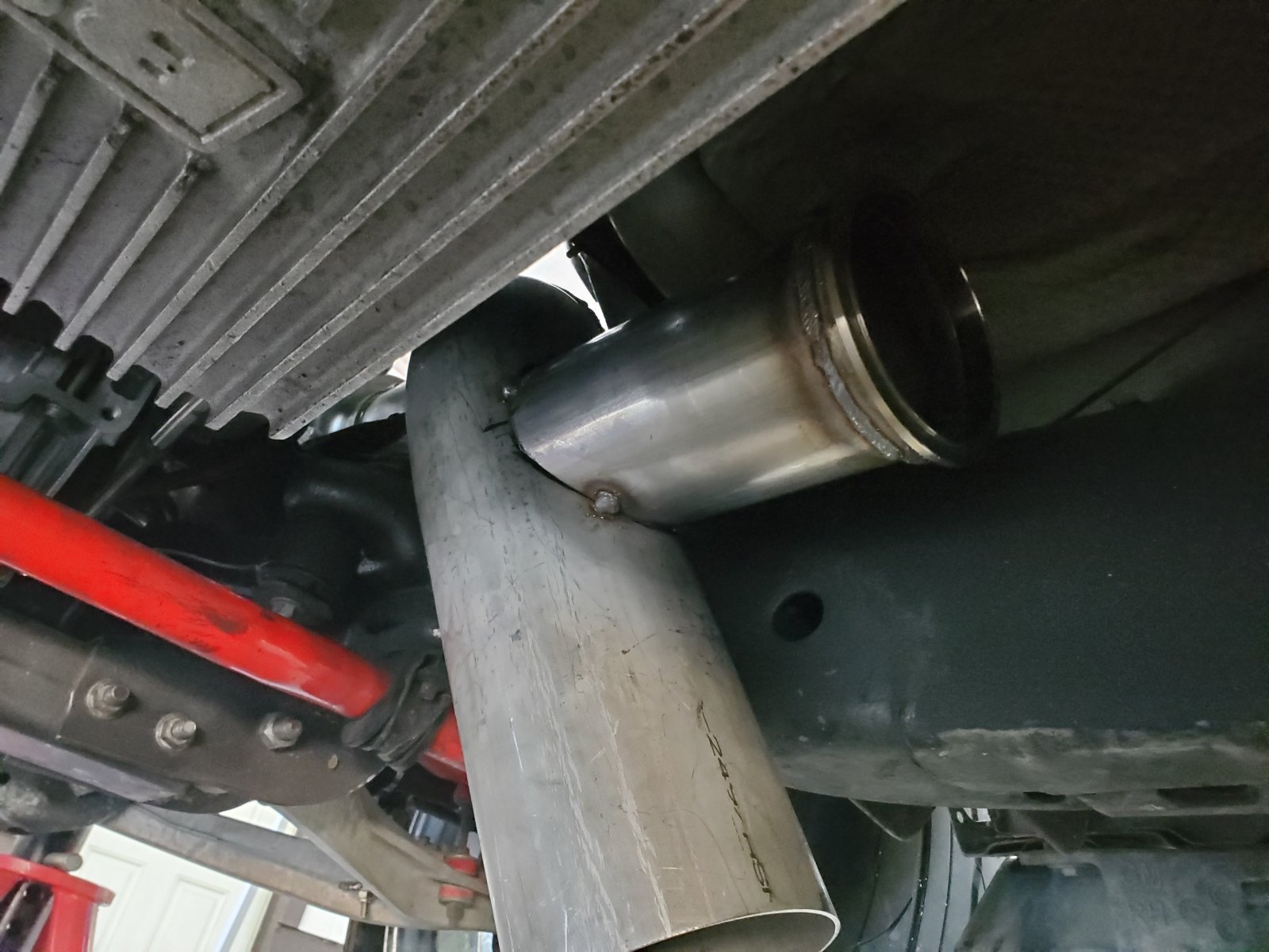

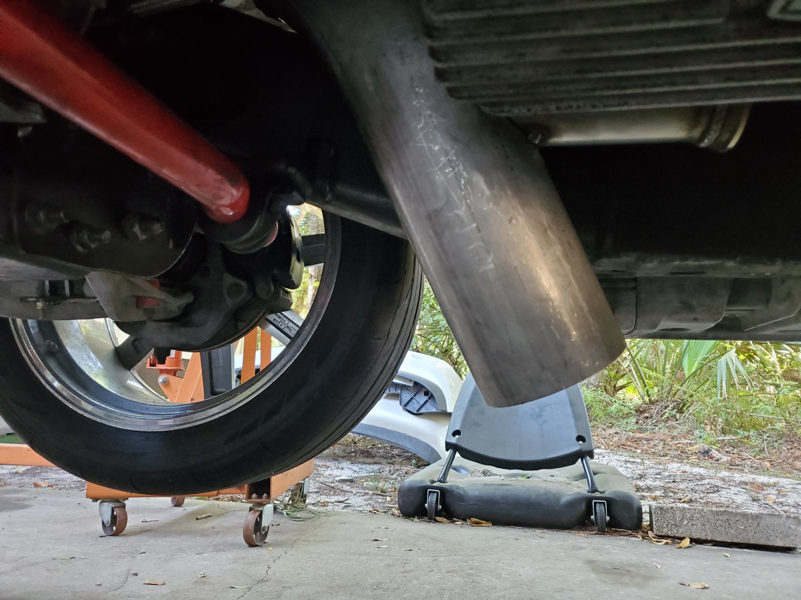

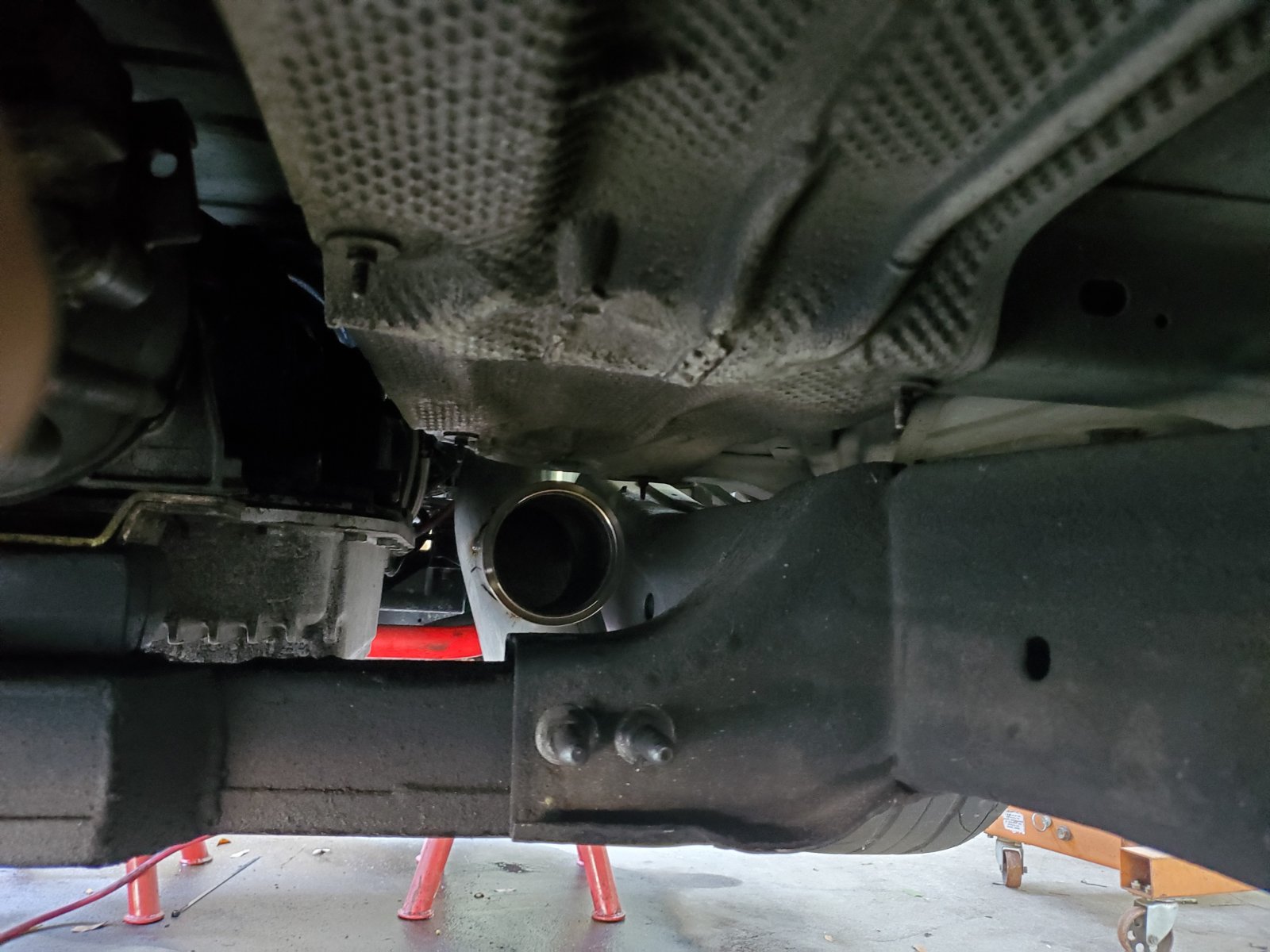

downpipe is done? sort of, welded a little tab not so much to support but to locate it. and welded the o2 bung in it. out of the engine bay and dumped at the moment, it hangs maybe an inch below the side steps - i'll need to cut it a little shorter but just wanted to see what i ended up with. so its still kinda angled down...im just going to holesaw a 4" into it and connect it back to the rest of my 4" exhaust, and QTP does make a 5" cutout i will hopefully be able to put on the straight down 5" piece..
uhh itll look like this pretty much:
5"> \\==== <4"
didnt weld bung into the headers for narrow bands yet.... i may just tune it off the wideband completely and ignore the stock o2s
and i need to cut down one of the studs on the shock mount cause its kinda close to the downpipe

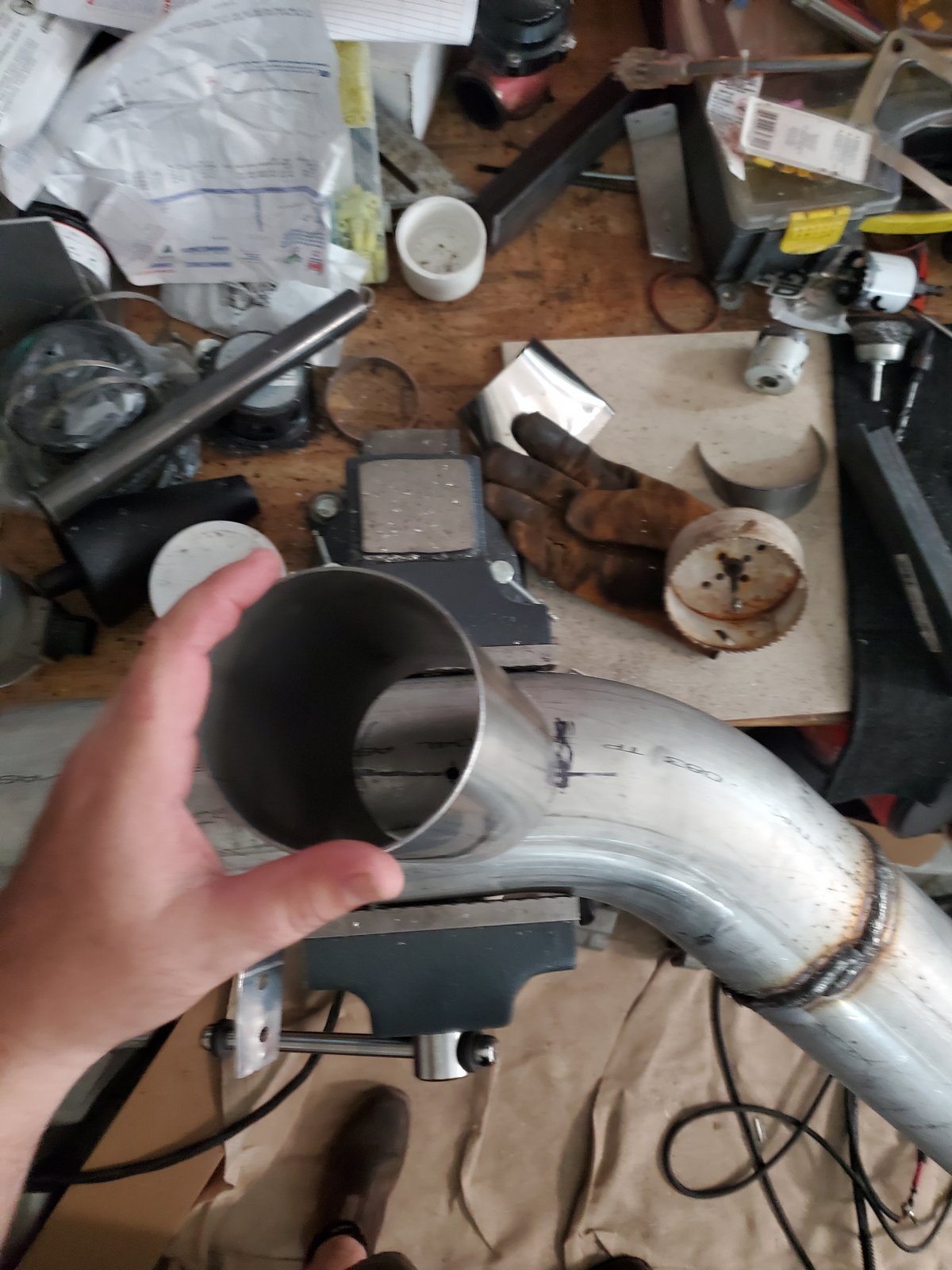

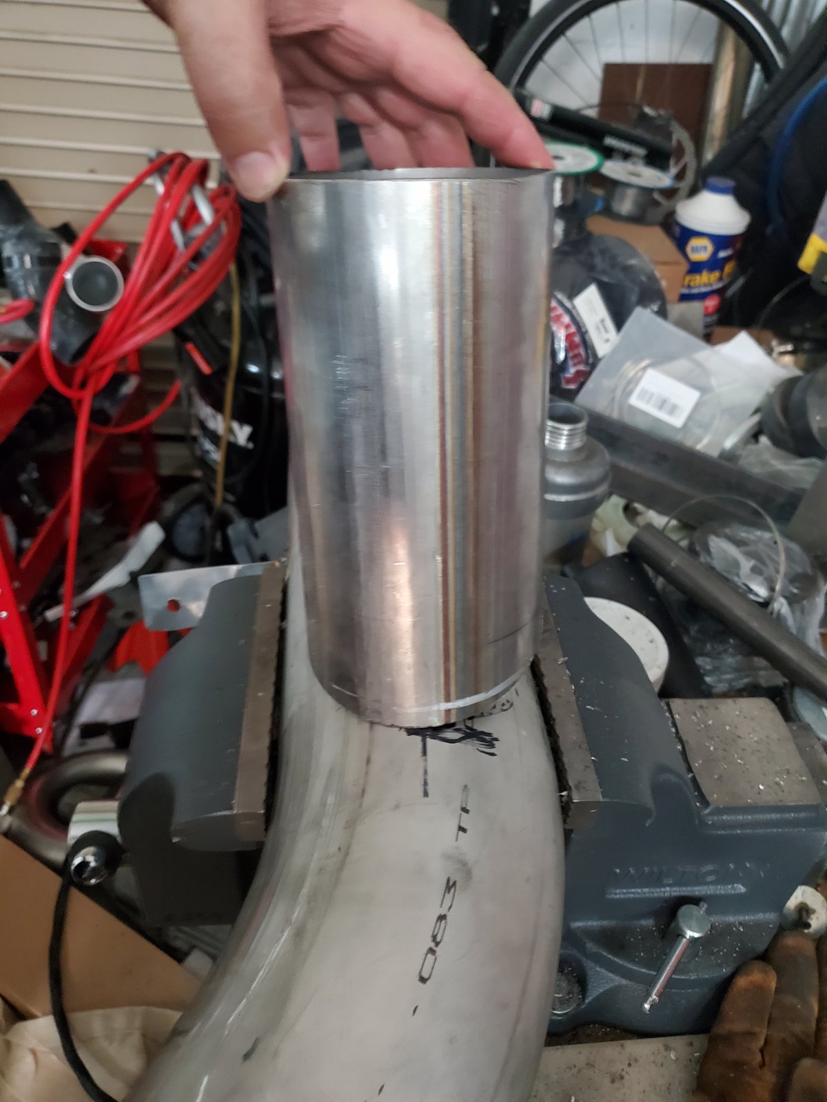

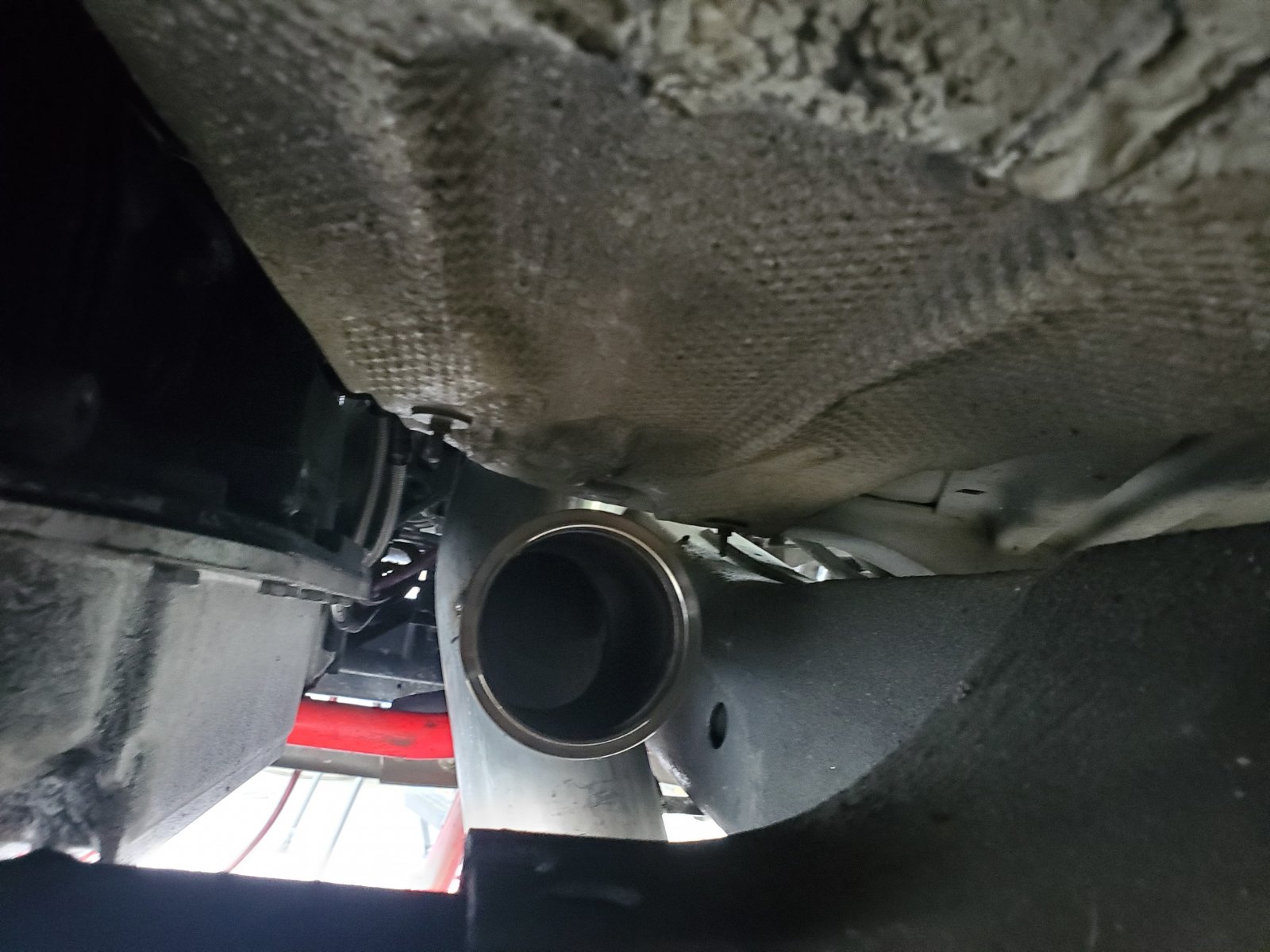

i started by putting the vband flange on the 4' first...got all set up, the pipe usually isnt perfectly round (compared to the vband) so i gotta mush it in the vice to get it into there. got it all ready to go, layed down the first little stitch/tack anddddd forgot to turn the gas on lol. it welded ok and only hit it about 1/2" before i was like wtf is wrong with this thing. but the rest of it actually came out really good. a lot of slag/bb's tho i forget what causes it every once and a while but it came out pretty good.

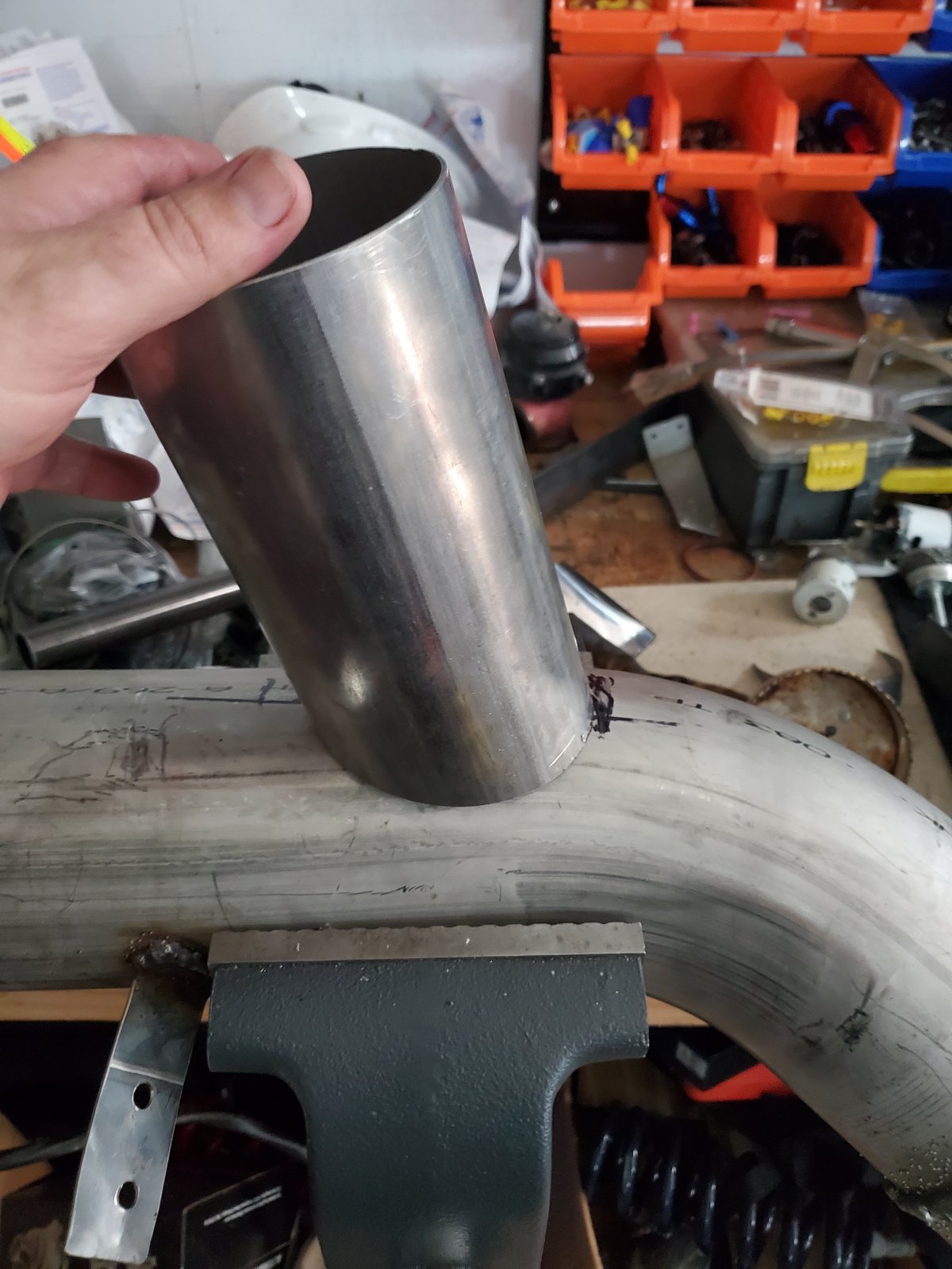

then worked on getting the 4" into the 5". tried to cut it out in one shot with an old hole saw got about half way thru it but it just didnt want to cut anymore. i was just determined to make it happen so i finished it up with the grinder. downpipe back in the truck to tack it up (dp was in and out about 10 times to day) its still all one piece and has to go in from the bottom. i have a vband i planned on putting somewhere - preferably where i can remove a big chunk of it from the top without having to crawl under it if i want to work on anything . but anyway connecting the 4 inch, i put it up there lined it up, took it down trimmed a little more, test fit, remove, trim, till i finally said **** it and layed some big nasty beads down on there lol. lines up pretty good, shouldnt be bad to reconnect to the rest of the exhaust i already have

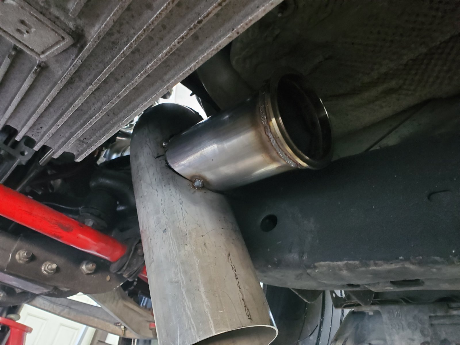

finished up tying the exhaust back into what i already had there. wasnt really a straight shot from the vband i put on the 5" but wasnt too bad, just had to make a little kick to keep it off the transmission crossmemeber. will be waiting on the 5" flange for the cutout.
