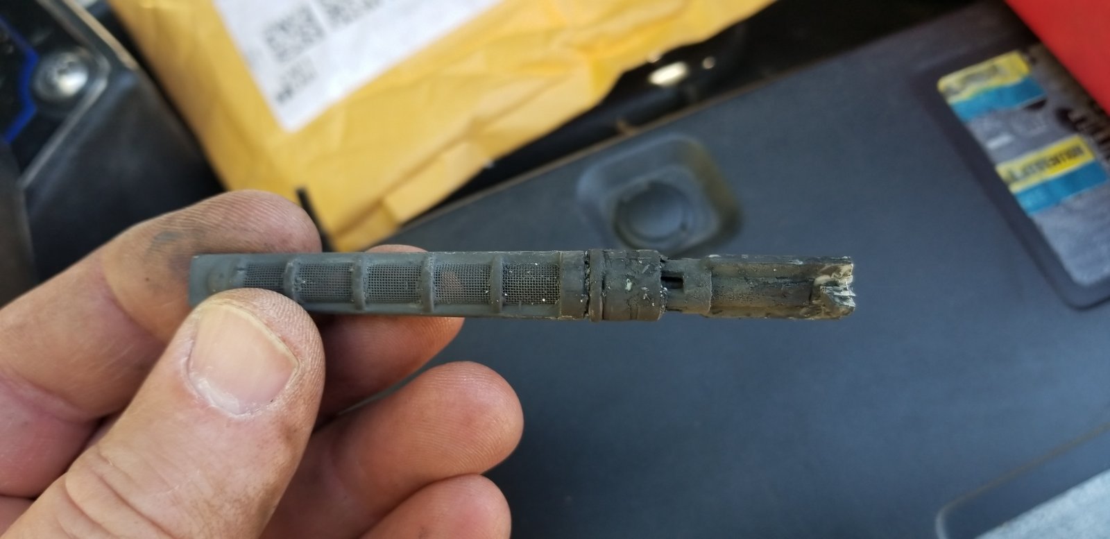

Orifice tube sposed to look like that :eek:
I thought that it was just a plastic cage? I'm wondering if it melted and just collapsed in on itself

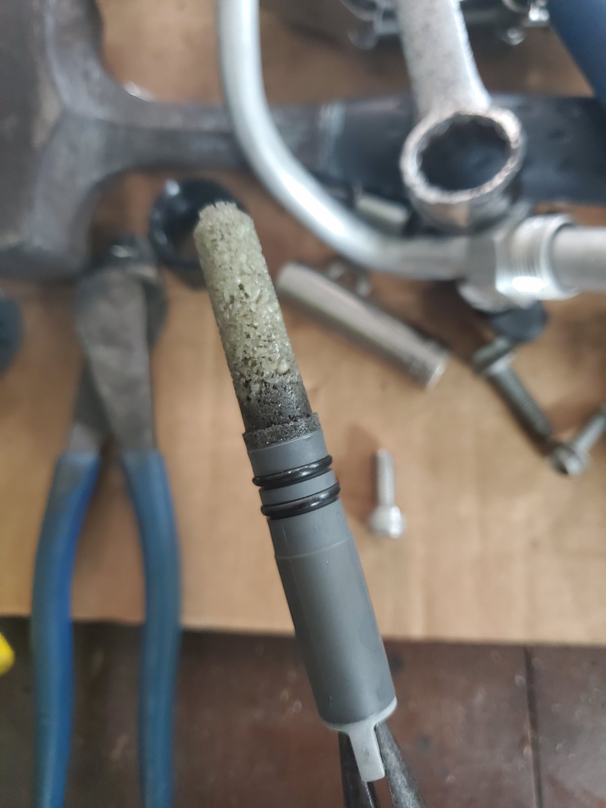

I'm not a pro in the ac department but I don't see what would be special about them, other than flow/volume like you said. I thought they were just filled with the silica beads to dry the air, hence the reason you never leave them open if you have it off the vehicle. I put a used one on a camaro a long time ago. It froze and blew Freon/oil all over the engine bay.

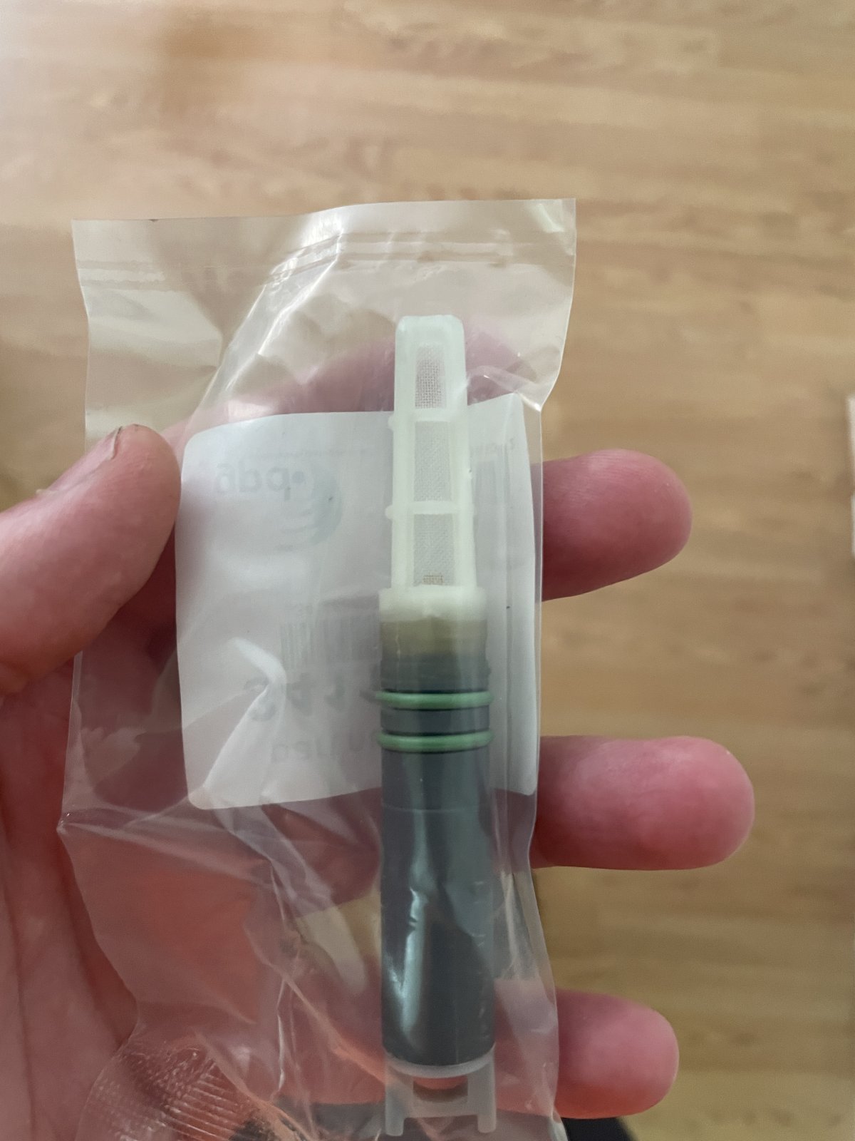

as for the orifice tube, just looks partially clogged and needs replaced? Here's a new one I bought for the avalanche but haven't installed

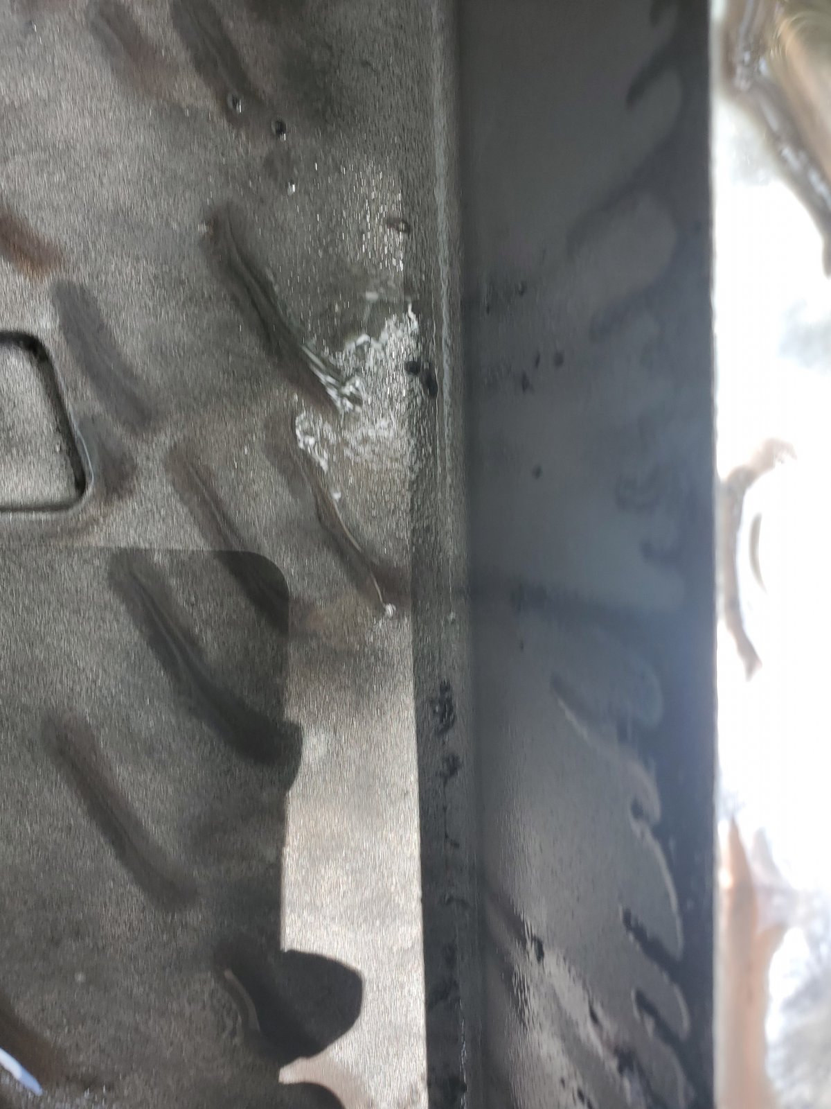

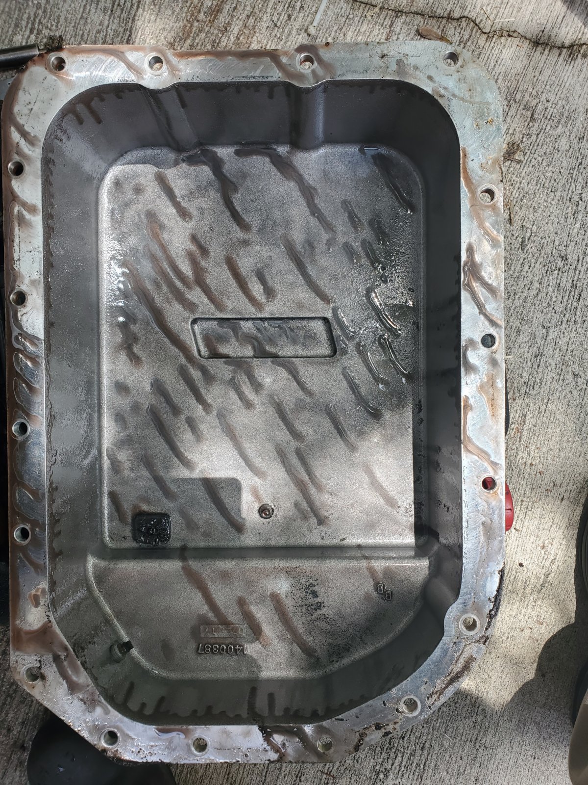

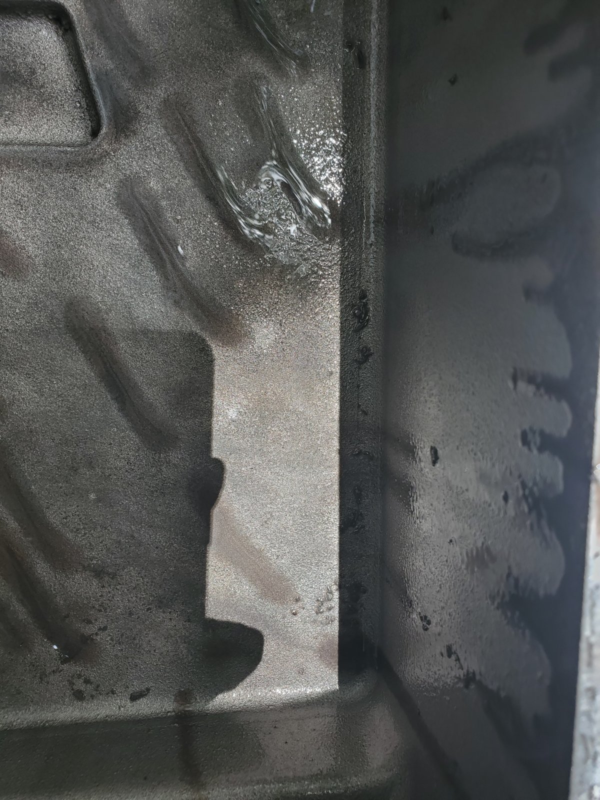

Little bit of overreaction on the trans...was pretty clean lol
The small bits that came out were like pinky nail sized if that makes sense. I assumed there were larger peices that couldn't make it out the drain hole. even the magnet isnt as bad as i thought, those little black crusties are about the extent of it...all i did was let the fluid drain before those pics. cleaned it all up, new filter, verified the dip stick full mark was at the pan rail and put 12 qts back in it

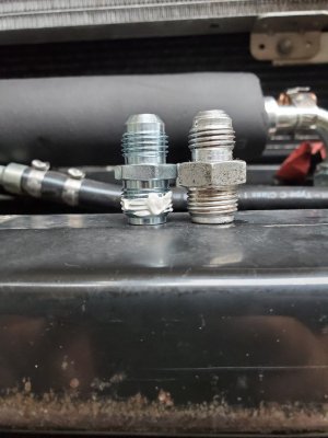

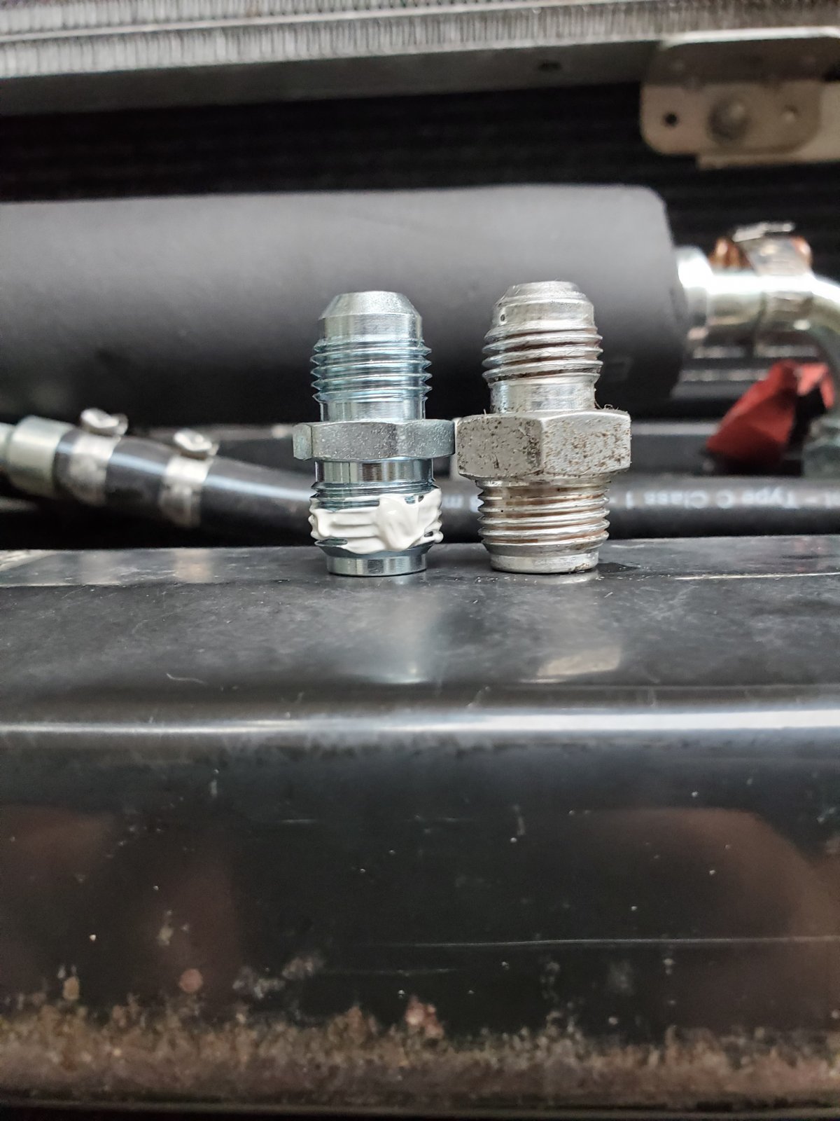

Swapped fitting into the 40k...they've always weeped a little, apparently the fittings I had bottom out before the flare engages tight enough. The flare should engage on these fittings but I put some thread sealer on it anyway

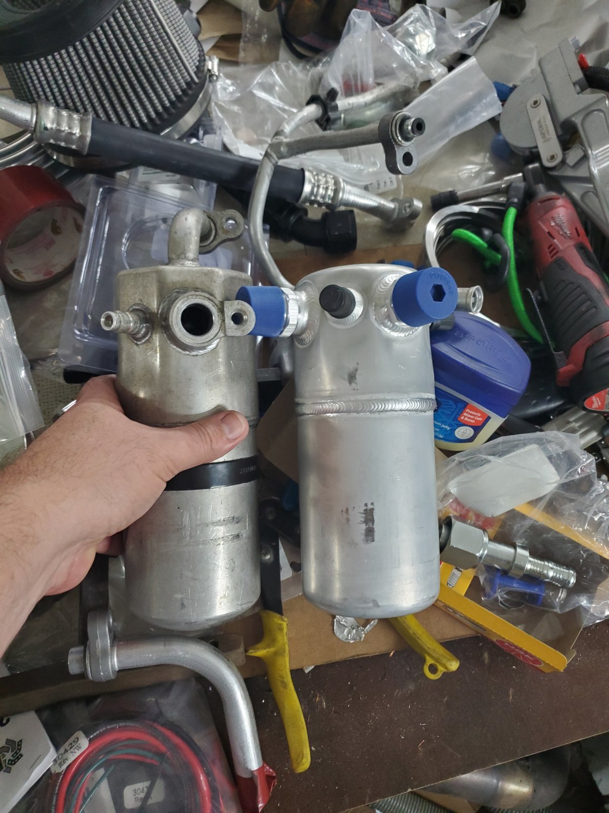

And the other drier/accumulator came
