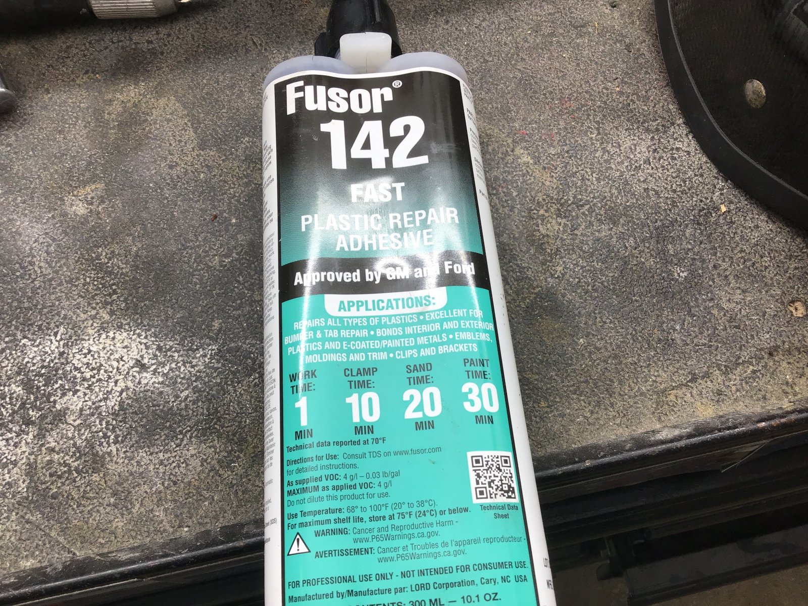

sectioned out that chunk, melted it back together but has a couple pin hole leaks I need to fix.
Heated up the whole side that goes over the tire and caved it in so it would round the wheel well. Had to bend some metal at the c pillar that was forward to the side, grind down some self taping screws on some crap that was mounted behind the tail light into the space.
Oh I see it now. I was on my phone and couldn’t see it too good. You could use some plastic epoxy on the pinholes.3M Panel Bond or what I use is Fusor 142, ***** the bomb for working with plastic. I used it to to cut my Harley fairings apart and section them when I raked the bike for a 26” front wheel. The gun is expensive but you can just use a couple sticks to push the same amount out the ends and mix it by hand for small projects.

Haven't given up on heatgun/torch and flat blade...started out with just like 2 or 3 pin holes that I tried to touch up...after I heated up filler it just turned crunchy and had to break it all off, didn't bond worth a shit. I'm back to a couple pin holes

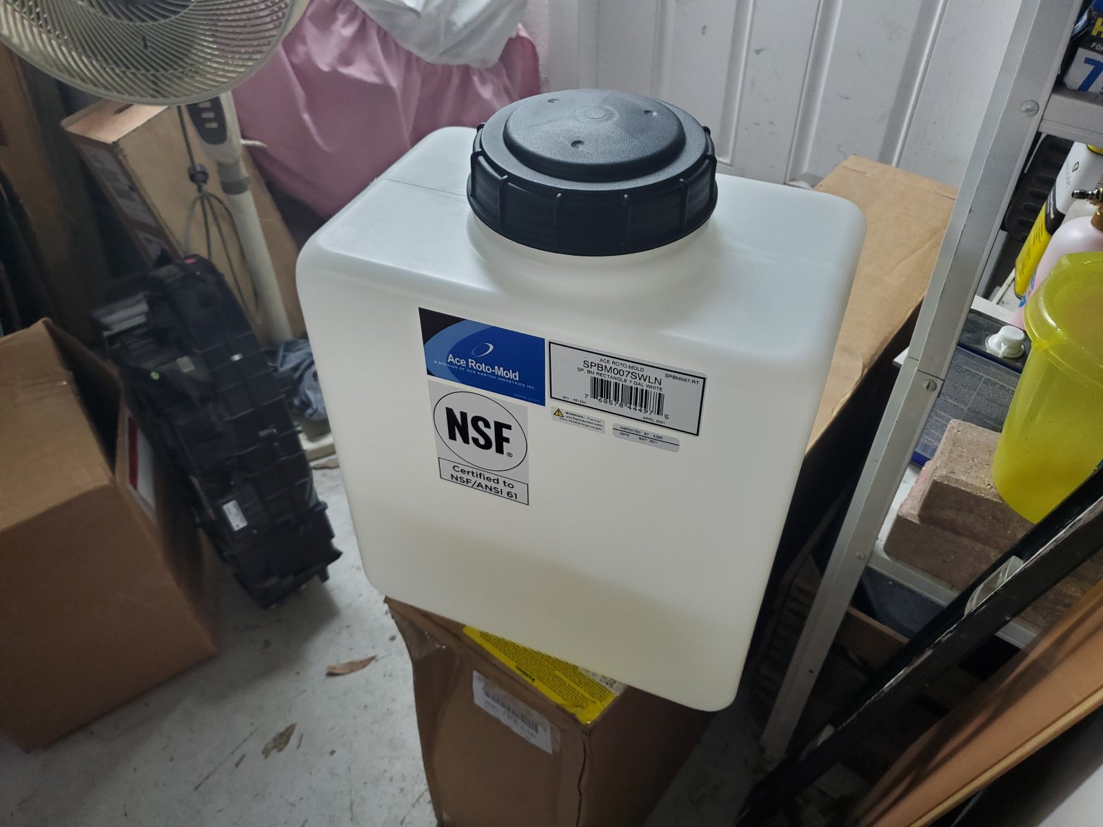

different tank should be here tomorrow, i'm going to set it up with bulk head fittings at the cab so if i need to disconnect it i dont have to rip that half of the interior back apart. and it will just connect at the body. so i grabbed most of the fittings i needed to make that happen. kind of annoyed with this thru hull fitting i got it's for a boat bilge pump to pump water out the side of a boat... i assumed it would come with a goddamn gasket, of course not - so i had to figure out what i needed and order a few different ones to see what works.
new tank is like 7-8 gallons i think, it should fit pretty snug but im still going to need to make a couple quick mounts out of angle or whatever, but i got most of that here. with the tank, intercooler and 20+ feet of 16an hose should have over 9 gallons of cold water capacity.

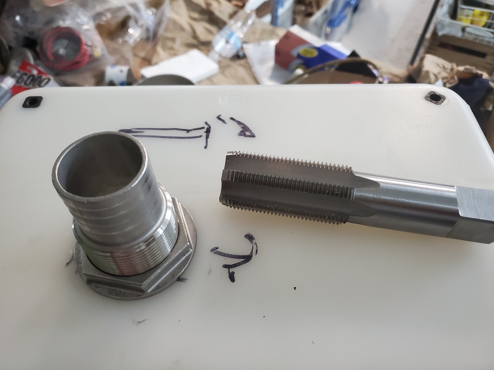

16an, 1" hose.... which reminds me - amazon gone to hell lately too. i ordered a 1-5/16 12tpi tap to run some threads into this intercooler pump i want to use with the AN hose fittings. was like 19bux, surprised cheap cool. charges me, returns money and the order is still sitting there waiting to be shipped. go back to the tap and price has gone up to like 80 bux :oops:. so guessing they arent shipping meit for 20 bux. so i just ordered a 1" NPT tap and the fitting to converter that to 16an fittings,

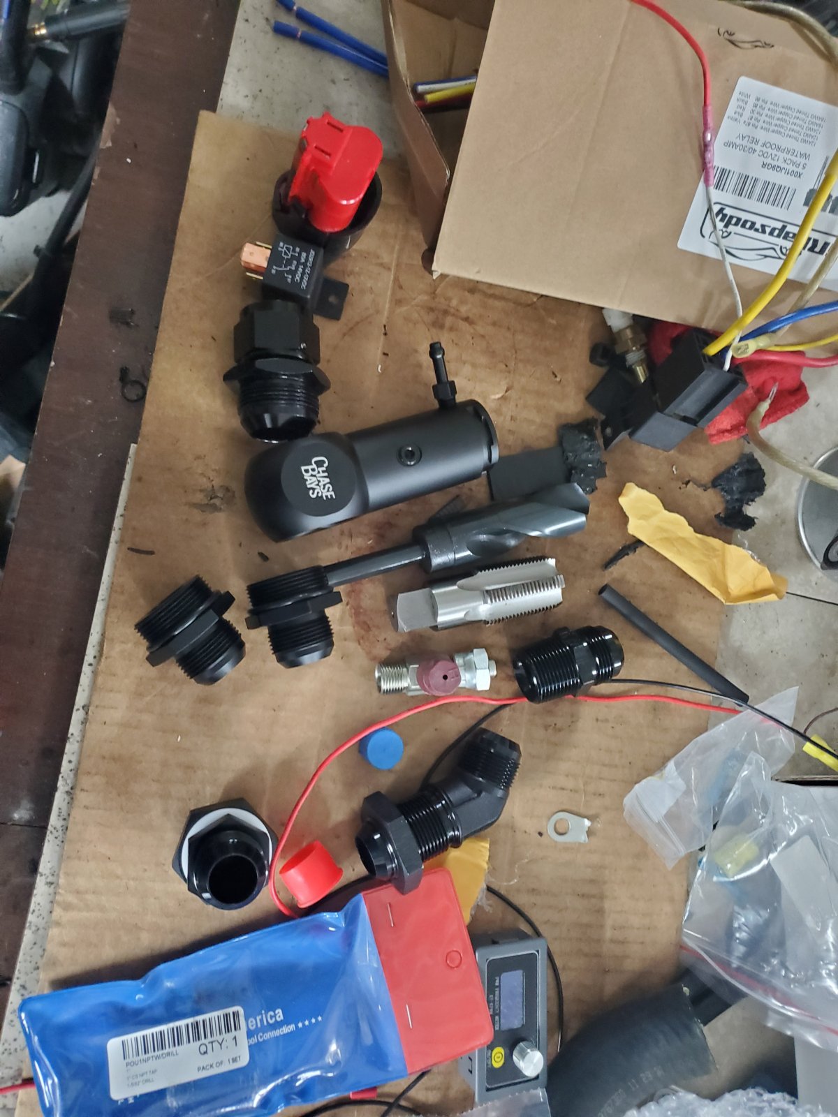

About 10 individual deliveries today...
Inline fill neck, had to buy a 20an×16an weird fitting was like 60 bux, but will allow me to mount a little closer that using two males and a union between them.
Some 16an bulk head fittings, 1"npt tap and npt to an fitting, diff tank

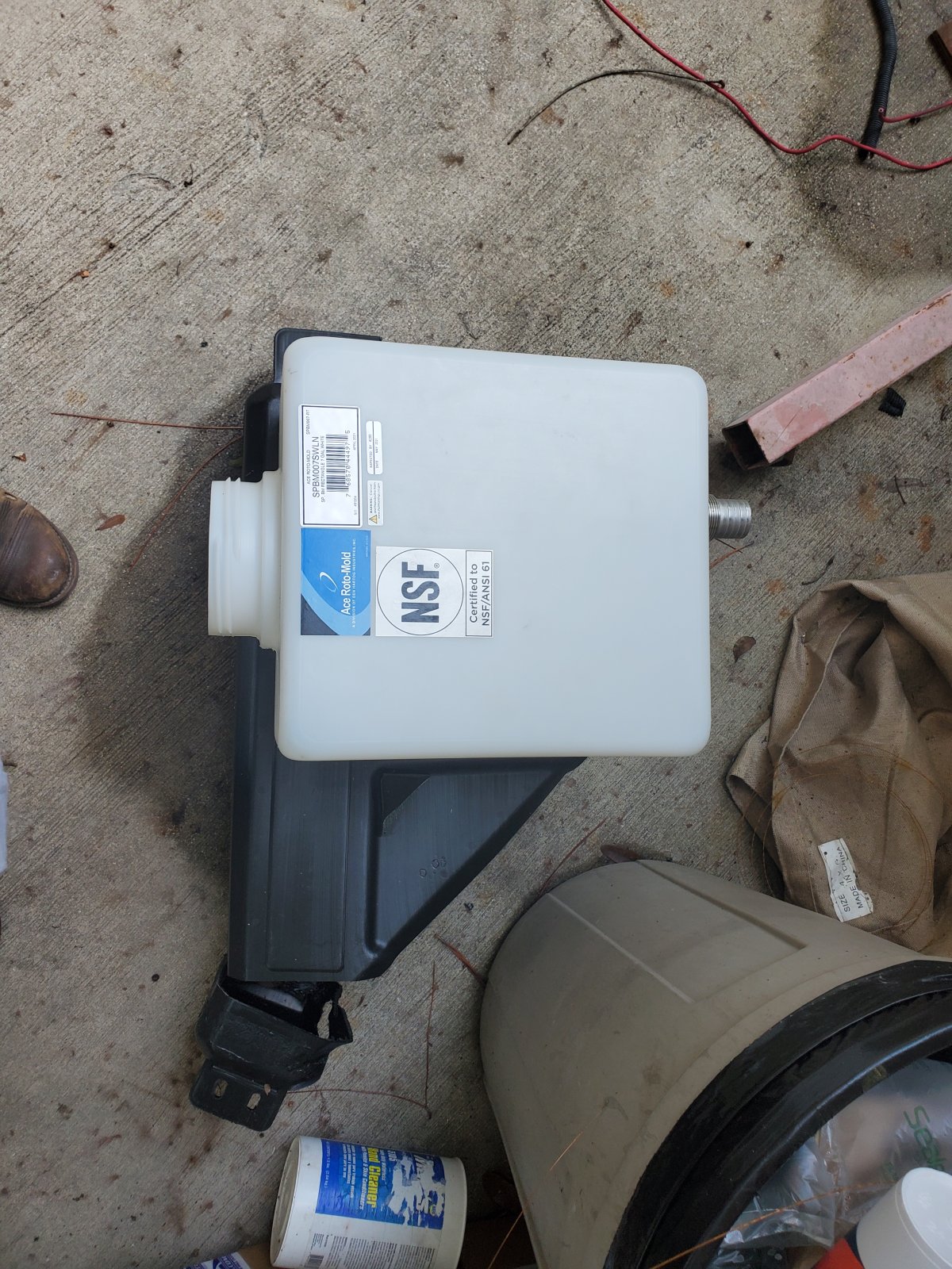

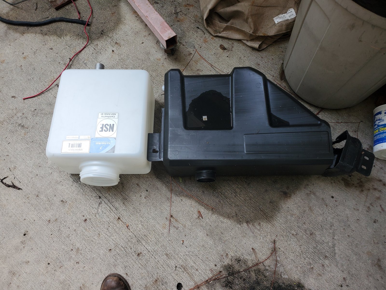

That tank fits without modifying it? Looks way smaller.
it is a few gallows less 10>7, but i probably cut and mangled the other one down to 8-8.5 just to make it fit anyway.
i'll set it next to the other one tonight to compare just for you
i did a little bit of trimming to the inner skins to tuck it in tight, need to make up a few easy straps to hold it behind the trim
