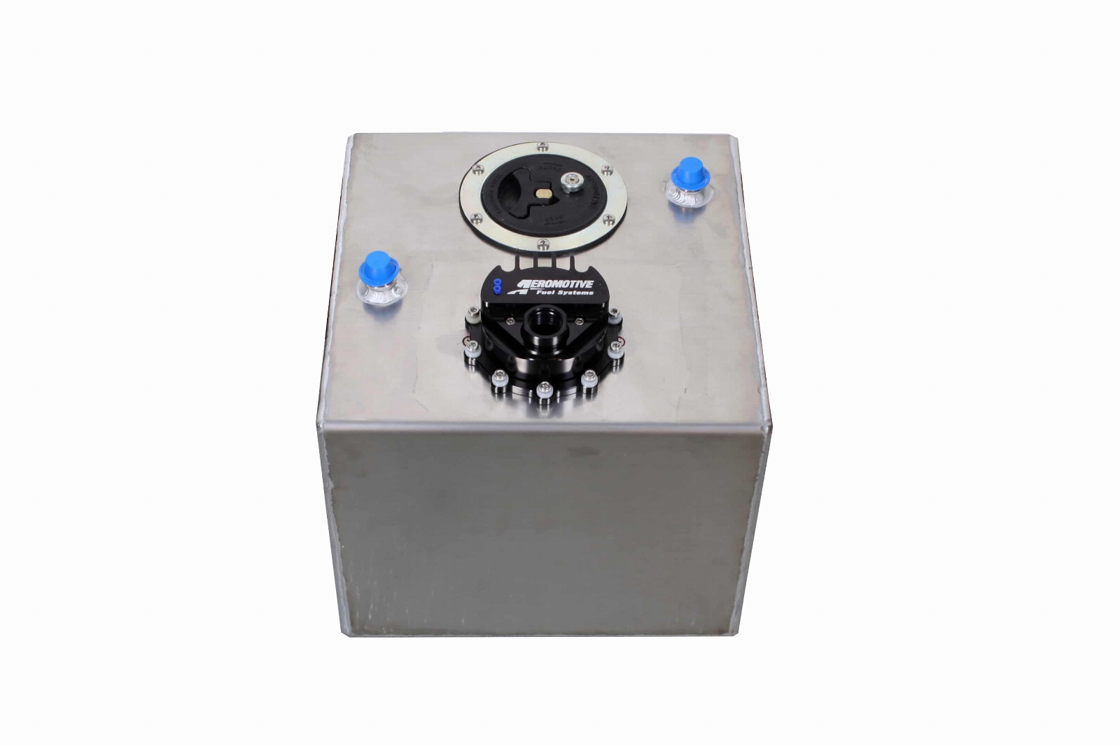

you prob aint gonna like my idea.... but this is why i canceled the order for the 7gpm pump a while back.
they sell a 6 gallon fuel cell with the pump already set up, feed, return, vent. i think its right about 12x12x12, put behind axle (no spare tire)
it would need to have a bung welded on for the feed from stock tank
use the vent bung as the overflow back to the stock tank if there isnt some kind of a float built into it or just weld another bung.
delete the fuel fill door, i dont think just leaving it closed all the time would work for me.
I do like that idea, having a ready to go sump tank with a built-in pump makes it easier rather than cobble together something. Intrigued to see how you mount it. I had considered just mounting it in the bed directly above the tank and building a small protective box around it.
All this bung talk is getting me excited....
That tank seems like what you need. Its nice to be able to buy a complete package like that. Hopefully that takes care of the fueling issues.

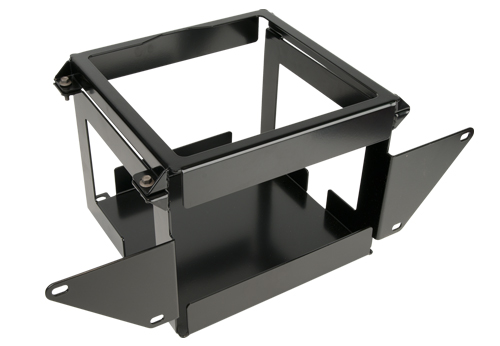

yea in a truck, for sure just throw the thing in the bed. i noticed they make this bracket for it but prob wouldnt work, but same concept just cage it in with angle iron mounted to the frame rail

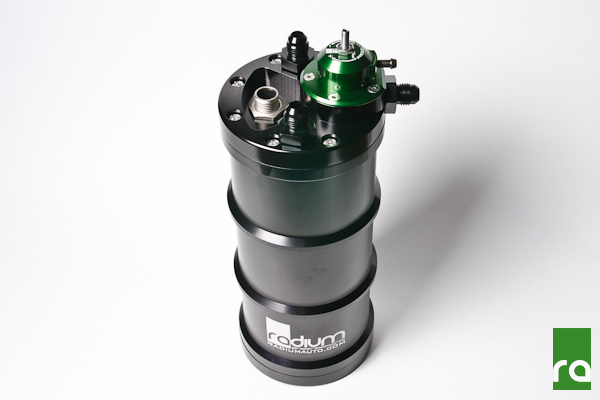

Yeah that would be a pretty simple mounting option. I was looking at these radium engineering surge tanks and like their simplicity of having everything as an all in one kit. I think their limit is 1,000hp though so that's not an option for you lol.
http://www.radiumauto.com/FST-R-Fuel-Surge-Tank-with-Integrated-FPR-P348.aspx

yea i was looking for an actual surge tank all set up for the power i want, but most topped out right around there. which is pretty much where i run out with the pumps i have. would work better but not able me to go any faster.
i emailed aeromotive about using that tank above fuel cell as a surge tank and they didnt really have any concerns that it wouldnt work (aside from what i already planned).
52,956
Aeromotive are definitely people to talk to about that, pretty sure they know their shit. I would utilize their knowledge for sure. Nice to see the progress. Are you getting the itch to see what this all does?
