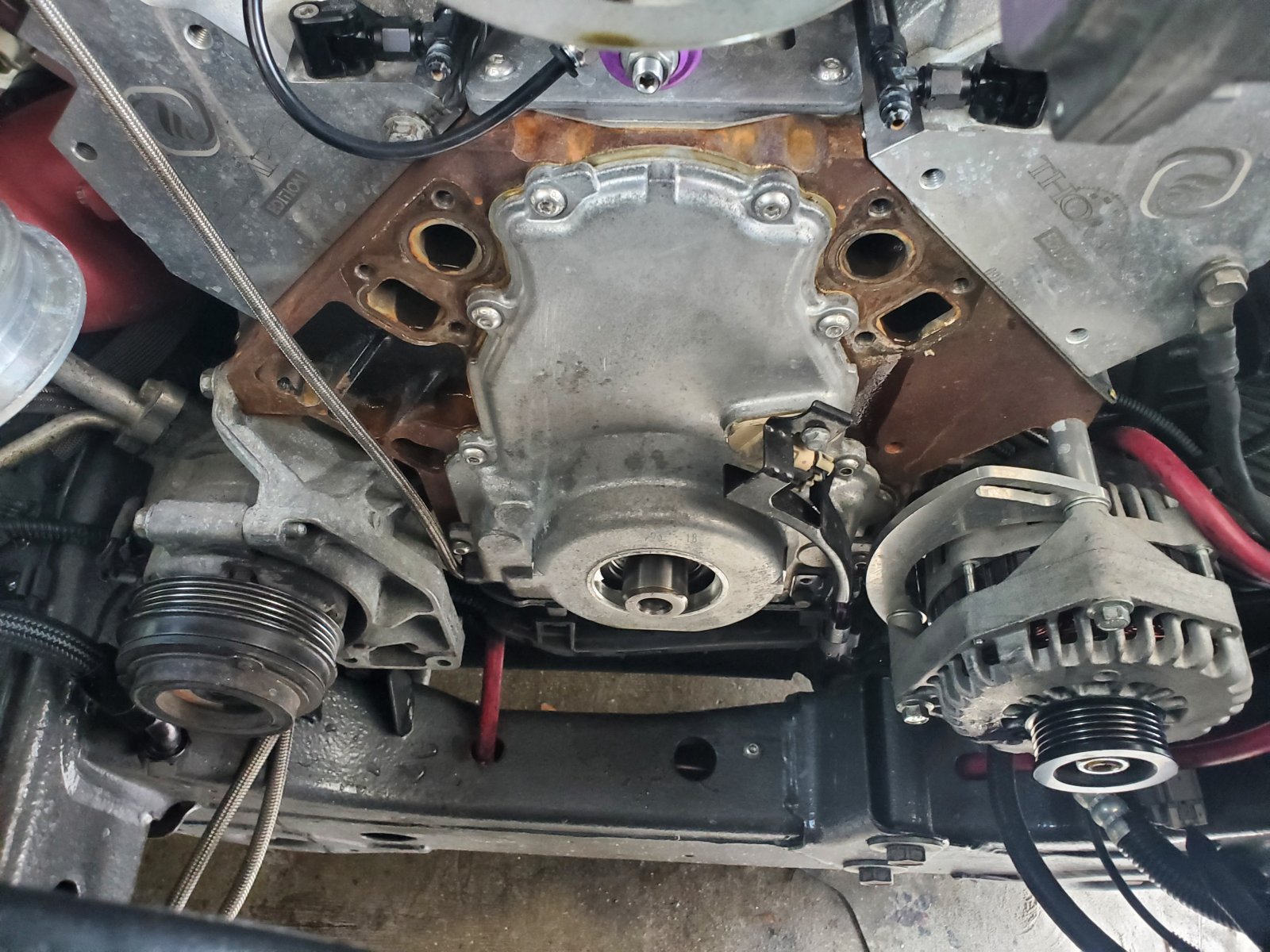

Belt throwing tore up the front seal, kinda sucks but no big deal I had another seal here.
Took off the charge pipes, belts, balancer, went to take the seal out and grabbed it a little too deep. Put a slight knick into the housing, its technically behind the seal but I bent it forward a little...let me just give 'er a few tappy taps so the seal will sit flush :doh2:
The softest aluminum known to man decided to chip off, it stayed in the cover tho...ordered a new one yadda yadda
