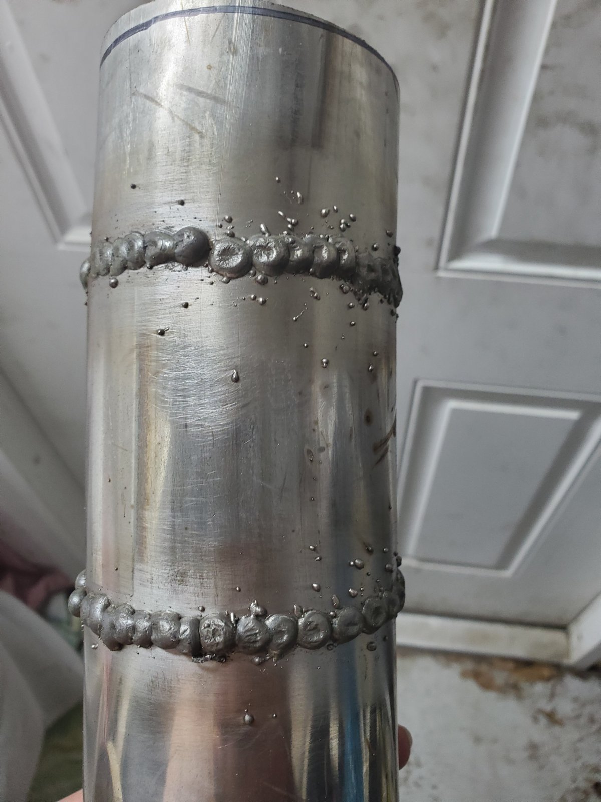

welp.... i still suck at welding but with the gas its 10x better looking. still blaming the welder, trying to "dab" weld the pipes, got the temp (voltage) up as far as itll go and it just wont lay em flat. feed is inconsistant...fairly certain it wont leak so some exhaust wrap should make all the ugly go away :anitoof:

What size wire are you running?

.030 iirc
i ordered some tube and flanges to make up the waste gates, so going to give it another go
if i held the puddle any longer it just wanted to (and a time or two did) blow thru - i had the shielding gas at like 15psi - not sure if i should try bumping it up

Go down on your wire size. Try a .023
You'll probably need turn the heat down a little bit. The shielding gas psi could stand to come down, IMO. As long as you're not going any holes in the weld, its good. So lower the gas until you start getting porosity, then turn it up until you don't. I don't think it hurts anything having it up higher, just a waste of product. These steps should help you with the weld "roll under" (looks like a mushroom).
I'm sure you know but if not, you'll need to change the roller on the wire feeder in the machine, as well as the tip.

i had to flip the roller to run the .030 (big side wouldnt grab, small side was all the way loose...so pretty sure this pos should be able to run .023 i'll see if i can fine some, not sure what tips ive got around either
ordered both.... the smaller wire may be the ticket - should let me puddle without piling up the wire

Good deal.
It will also keep your from buying through so easily. win/win

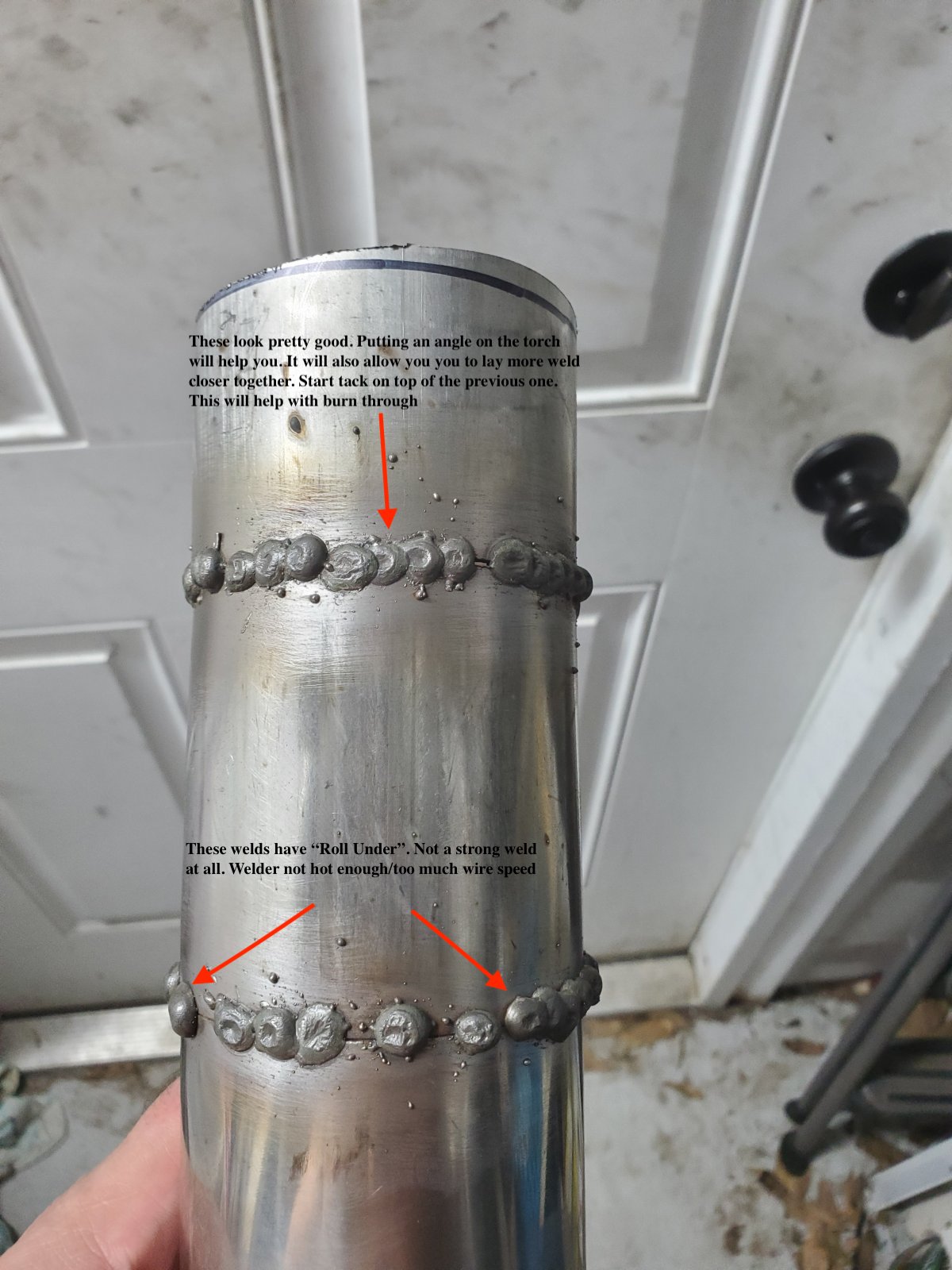

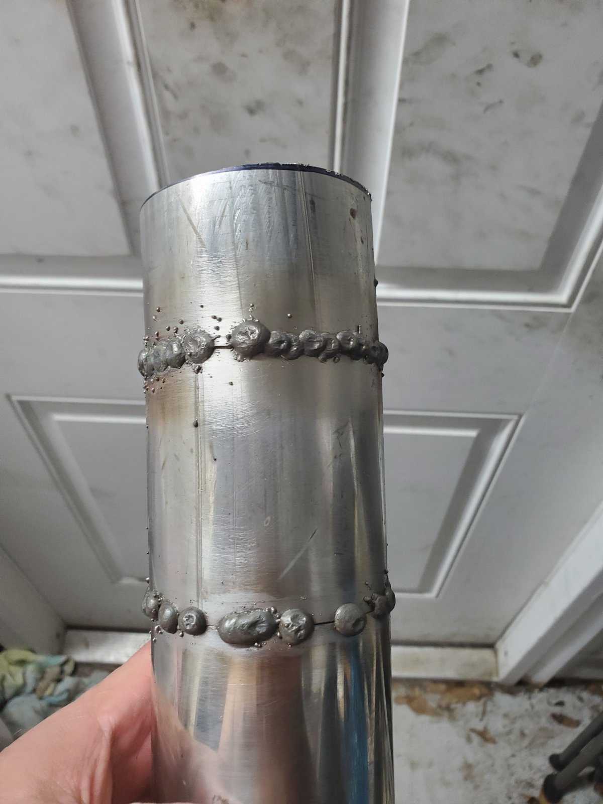

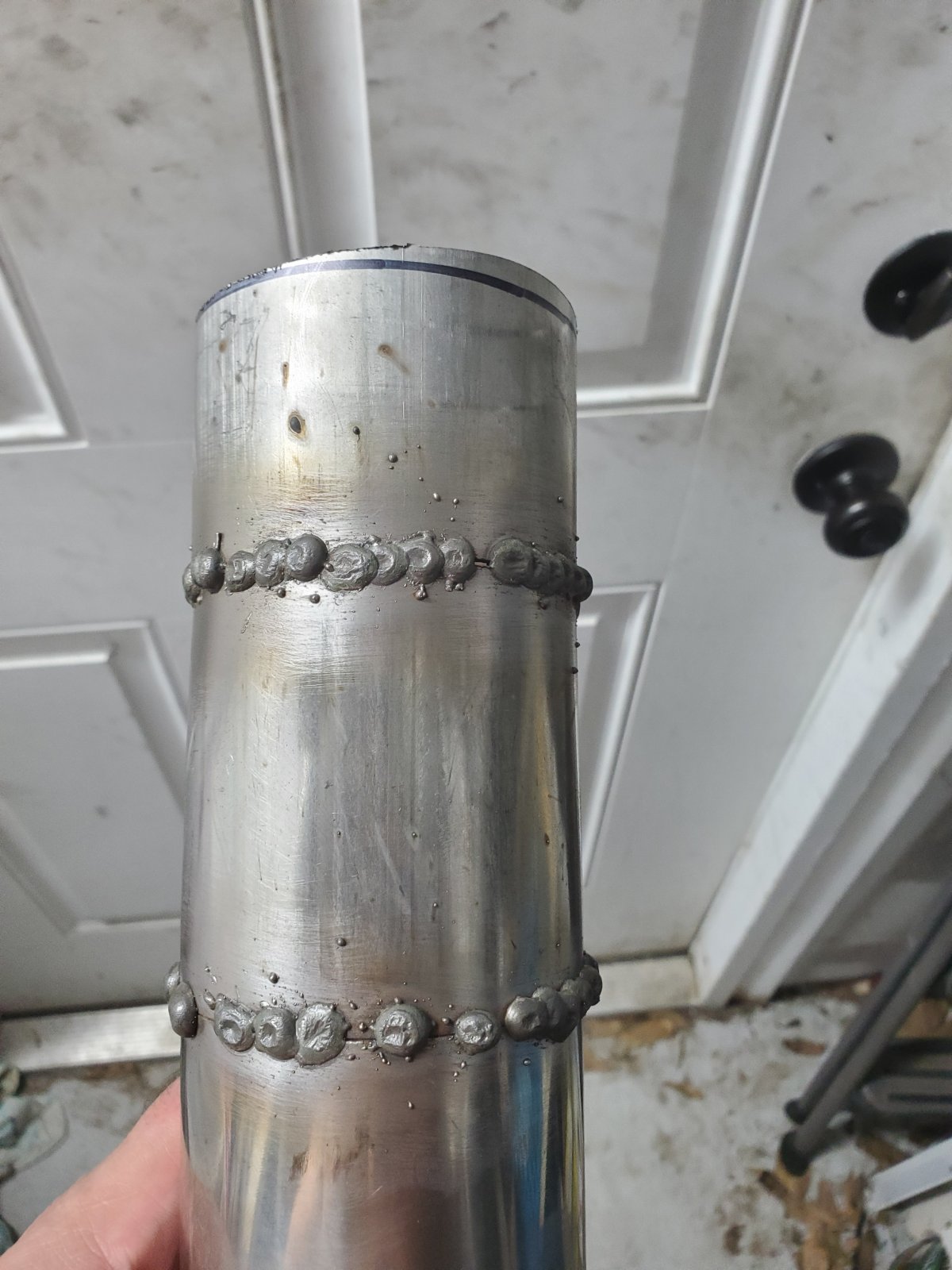

sooo tonight i just started burning, started pretty low on some material settings for a miller welder (this junk doesnt say much).
any lower on the wire feed and it wouldnt hold the arc and splattered all over. so i just started bumping amps up, burn a few bumps, check, higher, higher higher. it starts to lay over with more amps, but mostly just because its about to blow through and all the material falls within the pipe
at the lowest amperage and wire speed (miller settings) its easy to control the puddle but its way too much filler so im hoping i can find a happy puddle setting without all the filler with the smaller wire.

Slightly better than the couple times I’ve tried to weld. All I have is a flux core HF 120 volt pos so maybe I have hope lol.

Hold the torch at a 45 degree angle instead of going straight in on it. A few of those welds like good but most of them aren't penetrating enough. When you get the smaller wire, I think you'll be good with some adjustments in your technique. Hold torch at angle, zap, move, zap, move. Maintaining a nice "dime on dime" pattern. If you have any thicker stock, practice on that with the thicker wire until you can lay a bead. Once you conquer that, you'll know what to look for on the thinner material. Rest your nozzle on the material and steady your hand. That helps with control.
You can get wild on the thicker stuff as long as it its thick enough to not burn through and you can lay a continuous weld. Some work the weld in a circle to get the roll of coins look, I prefer the half circle method. Use whatever method you're comfortable with. The main thing is getting the weld to be strong than the material. Get in a comfortable position. Waste some wire. You'll get there.
Its hard to explain this in text. I hope I'm helping and hindering. Hopefully some others will chime in who can add more technical info/critique/tweak what I've said
