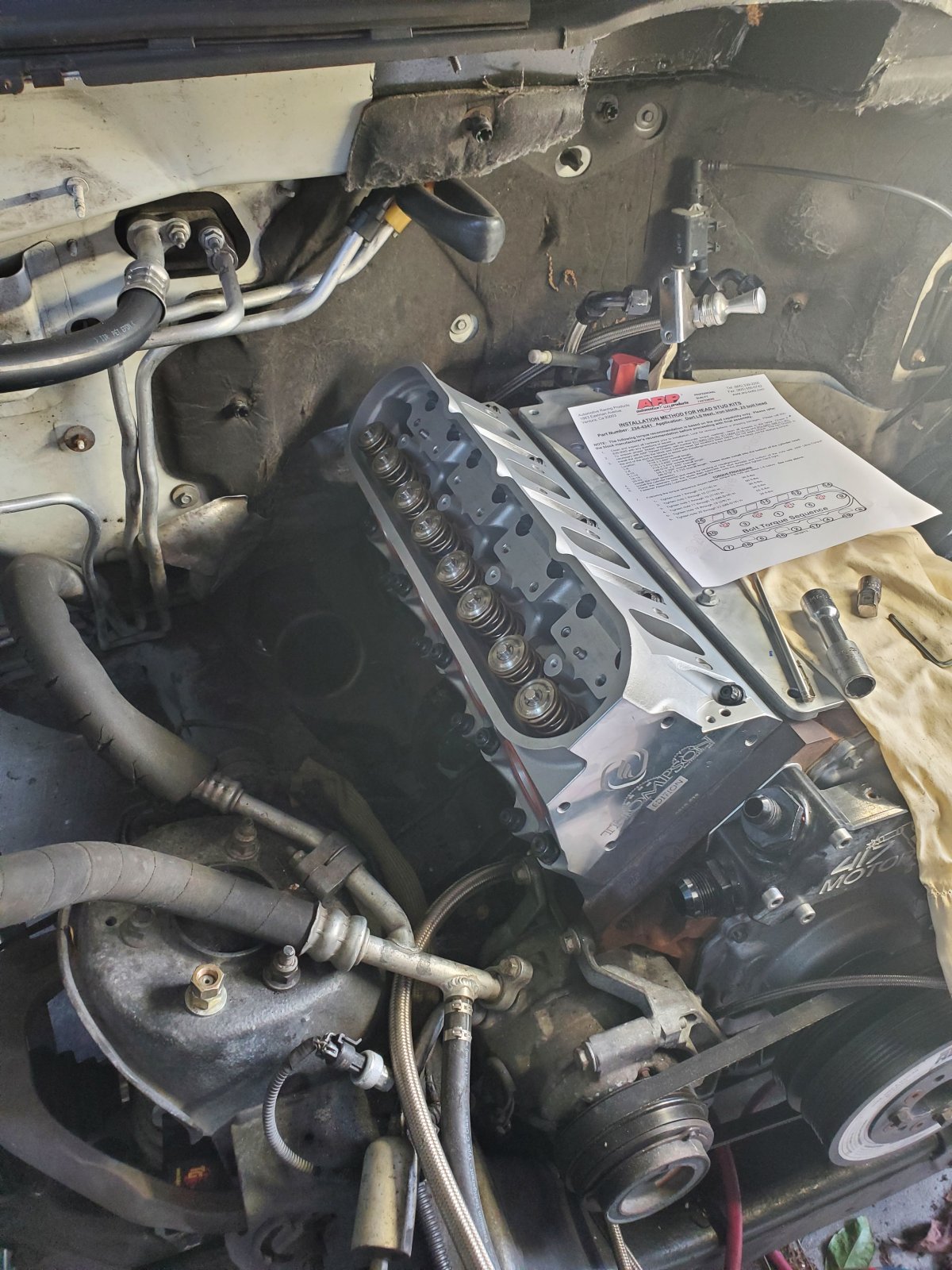

cleaned all the arp hardware, put the studs back in the block, layed the head gaskets down - which is interesting...these have the stainless hoops, i assumed they were bonded to the rest of the headgasket in some way but nope they pretty much just lay into the opening in the gasket. very small interference to "hold" them, with the rest of the gasket on the block they sorta warp and lift in some spots. going to be a little nerve racking setting the head down on them hoping they stay where theyre sposed to

One head down after about three tries lol
Been a while:crazy:
Forgot the 4 stugs that go in the bottom of the head, realized after starting to put washers on, 2nd time forgot to arplube threads after putting nuts on

other head is on, the nuts that go on thru the valley/lifter pockets are prob going to give me nightmares. theres no way to put them on by hand. best way i came up with is to put them on the end of a small magnet and try and get it to start threading. but you only have like 30* window to work with. i would get one or two pretty easy. then it would take like an hour to get another, couple more easy ones then another pita one.
finally got them, put valvetrain on one side started raining

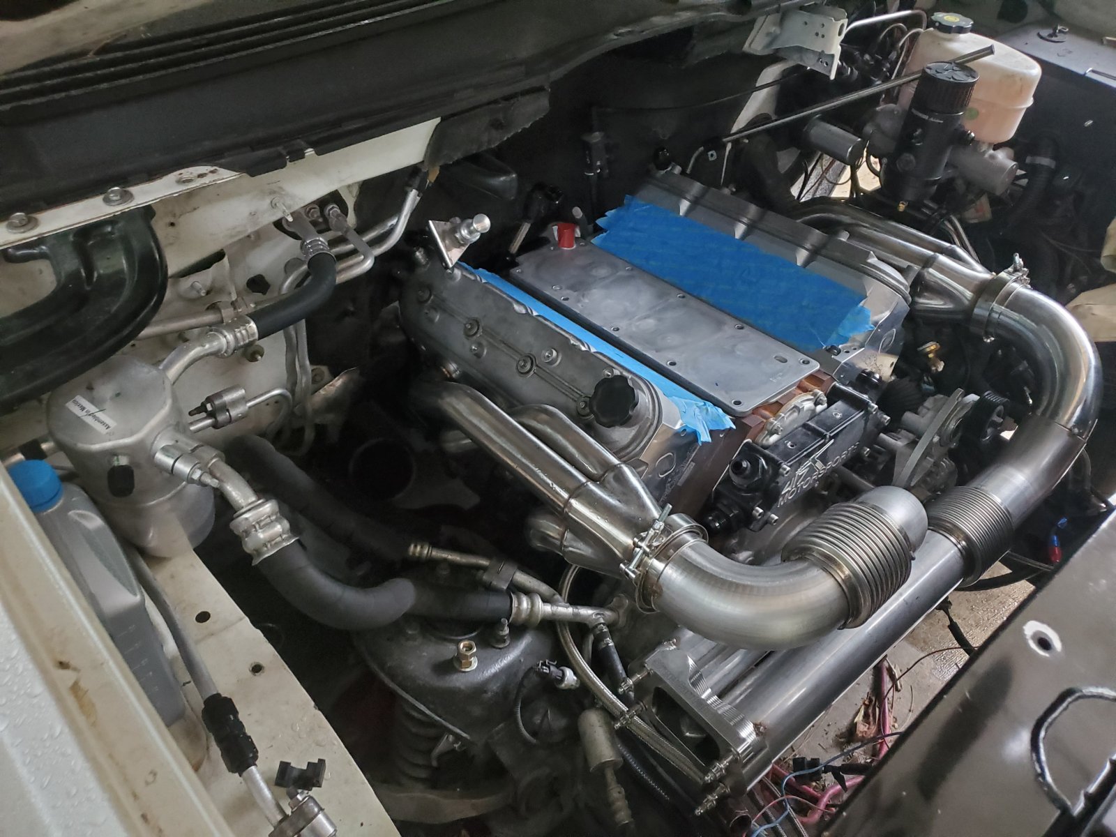

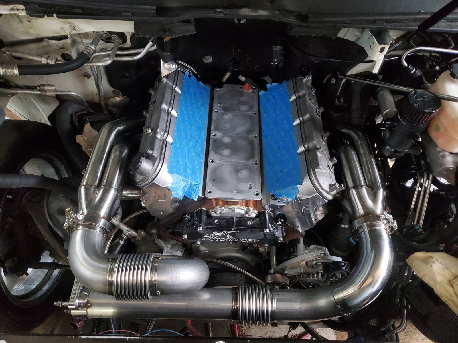

As it turns out these heads are wider that the stock heads on same block by about 1/2" so whatever I did before wouldn't have worked anyway. Added another flex joint, brings the length of them pretty close to equal just for you @iamdub

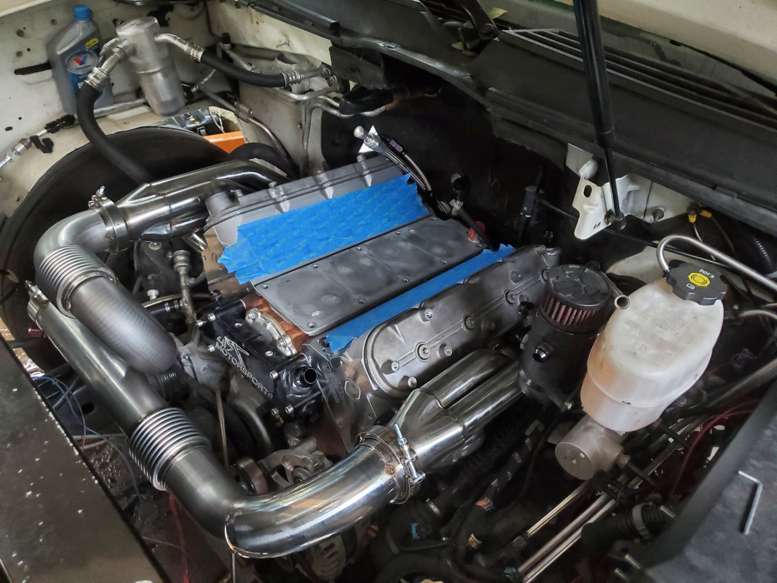

going to see how much room i have after the turbo/dp/charge pipe are in, everything else can go where ever
i have removed the battery, hydro pump, coolant reservoir to make this happen - plan was to put the hydro pump where the battery was on driverside, but i may just leave battery - get different hydro pump and bury it behind the bumper cause it has been problem free im not too worried about having access to it after its topped off and working. coolant reservoir i will prob be able to put it back where it was and just re do the hoses.
a2w tank im think of doing a larger one mounted in the back, under would be nice but it condensates and drips = make track mad. so who knows.
