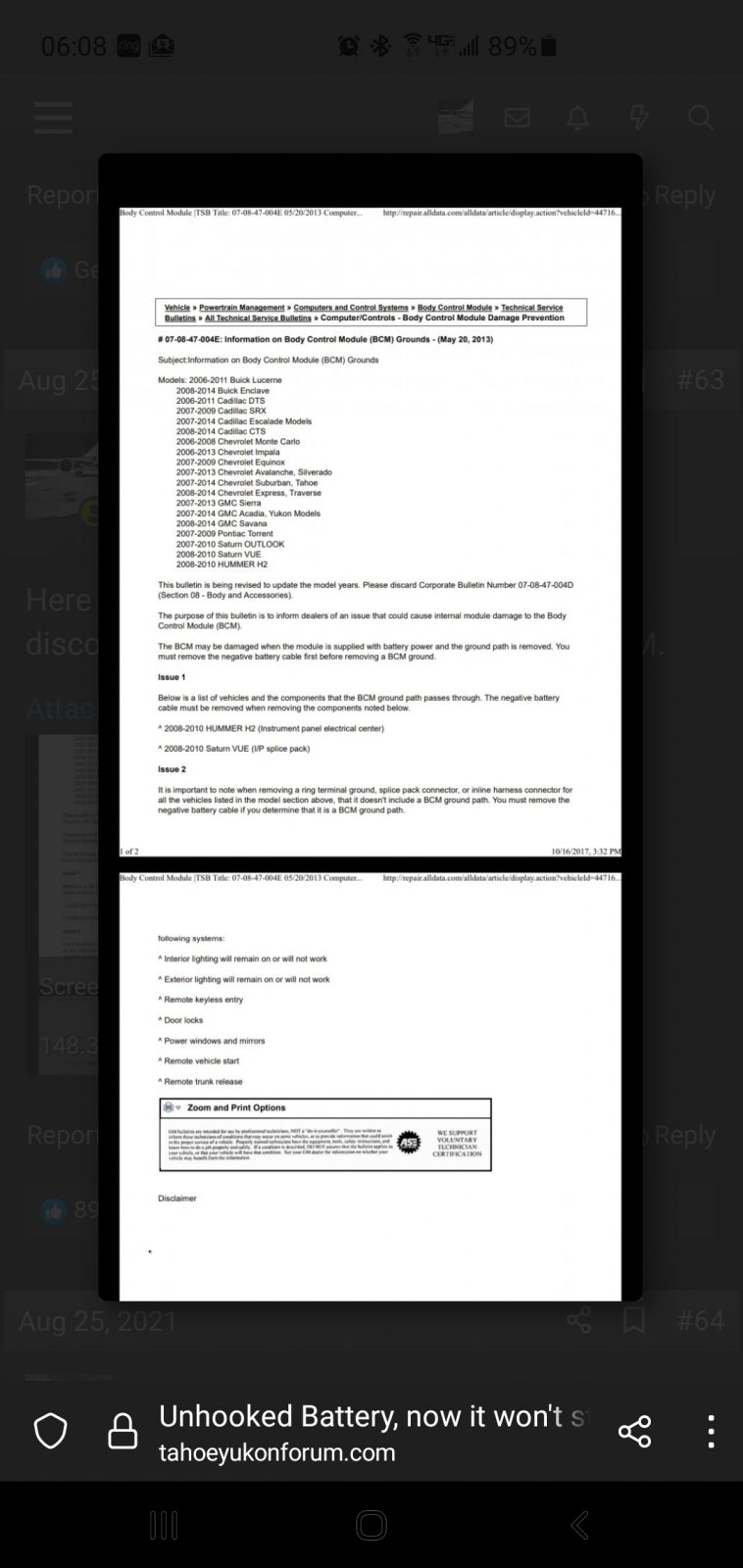

Did you happen to disconnect the battery before doing the work you did?
There was a recent thread with similar symptoms (security like issues) where someone was working on their power lift gate (or maybe their wiper motor) and didn't disconnect the battery. Somehow they took out their Body Control Module (I think it was the BCM), due to I think the internal grounding design of the BCM. You might search the Engine and Powertrain and the General Discussion section of these MY's and check it out.
Good luck.
That was me that posted the tsb about the BCM. Here is the pic from that thread.
W
wfburton159
Mar 10, 2013
42
14
Thanks for posting. I did not remove the negative battery cable. It very well could be the body control module. I am still in the process of trying to make sure that is what it is. With the issue coming and going I do feel better about it not being as delicate of a system as it first seemed. I was glad I got out and drove it for a few hours to try and figure out the issue. If you look on youtube there are countless videos with the exact same warning lights and almost all of them have a different resolution. One just popped up on my recommended videos today and the resolution on that one was a bad spark plug. The Astrostart wiring on this one looks horrible and I was getting kinda rough with the unit and likely moving wires around. I have wanted to upgrade this to heated wheel so I have found a used column. I will likely buy a new coil spring at some point because I think that is one of my issues as you can crank the wheel back and forth and the issues show themselves. Last night when I parked it everything is in working order. Found another video about the steering wheel position sensor at the bottom of the column near the floor. So many possibilities.
