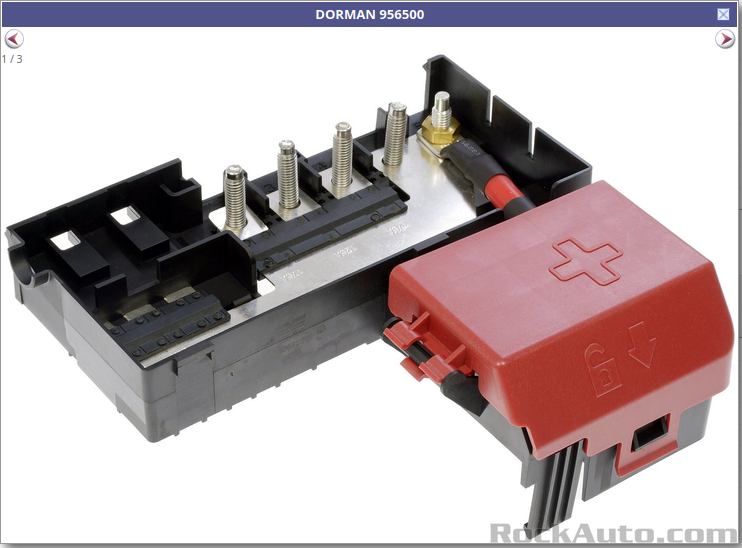

Is one of the major fuse links on top of the battery blown?
30,760
48,452
^^ this, check all the fusible links each powers a different system, if one is burnt this is a problem. replacement is about $120 last time i checked.

meh, in a no start scenario like this he probably blew one of the fusible links.
ALWAYS disconnect the battery when doing anything electrical, especially electric power steering
another clue is no communication with OBD which means a system is down.

On some of the k2's with a push button start there can be a "separate" unrelated no start issue. (generally the fob signal)
otherwise if it wasn't for that bastard mega fusible link they started using it would be your typical troubleshooting, shift position, starter relay, brake pedal
but since they decided to split the systems up on that link it makes "some" of it not work.
I discovered this very thing when installing a audio amp and let the smoke out and initially thought I had fried the ecm/bcm or something, luckily it was just the link
