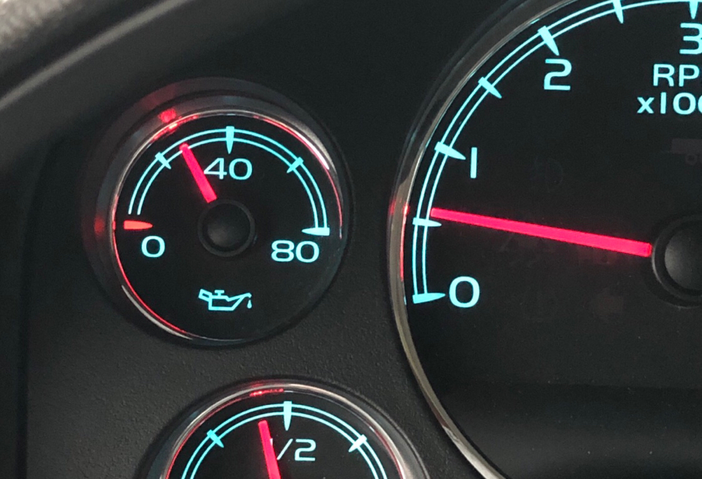

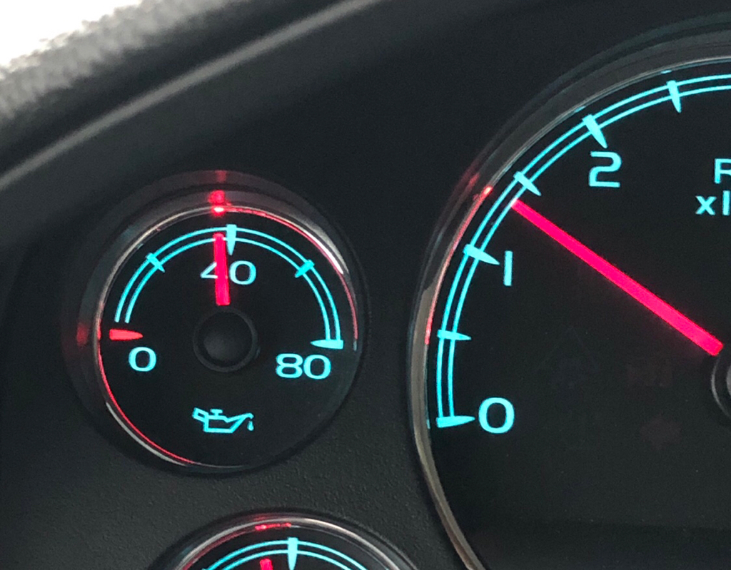

Below is my current oil pressure readout after installing the cooler. Should I be concerned? I don’t have any before readings but I don’t recall them being this low.
Also, I did top off fluid after everything was done so it’s not low on oil or anything.
Warm Idle
Warm cruising speed

That is pretty normal for most of these trucks.
GM claims these LS engines only need something like 6psi of oil pressure to float the crankshaft of my memory serves me.

i will also add this option before next summer. i think what your seeing is the new norm as your oil heats more rapidily to op temp based upon the fact that the radiator coolant is now heating/cooling the oil more effectively. this is a benefit by itself, plus the added insurance of lower oil temps under extreme conditions such as uphill towing/high rpm and summer heat the oil temp/pressure will be more stable. Great work!
