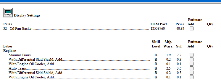

Just wondering the time it takes to put in a new oil pan gasket on 02, 5.3 with 4wd. Trying to see if its worth it to take in and have it done.

while in there, I'd do the pickup tube o-ring as a prophylactic measure. Adds no appreciable labor time (book time is listed 3.5hrs as well)
I'd also do your oil cooler bypass plate gasket because why not.
