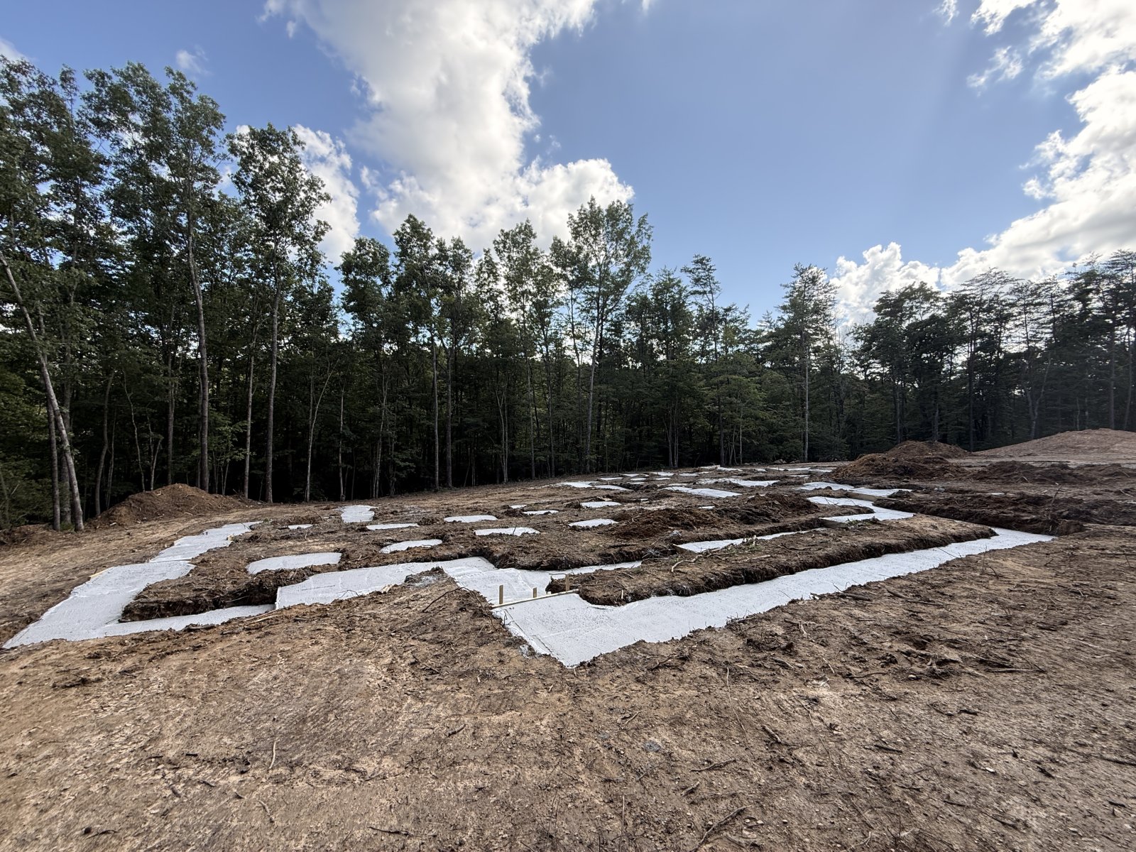

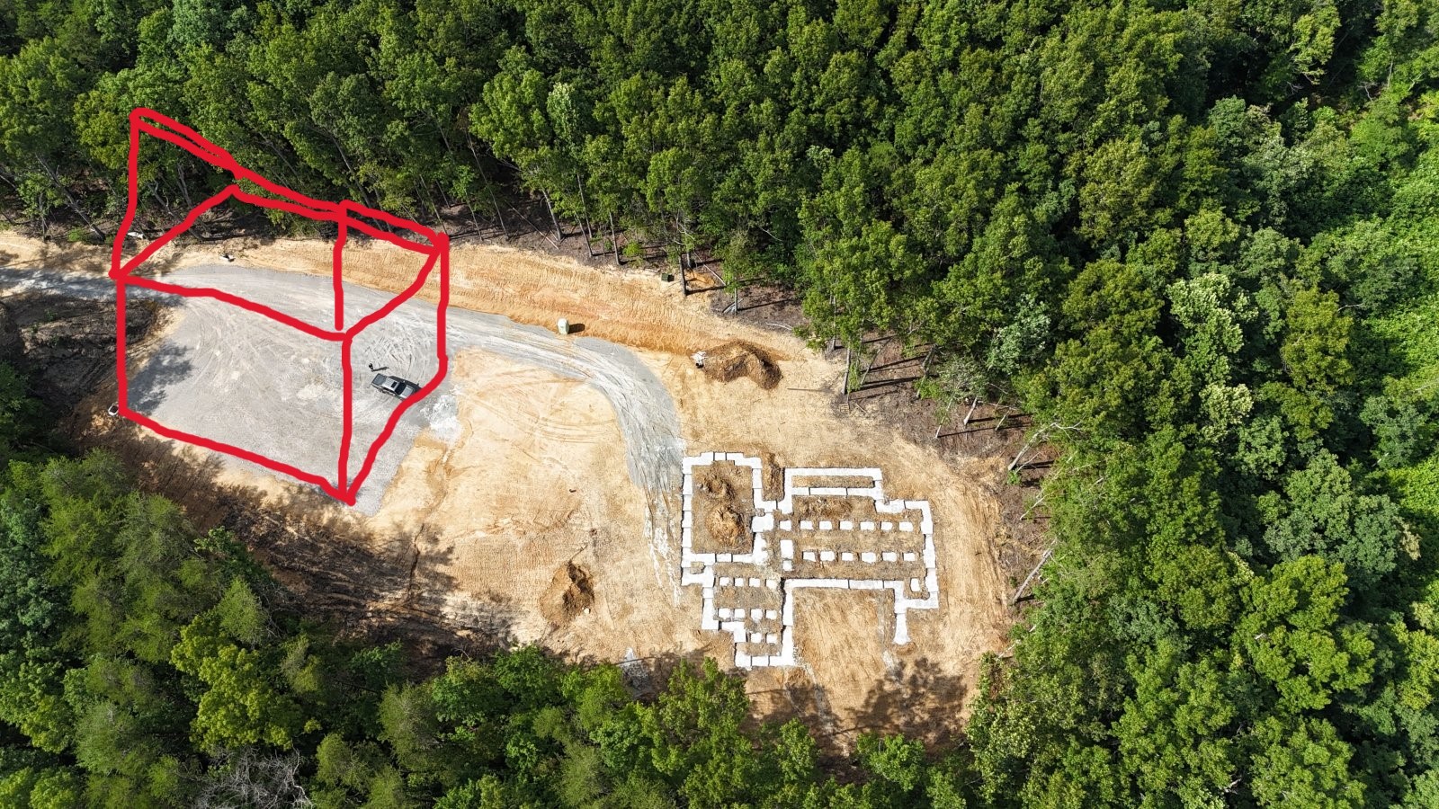

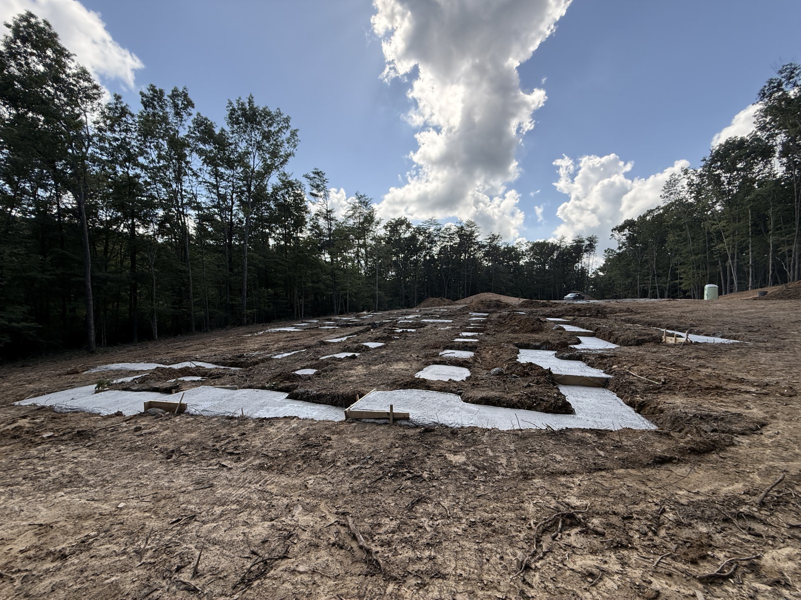

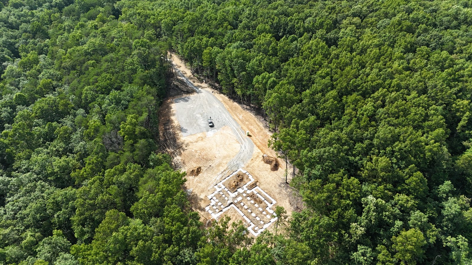

Footers are poured. They didn't do the deck piers.
Everyone was gone when I got there. Tried to call my builder but went straight to vm. He must be tapped out. Called my excavator to see what the yardage ended up being. He said 78 or 79 yards, he couldn't remember exactly. :patriot:
That's a serious ****** footer
So what is going on the footers? Just block? No concrete walls?

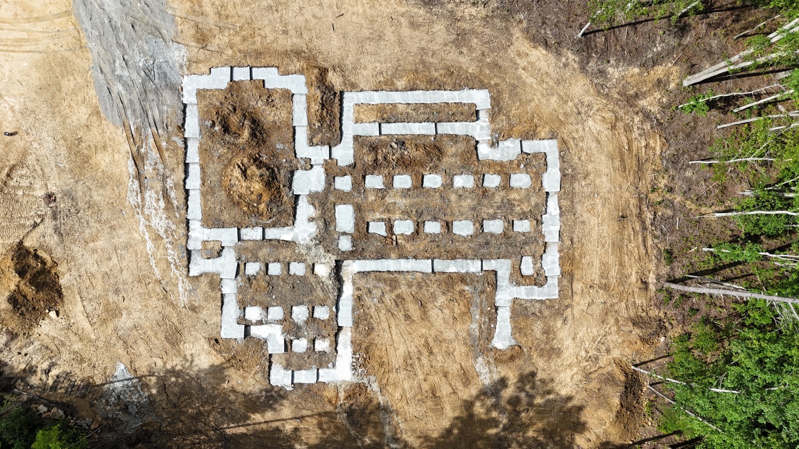

Block. 12" CMU everywhere thats retaining fill, 8" CMU above that. I have to stub a 2' bar up every 36" and fill that core with grout. The 12" block will also act as my bridge ledge, if I'm understanding correctly.
I'm not extremely well versed in the block/brick world, so forgive me if I've say anything "wrong".

no basement or lower level cut into the hill correct? see a lot of houses up there that do that, i think thats the only place youd want/need a poured wall to help with the waterproofing
No basement. Considered it, but Steph didn't want the extra space to clean. Probably be encapsulated (waiting on a quote) and may pour a small pad to put outdoor type things under there. The foundation is going to be over 10' tall on that back corner, but doing 2-3' of back fill to mask it, inside and out. Also allows an under drain inside the foundation.
If I were doing a basement, it would 100% have been poured walls. They will still waterproof my block, but I wouldn't trust it on a basement
What are they using to waterproof the block?
No clue. Probably just the black tar type stuff. He just told me he called the guy that does the waterproofing to let him know we were starting next week.
There is damp proofing which is the regular fdn coating and waterproofing which is a thicker liquid or rolled membrane.

Will there be perimeter insulation on the below grade walls? Under the slabs too, along with vapor barrier? Using mesh reinforcement or fiber?
No perimeter insulation. Vapor barrier, yes. That's code here. Waiting on a quote for crawl space encapsulation. If it's outrageous, it'll just be heavy mill plastic as a vapor barrier stone. Not sure what order they put the vapor barrier/stone
Keyway or dowels in the slab joints?

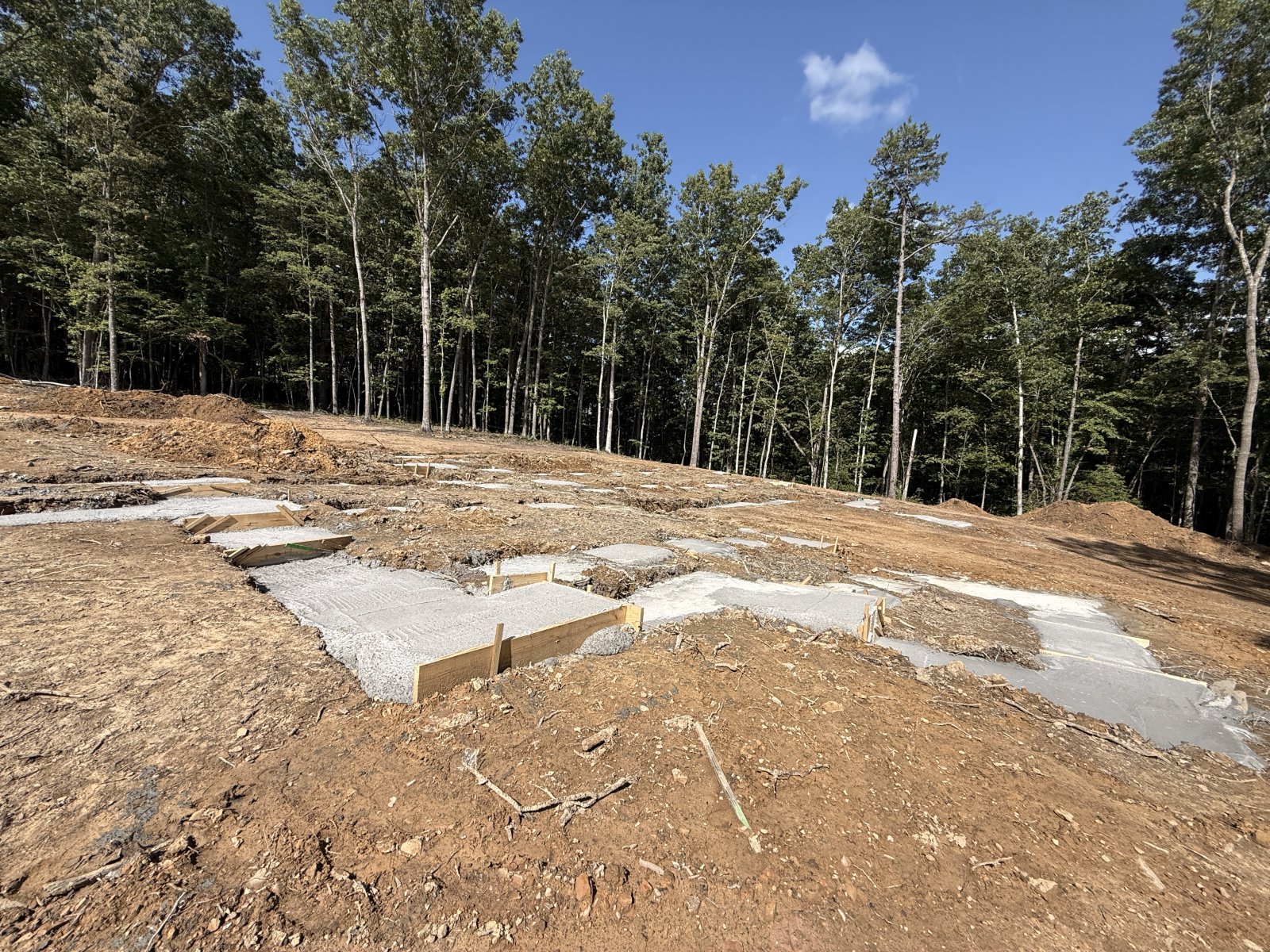

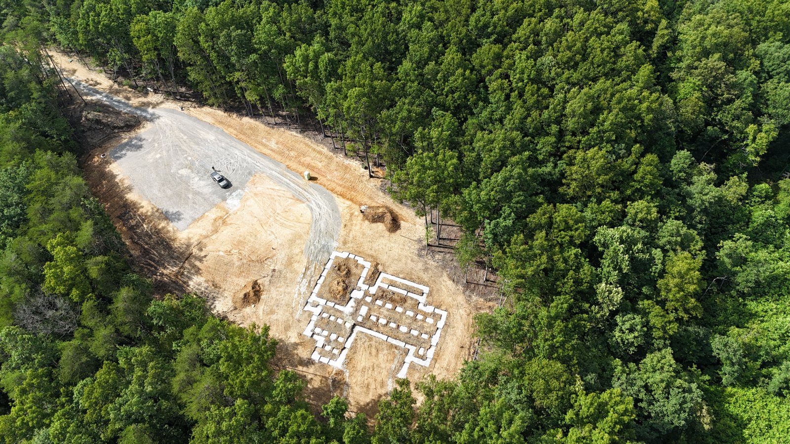

They stripped the forming off today and looks to be all they did.
The shadows are doing the first image no favors, but I'll share anyway
