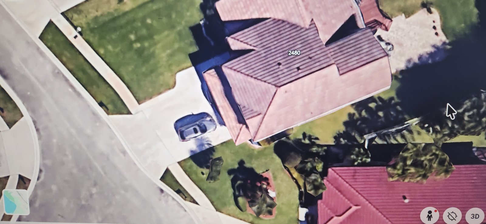

Turning toward the garage door, to comfortably line up to enter, …… in photo….. position left tires at the gutter’s edge, then left turn and straighten, facing garage entry….
In photo, I measured 40’ from garage door to gutter…. then add 8 or 10 feet more distance for your drive up to driveway entry.
So, 50 feet ?
( In Google Map, the car on driveway is our Infiniti QX50.

The first 12 feet of the actual driveway is your turning……. into driveway... then straighten ahead to enter onto actual driveway pad. Without feeling cramped.
Especially if you park on left side.
( Keep in mind, your left-side tires will be parallel to the gutter edge ( as per photo)

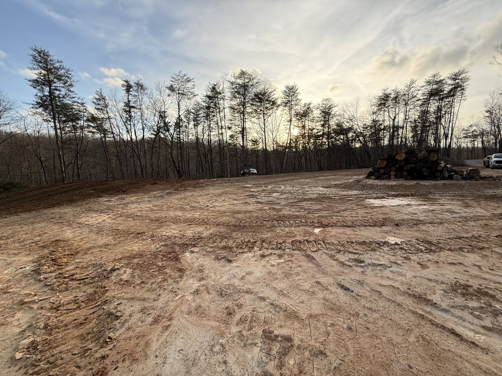

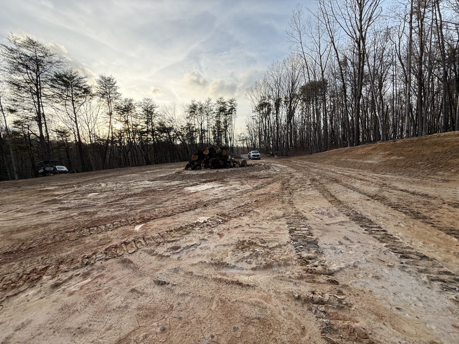

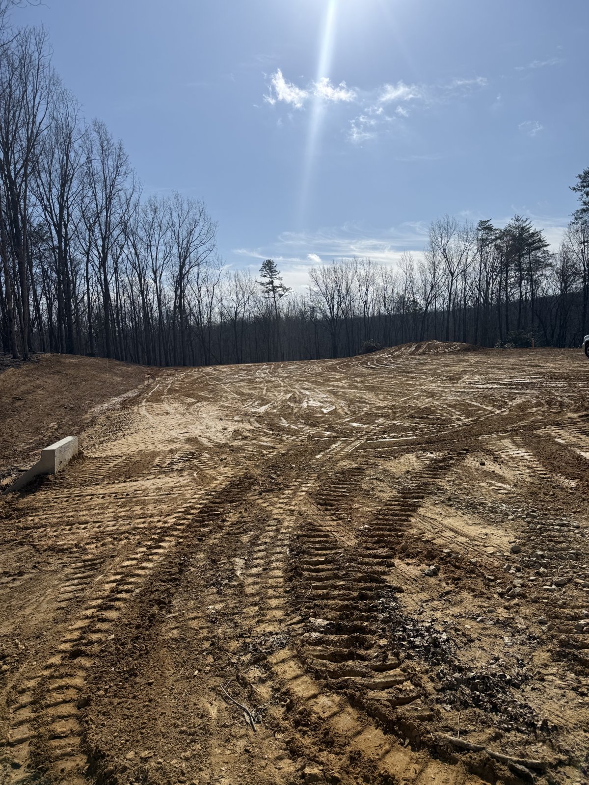

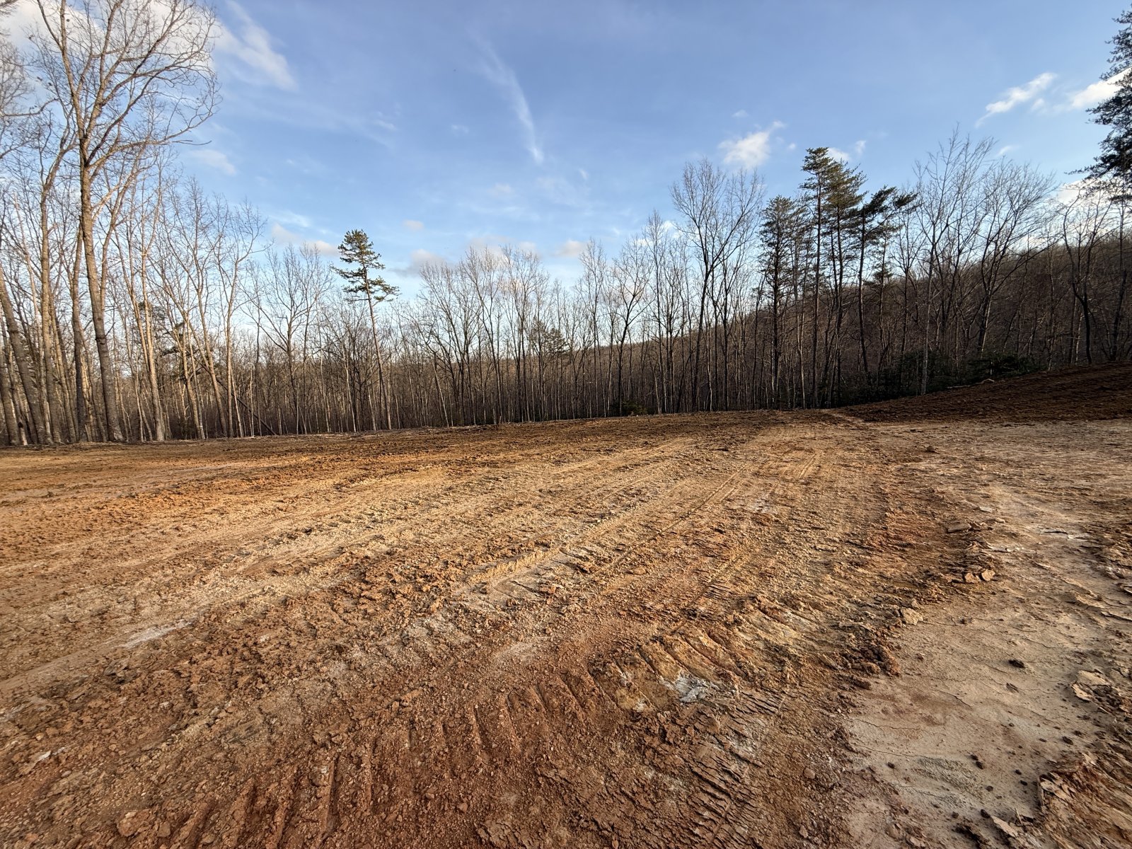

Nothing really got done while I was on vacation. They worked the Friday that we left, but just at the entrance. They started cutting a new swale to pull the water away from the retaining wall and redirect to both catch basins that are by the road and driveway. They also started cleaning up the sides of the driveway. There's piles of brush stacked up along side that need to be moved and burned.
I went out today while one of his guys was out there. They cut more of the hump out the pad, closest to my house. Reworking the slope closest to the catch basin. It was still pretty wet when they started today, but dried out pretty good by the time I got out there after work.
If the weather will hold out, the logs should be gone, sides of the driveway cleaned up, slopes seeded and strawed, and the pad graveled by the end of the week. He said he's going to try to have all of that done anyway. Main thing is logs moved, that small section of dirt under the logs moved, and the pad graveled. If all that's done, I'll have the footprint staked or at least flagged from gps data by the weekend. If I'm happy with it, I'll get it final staked asap.
Here's a few pics I took today. Looks the same, because photos don't really show well. Didn't take any of the front. It was getting dark by the time I left and I forgot.
I'm sure you're all as tired of looking at dirt as I am. Hopefully a change comes soon
