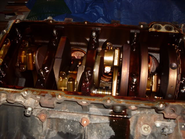

alright, got industrious today and replaced the rear seal and the gasket. pretty straight forward, no need to take any pics or anything. i put the new seal into the housing and drove it into place with a flat board (to seat it squarely) and a deadblow hammer. then for the plate the seal is held by, i cleaned the mating surfaces really well with brake parts cleaner and took off any trouble areas with some fine emery cloth. skim coated both mating surfaces with some rtv, as i think retorq suggested, used some blue threadlocker on the threads of the bolts, and torqued the bolts to 18lb/ft in a criss-cross pattern. pretty easy stuff, first time for me to do though. i don't mind doing any of this stuff, i just don't like REDOING it again. i probably make it a bigger deal than i should, overanalyzing and such, but i just wanna get it right the first time. anyway, i'll probably take some pics of when i put my oil pan gasket in, may be some more interesting pics then. i'm rambling, so i'm gonna shut up.

replaced the oil pan gasket and buttoned up the bottom end yesterday. another chance to play with my torque wrench.
my little helper
anyhow, i'm short on time right now, but there are a couple rivets that you have to drill out on the factory oil pan gasket. i'll edit this a little later to put some descriptions if needed.
