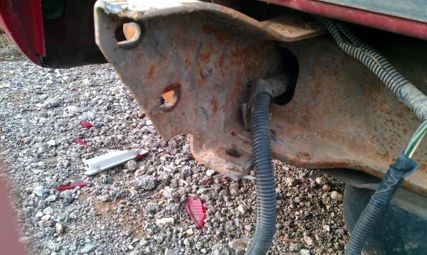

I pulled the roll pan off today to install the receiver hitch and this is what I found, well had to get the hitch on their anyway so drilled a couple holes where I could so the unit had all 6 bolts in there. But why did they use a torch to cut the ends off the damn frame? I was wanting to put a bumper on but now I dont know if I can without some fabrication! :emotions122:

Thats what they do when they install a roll pan. The oem bumper needs something to attach to and when u put a roll pan it hits it so they cut it off.... Rollpans suck imo

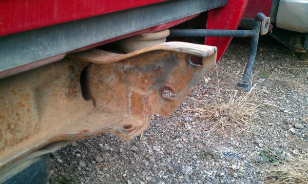

thats what its supposed to look like. I got more pics if u want to see them let me know so i can upload them. They are from a 4dr but the same
---------- Post added at 07:28 PM ---------- Previous post was at 07:26 PM ----------
Its about 10 bolts that go on

yeah I need a bumper and all the hardware...and the rollpan can go in the trash! I knew they cut the ends of the frame but damn they could have at least cut it straight or made it a little more straight!

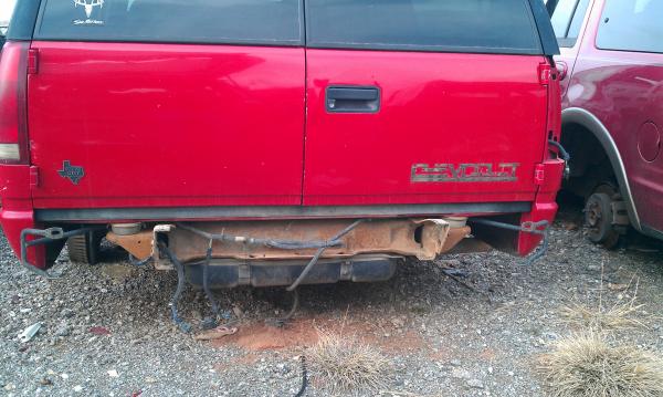

---------- Post added at 07:39 PM ---------- Previous post was at 07:38 PM ----------
There u go. Btw i got the pics out of a junkyard not from my truck lol. It was when i was gonna do my custom bumper on my 2dr but the exuast was in the way so i couldnt remove oem bumper but soon i will pull it out

Ooooph, that sucks. The person or persons who did that are complete hacks.
If you could find one in a junk yard it might be worth your time to go and cut that section off and see if you can weld it back on, with reinforcements of course.

Best way is to weld a plate on both sides then put the piece in the liddle n weld that in on each side. Gonna be strong but ypu will need longer bolts
