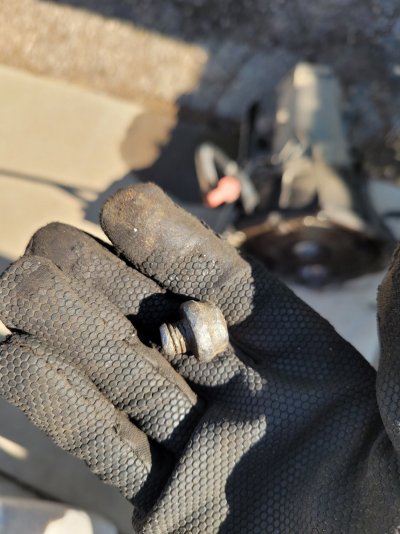

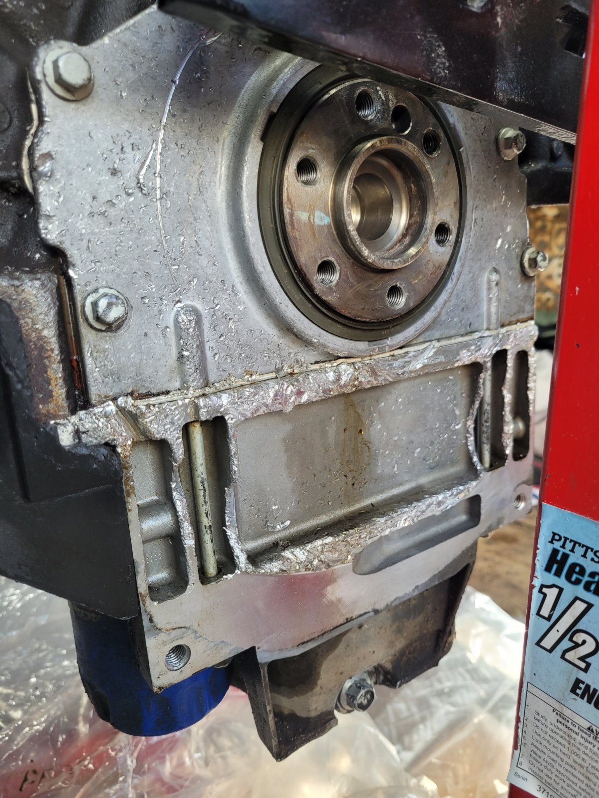

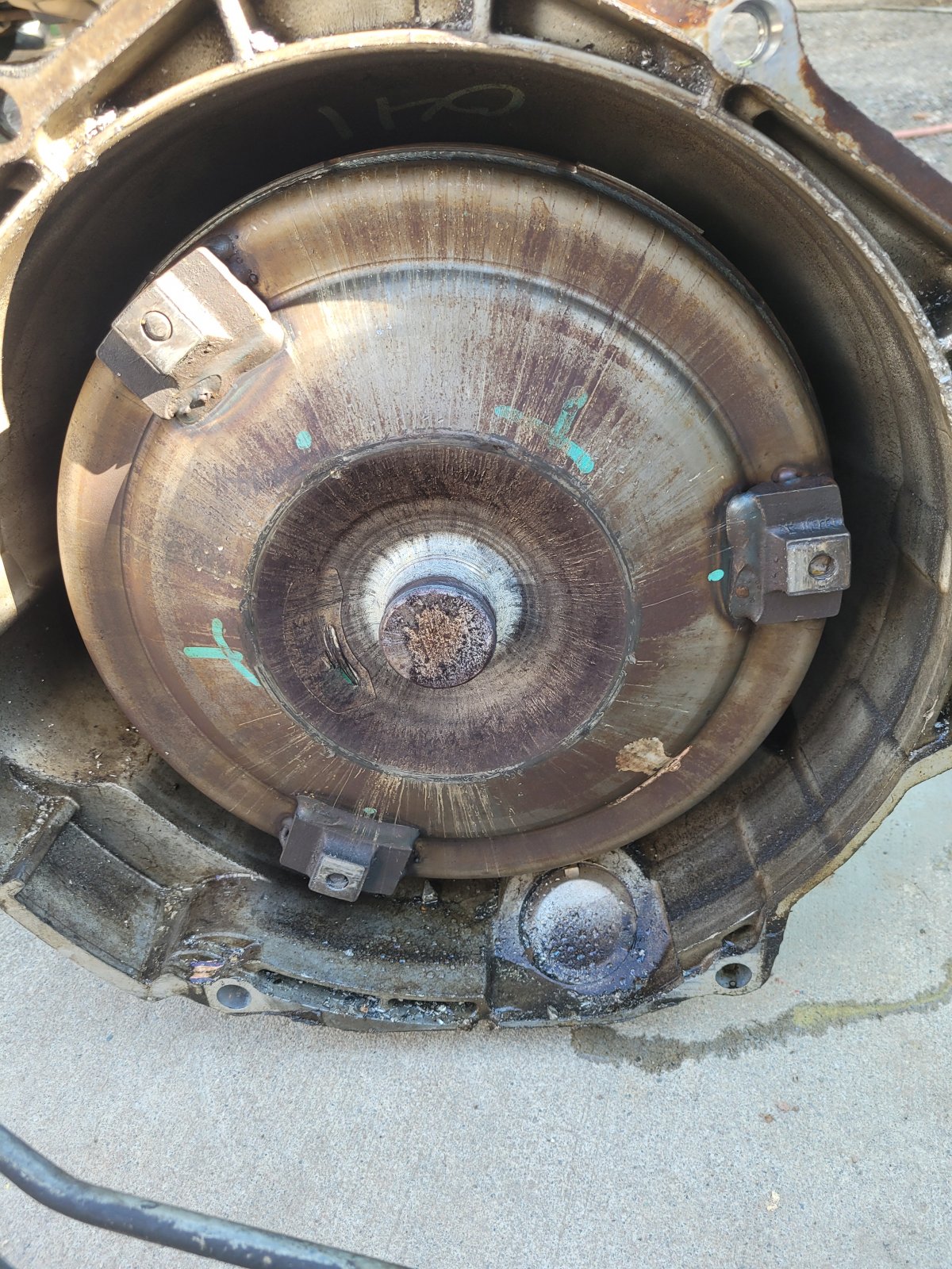

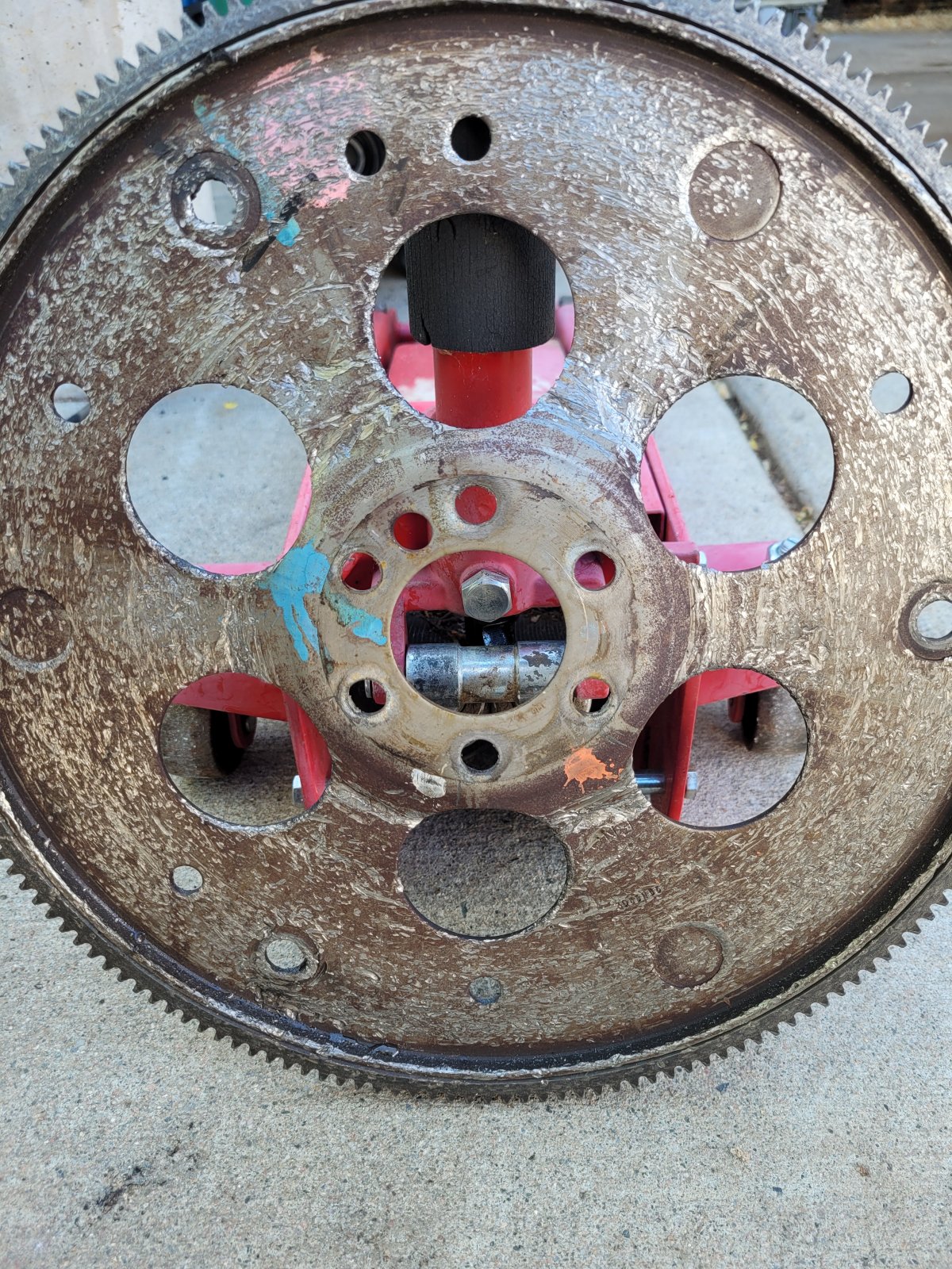

I've attached some photos of the carnage. First of the bolts sheared off in the torque converter (I should have been more clear in my original post that it was these, I thought later it might cause some confusion and some might think it was the bolts attaching the flexplate to the block, those were still intact), 2nd is the flexplate, 3rd is one of the bolts I found inside the bellhousing, 4th is of the rear of the engine (sort of hard with it on the engine stand)

I guess one possibility is the flexplate bolts (somehow) worked themselves loose, and they kept driving until the flexplate bolts hit something and flexplate fell off? I don't even know if that's possible?

I have seen a handful of vehicles where the flexplate bolts come loose and fall out or sheer off.

Maybe it's just the pics, but those bolts look pretty rusted. My first thought is the bolts were over torqued and eventually failed. Also, again maybe just the images, but it looks like at least two of the bolts broke inside the surface of the converter. That's more a sign breakage under pressure (over tightened) versus sheering off.
