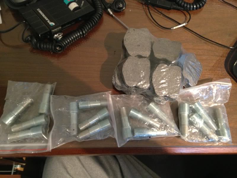

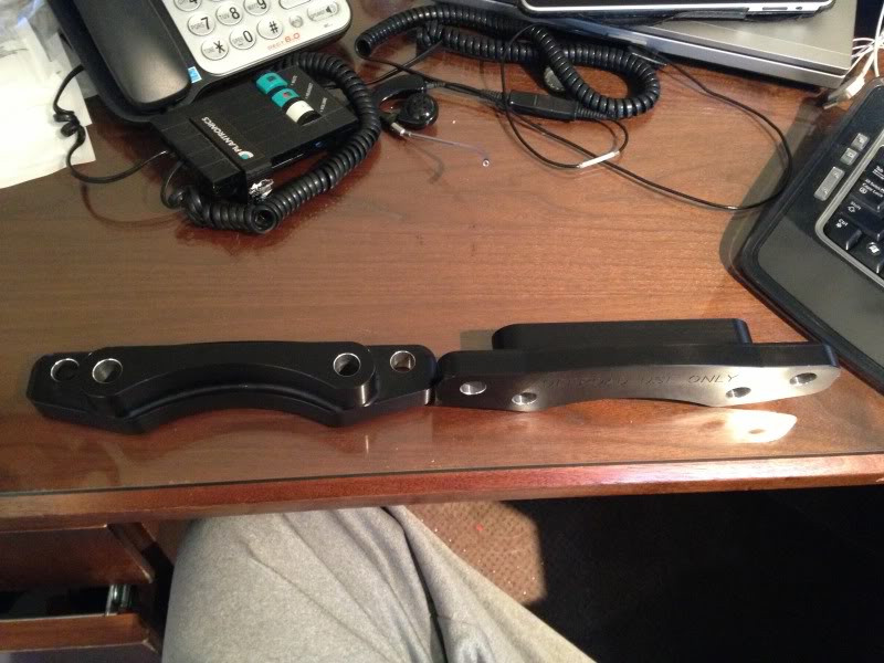

Just picked up my package and surprise to me I got more then what I thought I was going to get. This was a insane deal I got on the brackets and to my surprise I got all the brake pads and pins for the calipers all I paid was 150. Which I needed as the calipers didn't come with that. I will be getting the calipers on Thursday hopefully. Also the quality of the brackets are very nice!

Agh! this cold weather suxs. I can't test fit the brackets when it is -1 out and feels like -21. Maybe I will crank up the heater in the garage and let it warm it up a few hours. I really want to test this.

The real fun begins when you put the rotors on and then test fit the calipers. So much fun shimming, tightening, loosening, shimming, repeat. Don't let those brake pads hang over the back of the rotor. That was problem number one with mine.
After that it was cake.

Forgot I had my stock spindles down in the basement so just went down with the bracket and did quick test fit and the bracket lines up perfectly with the stock spindles. So looking good so far. True test is with the Beltech spindes.

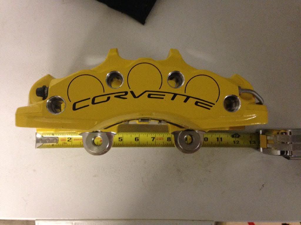

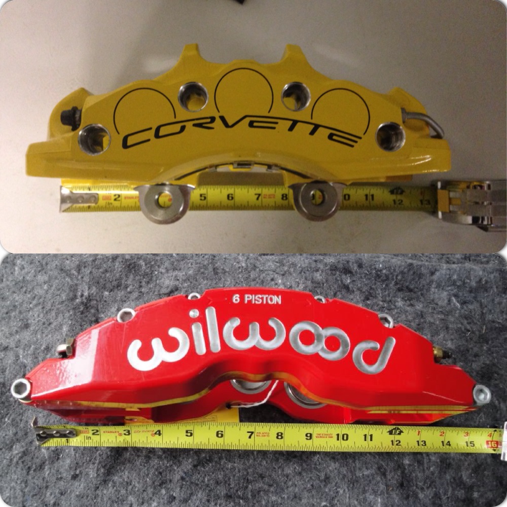

Actually a couple inches smaller then the wilwood 6 piston ones. I think wilwoods are 15". But still pretty big

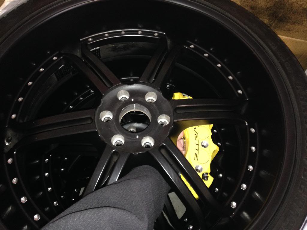

Yellow against black looks REALLY good, but it would kill me to have parts reading corvette on a vehicle that's not a corvette.
