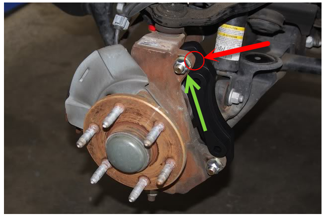

No I had different spindles on my Tahoe. I had Mgh's and these are Beltechs. With Wilwoods I think you have to grind the top of the spindle of the bolt. With these brackets its on the inside of the spindle. . But as you can see in the pic red circle with red arrrow you grind that section for Wilwoods with these brackets you grind the area pointing in green.
I'm going to post this, but it's not going to be favorable. I had to grind the same area on my spindle. Thought that was going to be it. Then once I had the rotor on, the caliper sat off the rotor hat too far and I had to grind more. Just not something I was entirely comfortable with, but I was determined to get it to work. I did get it running but was never happy with it. Didn't feel solid. Which is why I went with wilwood on the Burban.
Seems like you are headed in the same path as I was with the grinding, although I sincerely hope that you can just grind that small amount and everything lines up.

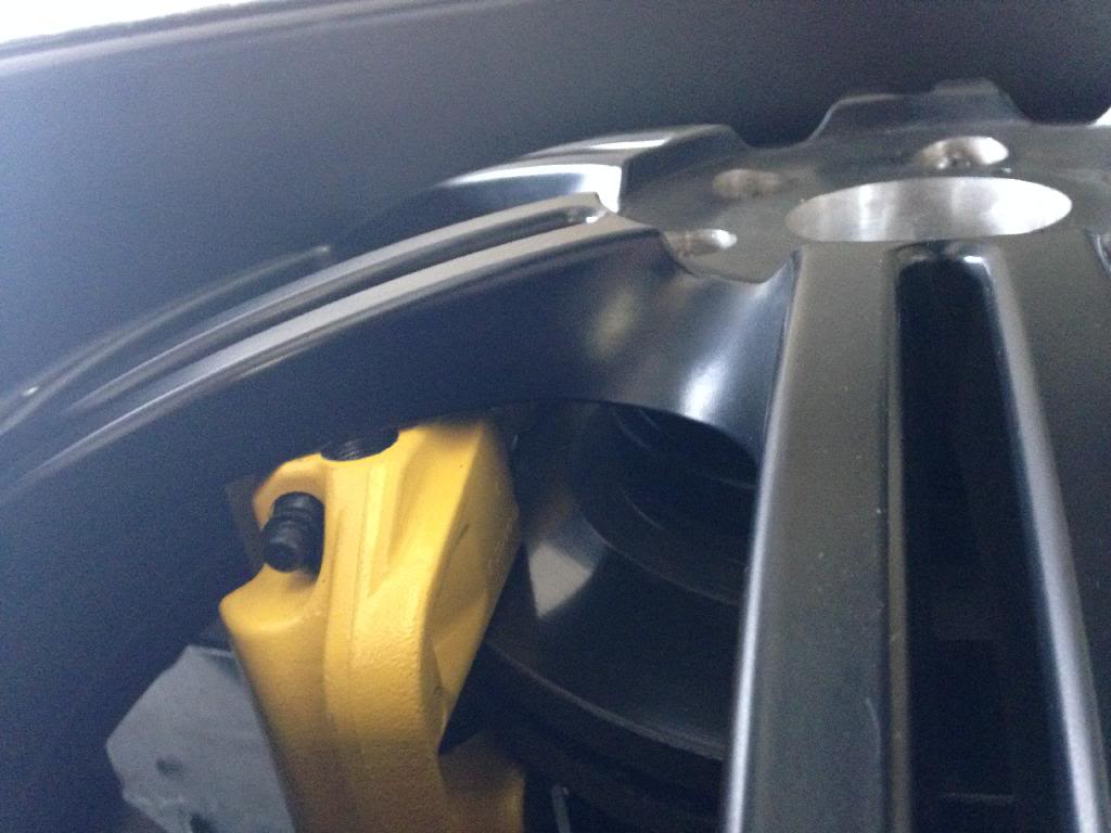

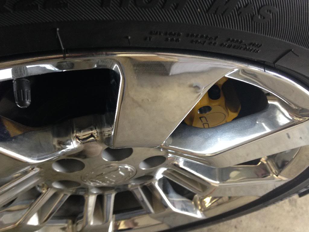

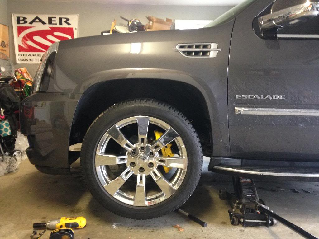

Ok Final test fit on them. I am thinking I am going to go with Wilwoods. I will need a spacer with my 26's to get them to fit. I got them to get on all the studs and pushed back all the way but it touches the caliper. I could go with spacers but I think it will push the wheel out a little to far for my liking as they sit flush now with the fender. The CK's fit perfect with tons of room. Anyway here are the pics
