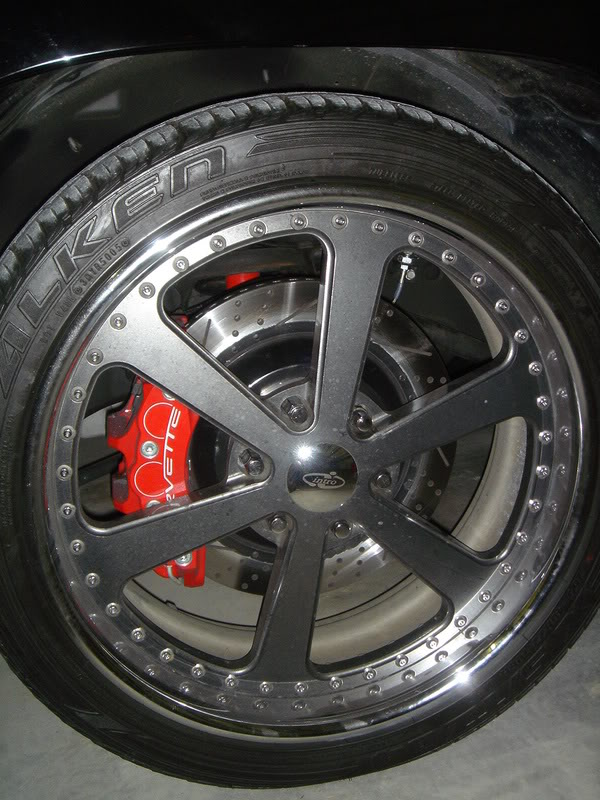

From what I've read on the corvette forums, the zo6 brakes are not thought highly of. In fact, many of the owners are switching to Brembos or stoptechs.

Shimmy, guys with Zs are running Brembo and stop tech for track cars, IIRC. Just driving the stock brakes are fine. If you plan on tracking the car, upgrades are always a plus.

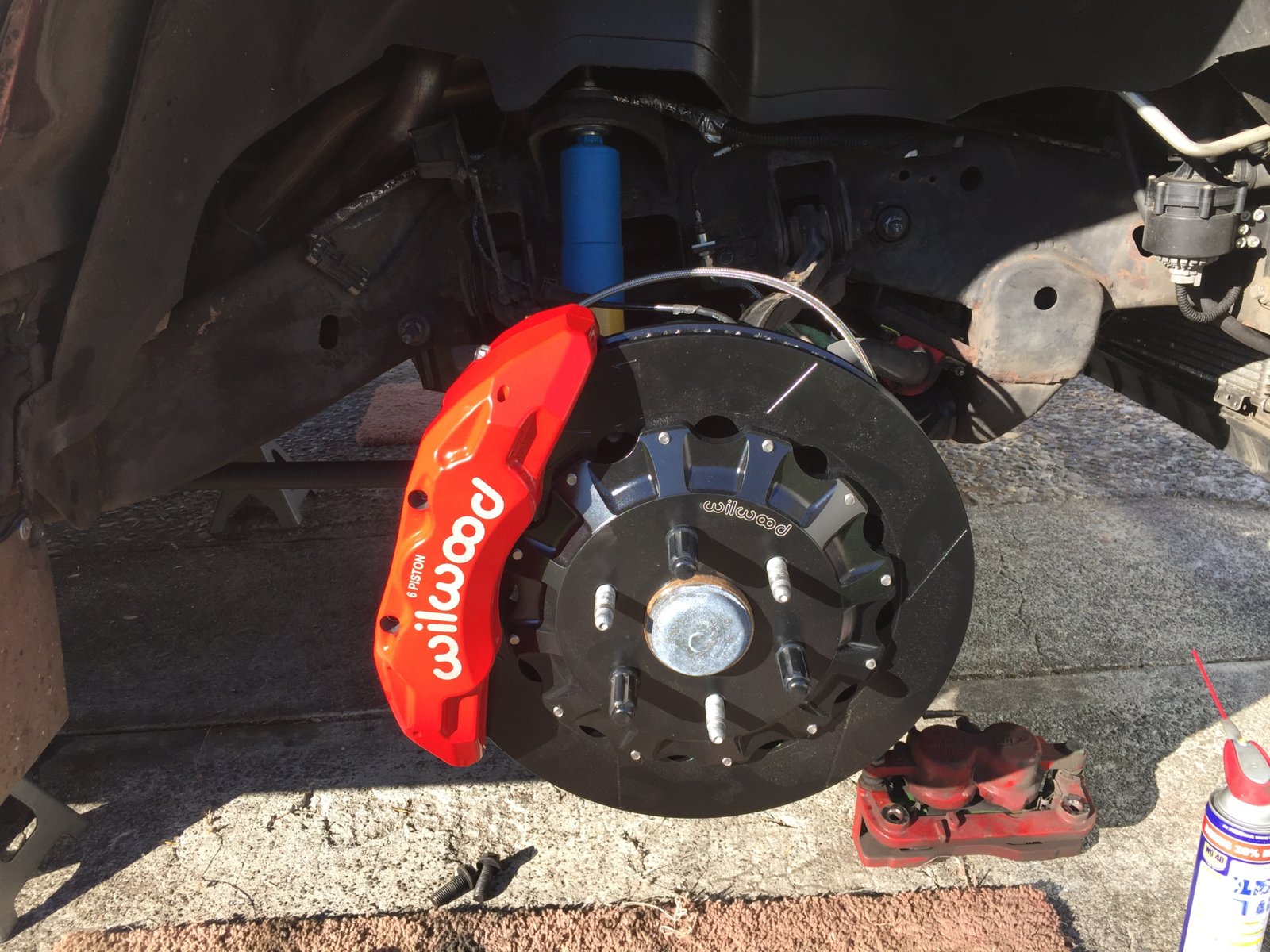

I don't have it off hand as I was just PMing him on Performance forum. But I sold the kit as it didn't fit my rims and went with Wilwoods but ended up getting new rims anyway since had issues with both sets of rotor clearance.

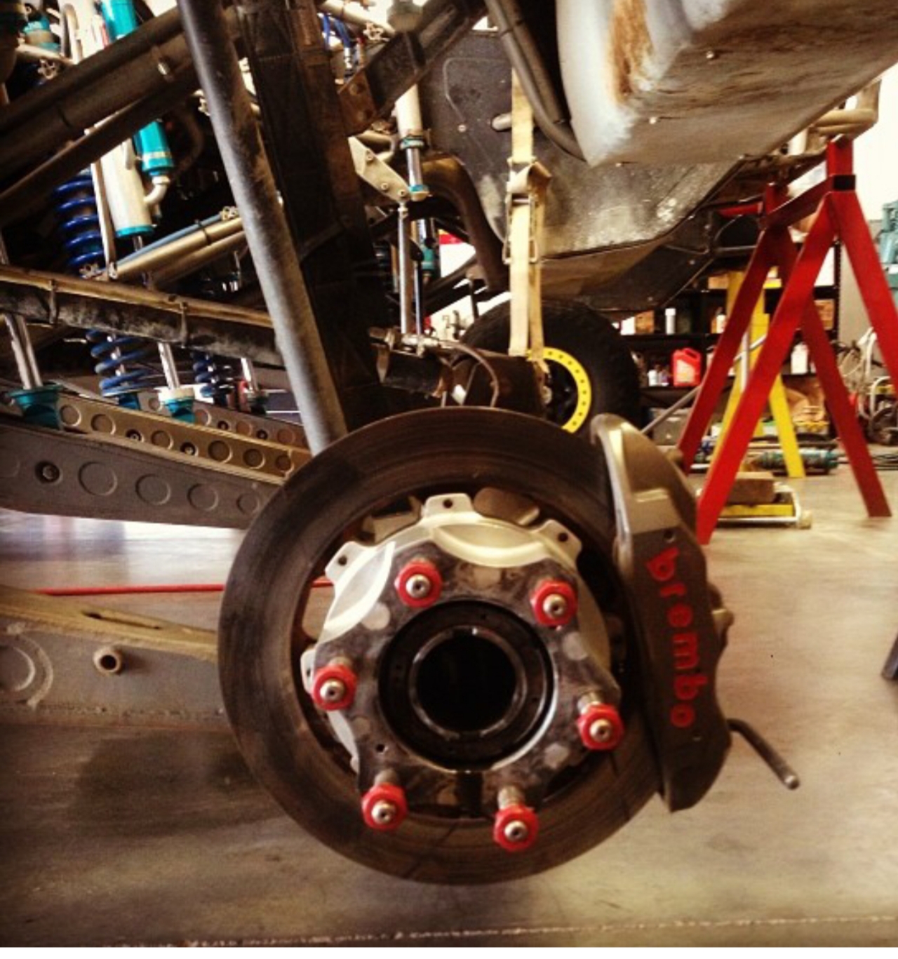

In on a off road race team and we have 2 trophy trucks with big brakes on them. They are made by CNC. Anyways we decided to step it up to the brembo kit which cost about 5k a corner!! That I do not understand but the Walker Evan's rims hit the caliper on it also. So we took them down to Geiser bros. ( who builds the trucks) and they machined the rim to clear it. Works great now. Just don't bolt on a different rim that isn't machined lol. Our rims are also forged so that's why we were able to machine them like that

So I decided to throw the zo6 caliper set up out the window because the calipers cost s shit load and I can seriously buy a big brake kit from bear or one of the other companies for cheaper than it would cost to do the Z06 conversion. Plus I already have the 14in two-piece rotors and everybody says you have to run the 15 in so I would have to scrap those and get new rotors by then basically have nothing in might as well give up so instead I found somebody that hooked it up with the front and rear brackets and I came across a set of Camaro SS Brembo 4-piston front calipers and I can't find any info on anybody doing that so I took the bracket Brembo it's right in the same bolt pattern as the Corvette is the Camaro run the 14 inch rotor not a 15 just like I have so when I get some time I'm going to pull it all off and see what's up. For the back I ended up coming across the ZO6 calipers I picked up four of them 2 Red 2 Silver for a hundred fifty bucks
