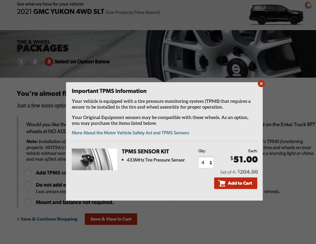

If you build a wheel/tire package on Tire Rack and pay the premium to install these TPMS sensors, I assume you still have to take them to the dealer? Do you know what the dealer charges to program them? A full hour? I'll call Monday, just curious about other experiences. I don't know if $30 per wheel to have Tire Rack install them and have them included in the balancing is worth it esp if I still have to go pay the dealership to program.

I called my dealer, they said if they can attach the programmer to the wheel easily in the lane they'd do it for free. If the vehicle has to go back into the shop it's $135. If they install the sensors it's $25 each. I haven't called Tire Rack to verify the sensors they install are AC Delco or what. I might have to buy the parts separately and DIY, then bring it to the dealer for an install. I'd hate to spend $200 with Tire Rack only to find they can't be programmed because they arent the Delco units.
