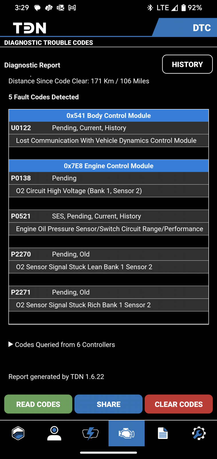

Threw these codes yesterday 5 minutes or so after a cold start. I have a manifold leak so I'm guessing the sensors are probably on their way since it's been running rich.
Don't mind the body control code. Working on the oil pressure code, new pickup tube o-ring going in this weekend.

it's a after cat o2. less important, shouldn't effect a:f. the manifold leak will thou, they suck in air and make it look lean so the ecm adds fuel.
I'd say fix that first. if the bolt I'd broken off, they sell add on clamps to seal it up. clear code and go from there.

Your trouble codes are identifying the driver's side oxygen sensor after the catalyst as the culprit.

I have a clamp on the passenger side but I gave up on the driver side, couldn't fit my hands between the firewall. Debating whether or not I want to tackle manifold bolts this weekend. New arp bolts and fel pro gaskets should be here tomorrow. Gonna order some o2's for next weekend.

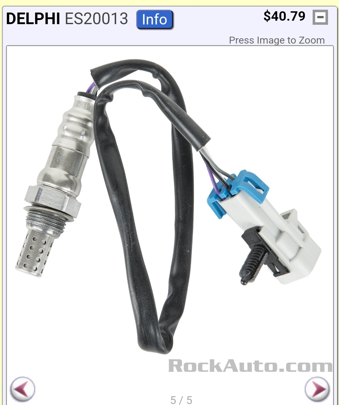

I wanted to add to this. I just changed both my upstream sensors, I noticed the tips were different with the new Denso sensors. The sensors I removed only had a few holes near the tip, but the denso had numerous holes the full length of the tip.
How much different are these, if any...not sure of these are a suitable direct swap.
Mine are: Delphi ES20013 and have the 12583804 as an interchangeable item but that's not 100%.
I will say my driveability is much improved, still need to wait for a full block relearn to calculate MPG
