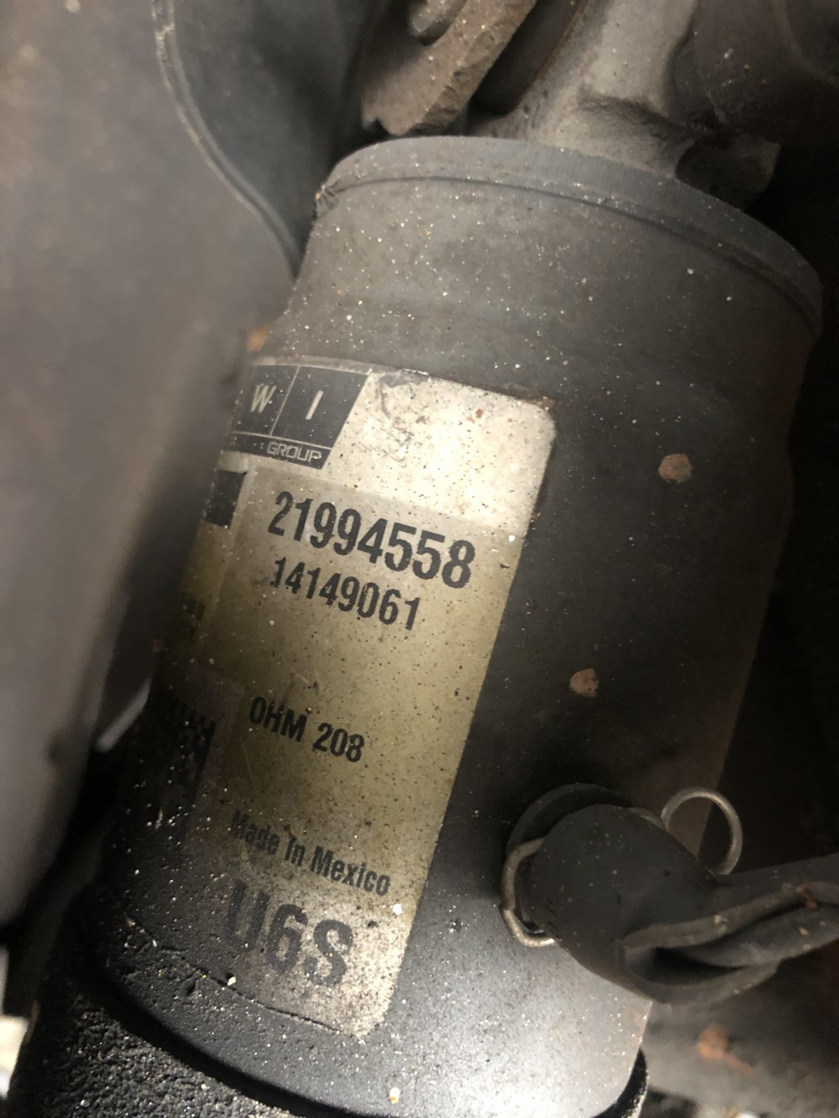

Hi all, I have a 2006 Yukon Denali with Z55 package. I bought some 2" lowering rear springs from Carid. In the instructions, it says if you have "Premium Rides shocks" in the rear, they have to be replaced. I don't know if I do. The build sheet only states Z55 autoride, and according to Carid, the autoride is ok.
Here's a picture of my current shock. The tech help at Carid was a joke. Someone in India telling me exactly what I read in the instructions... I still am unsure as to what I have. Are they considered "premium ride"? I know it's autoride...

I think I may have found the answer... The ZW7 option is the premium smooth ride, which I'm not even sure was available in 2006? So, when I have some time, I'll go ahead and put the springs in.

ZW7 was available in 2006, and your RPO codes in the glovebox lid would show ZW7 and G65 if it was built with Premium Smooth Ride. You don't have that, based on your Z55 code and the wired shock absorber. No need to replace anything for that reason.
