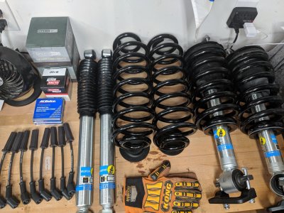

Getting there... And a few other parts...
Now just need a day... Or weekend.

Part numbers seen above.
I do not believe four rear insulators (rubber pads) are needed. Only two.
I am not auto-ride and do not need resistors.
I am also using lower spacers from Rough Country to provide lift rather than using the Bilsteins. They will be at lowest ring, stock height.
If you want to preload like I did you will not be able to purchase new the front assembly's lower spring PERCH - there is no PN, it is not a stand alone piece.
