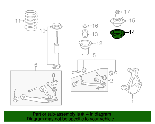

Already have Bilsteins on order. Have the springs too.
What other parts would I need to load my own struts to prep for this front swap?
Tophats.
Any place to search part diagrams? Or can someone tell me?

That is the upper.
I was in need of the lower.
21,297
30,248
That is the upper.
Ok, sorry.
This is my list of parts, anything missing?
Nut, Top 11561435
Mount, Shock Absorber 25869477
Coil Spring Seat 15803177
Bumper, Front Strut 20982216
Spring Insulator, Upper 15840291
Front Coil Spring Set 25876861
Spring Insulator, Lower 15808594
Front Strut 20765171
