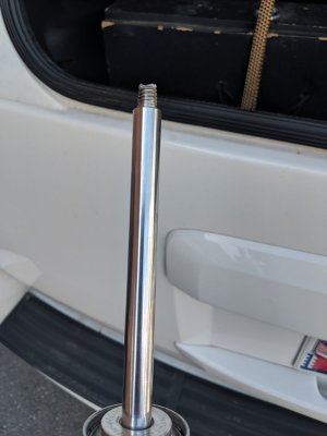

First shop couldn't do it. Second shop no longer services light duty trucks. Third shop, at recommendation of second shop, does the ... well...
I get a call: first one is done... the second one.. well the strut just sheered off.
Bilstein does not cover install screw ups. In an effort to save a tiny bit of work, hit the ******* thing with an impact.. spun the rod loose.
This is why I prefer to do ALL this myself. I am sorry for having to rely on an auto repair shop to do something they should be able to do in their sleep.
Now I got to wonder how f'ed up the other shock is that they lucked out on loading.

Just realize that last part you listed is the strut (shock, spring perch, bump stop cap and nut). I already had the Bilstein 5100s. So I had to buy that part just to get the spring perch piece.
But yes, if you want to go that route you can. Keeping all things stock, mind as well go for a monroe type pre-loaded strut. Do the whole front end for $200. At the dealer you are looking at $400 per front ordering number by number.
Now, seems the shop may be in the clear. In person review presented itself much differently than understood on phone. I am going to fight for Bilstein to warranty.
