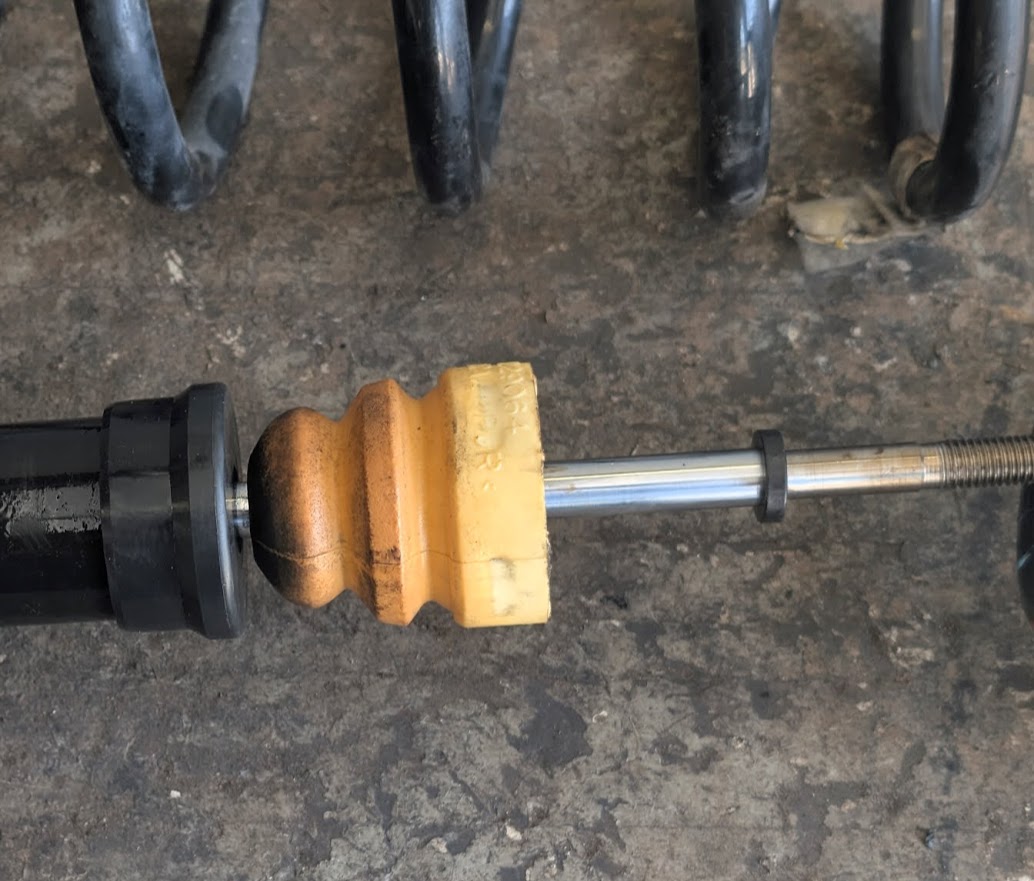

Hey ya'll,
I just got my struts back from a mechanic shop. I asked for them to give me back the old components, which I'm glad I did as it looks like they forgot the small black plastic washer that goes above the bump stop.
Is this piece essential? There's only 1 black plastic washer in the leftover parts bag, so I am assuming that they installed it into one strut assembly and forgot to put it into the other. Pictures of the part for reference. It looks like it stops the bump stop from coming too far up the shaft, but I'm not sure how a little black plastic washer would be able to stop all of that force.
I would have liked to get these struts installed tonight as I need the vehicle for work, but I'm leaning towards heading back to the shop in the morning and have them undo everything and install it. Looks like they'll need to re-cut the connector and probably install a new top locking nut as well since those aren't reusable.

Hey ya'll,
Don’t remember that piece when I did mine?
Also, the connector wires should never be cut they pull out of the harness with a pin removal tool and can be inserted back in. If they are cutting wires they are amateurs.
