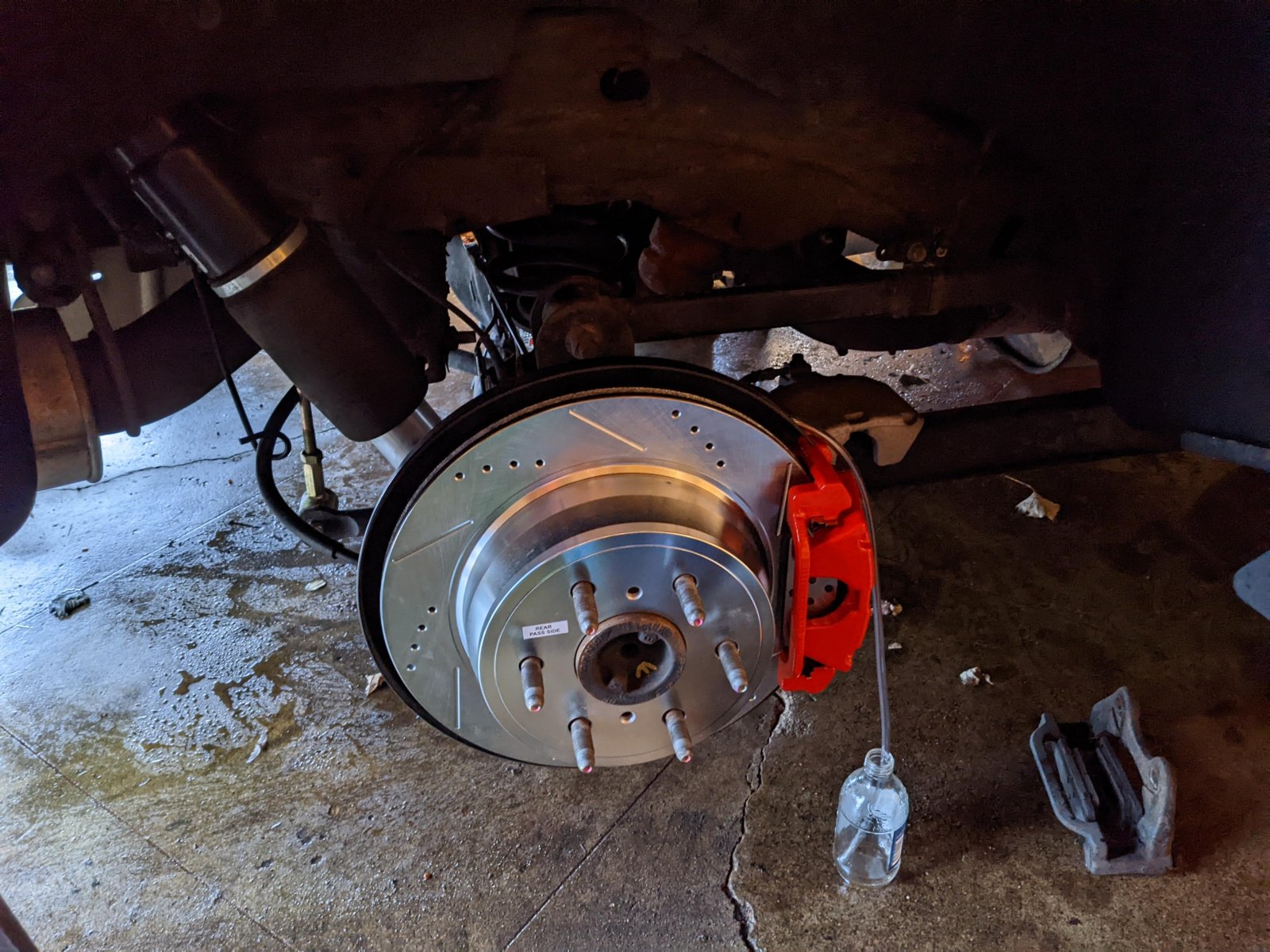

Thinking I can just set the old calipers on 5 gallon buckets on all 4 corners and start at the passenger rear, connect the new hose/caliper, open the bleeder with a tube on it and let it air out into a catch bottle while topping off the master.

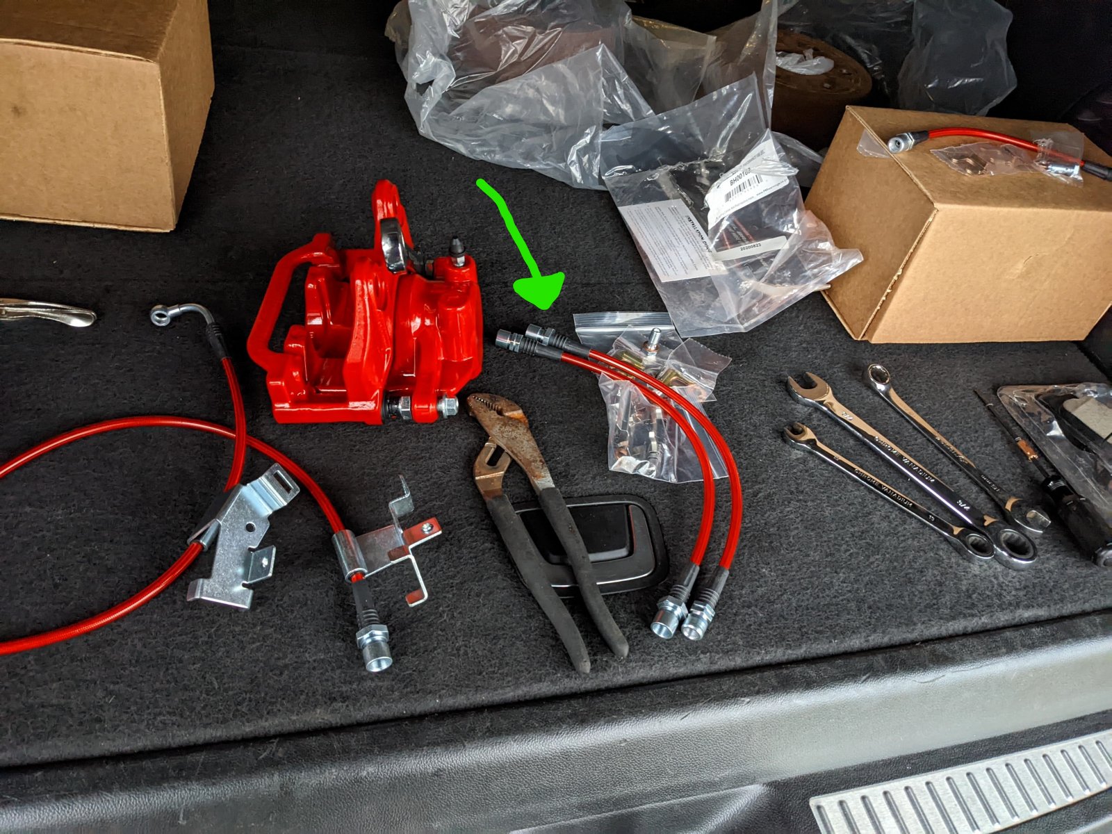

Got a couple rotors on and the rear passenger caliper. Kept storming anytime I tried working on it. Both rear brake line:hose nuts cracked free with a 13mm open end wrench which was cool. Picking up fresh fluid tomorrow. We'll see if I can't bang out the rest.
Power stop included 2 extra hoses I wasn't expecting. I'll have to look again but not sure where these go?

Some findings in the kit worth mentioning are that the two extra brake hoses in the photo above are not for my vehicle and don't get installed. Another unused addition included with the kit is an extra set of abutment clips. From what I can tell - the more premium are the anodized color clips with the pad "spring-outs".
I had this done on my 2015 Tahoe. The mechanic stated the extra set of brake lines go up where the spare tire is. You will need to drop the spare tire to see where they go. He said it was a pain to get to them but he did.
