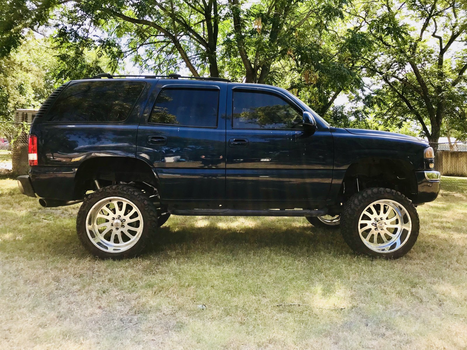

01 Yukon with Sierra front end 6” RC lift with keys up front and 2in spacers in the rear, Spohn upper and lower links and trac bar. 33s on 22x12 C43E8634-CBA3-458E-BC46-7A31CC834664.jpeg

01 Yukon with Sierra front end 6” RC lift with keys up front and 2in spacers in the rear, Spohn upper and lower links and trac bar. 33s on 22x12View attachment 201515
Looks good, love those wheels...they are the exact ones I wanted I just wanted them in brushed not polished. In the end I decided to go with 16s for the old school look, but I will probably go back to 20s or 22s in the future. Your son is one lucky dude!

How cranked are them keys? Got a pic of the front with the cv axle angles?
Looks like the bumper is even with the top of the wheel, I’d say he’s got 2” of crank on it. Probably a total of 8” of lift. Mine sits right at about the same place with 7” of lift on 20s. Figure his wheel is 1” taller from the center of the axle then mine, so for his bumper to be in the same place he would need 1” off lift then I have. Just random math and guessing lol wonder what it will be when he replies.
