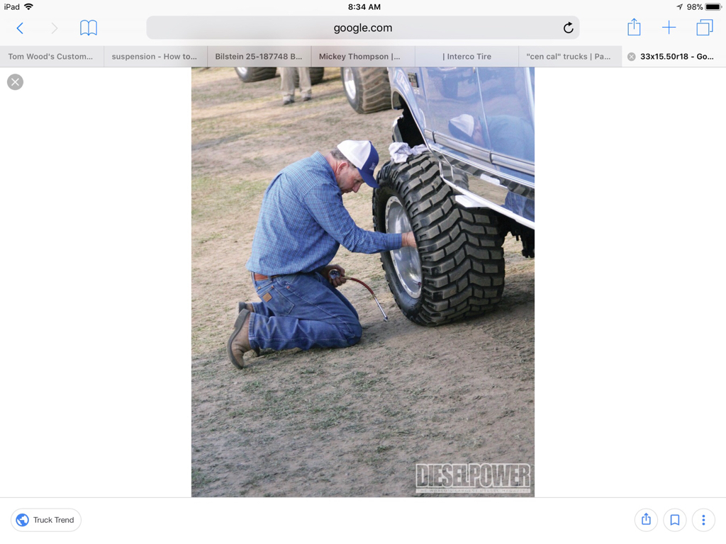

I really want 18x12s with a 33x15.50 Baja Claws. Mickey Thompson made some in the past but no one offers a tire in 33x13.50+ sizes besides Interco and Nitto. And I don’t want either, the Nitto is on a 22. I don’t want 22s. And the Interco tires in those sizes are for 15s, 16s, and 16.5s. If can find a pair of old Welds in 16x12 6x5.5 for a decent price I might jump on those but even then I don’t see any tires that will get me that smaller side wall profile with a huge bubble.
This is another option I have seen and don’t mind. Machined 20x10s for the old school feel with some 36x15.50s for the bubble.

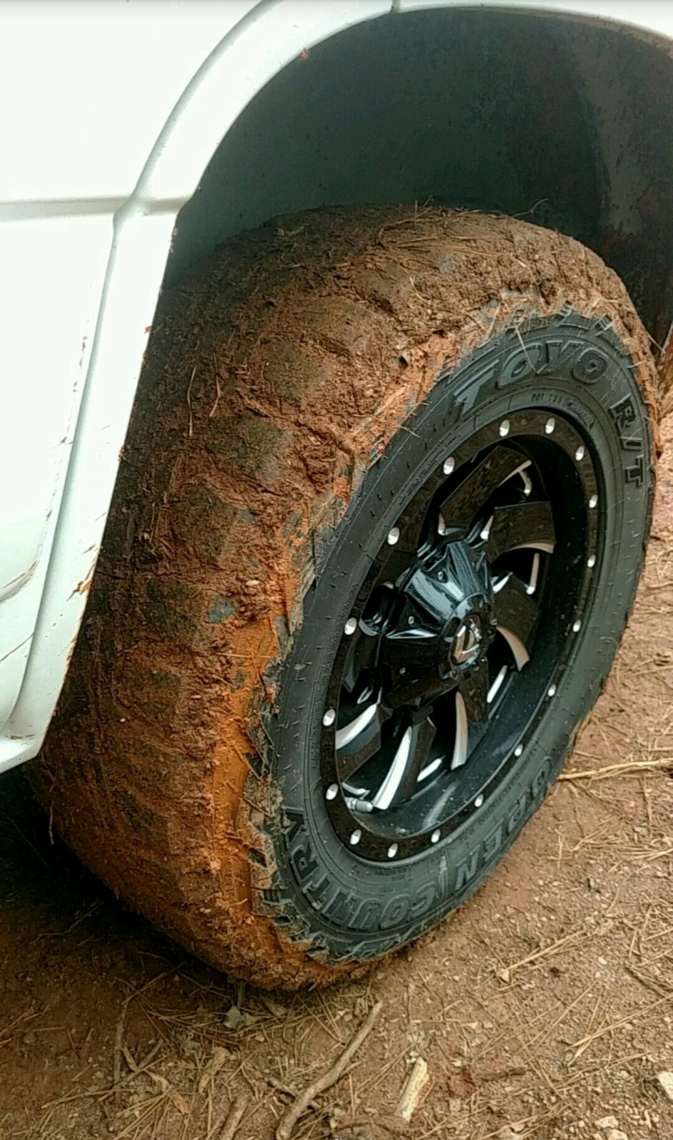

That was with my 35’s and hell no it didn’t mess anything up. A lot of people are surprised but tahoes are beasts
Down to the frame on 35s that’s a pretty deep hole. Some days I really miss muddin’ but then I remember the hours of cleaning and the hours of flushing rocks and mud out of frame rails and I’m good.

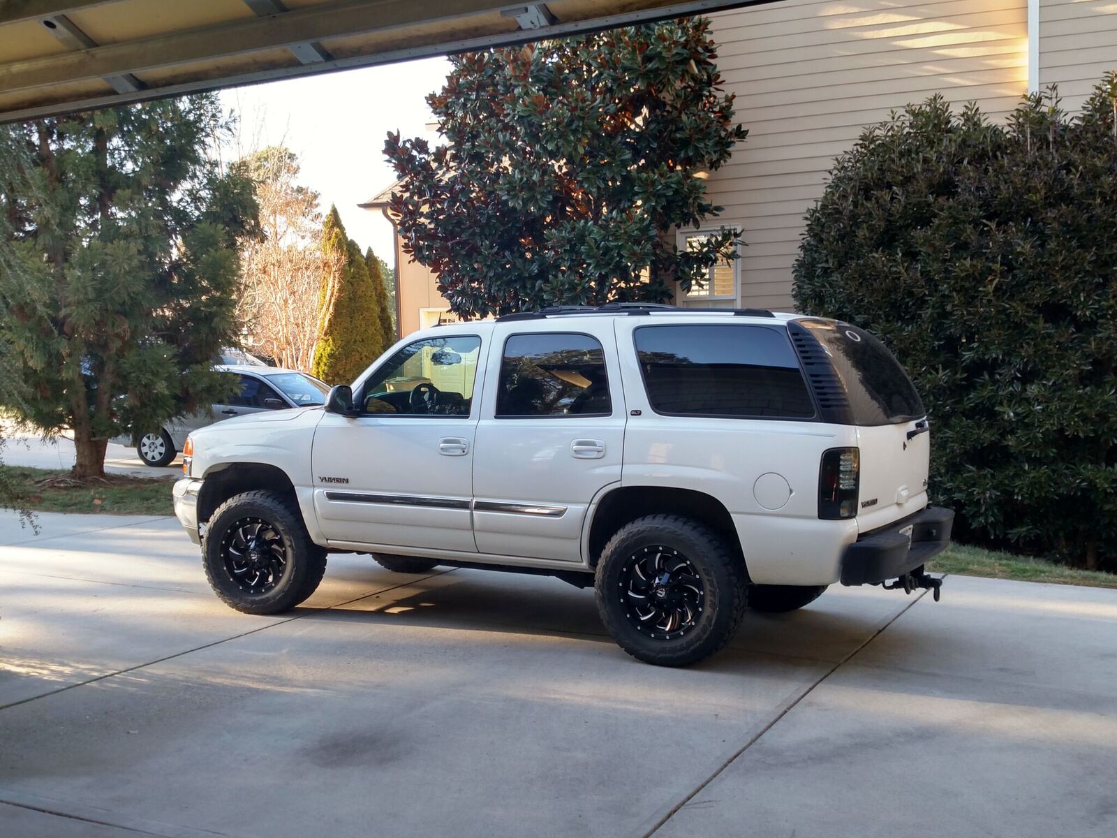

thanks! its an 18 inch wheel on a 33 inch tire. 285 tire not sure of the rim offset but they are not deep dish or anything, but are set back enough so that if ihit a curb they dont get scratched, i can post a pic of them later

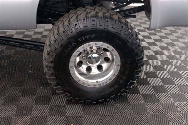

Find some 16x12's, and run these:
https://www.summitracing.com/parts/mtt-59665/overview/
AND, I just saw they can be run on 10" wides. Much bigger selection to choose from, but I've always liked this classic look:

Great minds must think a like, I actually have a tab in my browser open to Mickey Thompson’s tire sizes and I have been eyeballing that 375/65. Thinking I might end up with that if I don’t find something else.
And yes I love the classic look as well, funny you’d post up MT’s old style classic lock wheel. I actually had a set of 16x10s on a dodge the year they came out, 2002 or 2003 can’t remember exactly. They looked great but a pain to clean. Those lock rings actually come off, and mad dirt and water gets trapped behind them and slings out when you drive, in the rain or after a wash. Loved the wheel, was tough and looked great but a big PITA to keep clean. You’d have to wash them, and either drive around the block twice to get the water out and wipe down again or take the rings off every wash.
16x12s would be perfect, I’ll have to find an old set of Welds for sale cause no one makes 16x12s for 6x5.5 lugs anymore. 16x10s wouldn’t be bad but I know I’d end up running 2” spacers to get them out as far as 12s. I don’t mind that but trying to avoid if possible.
