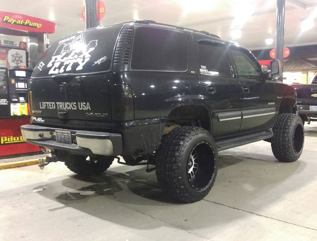

Looks great! This is almost exactly where I want to be. Any thought of wheel spacers?
Agreed.
I am toying with the idea of spacers to bring the wheels out a bit but I'm not sure if it'll do any damage in the future

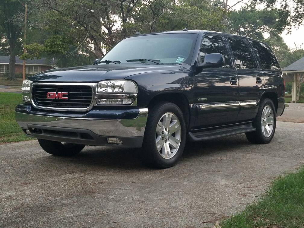

I like that blue truck, wondering where you found that HD hood...i was looking like crazy but gave up lol
You go to any of the meets locally? Really trying to start a group for mature Tahoe/Yukon owners. Get local group buys etc, folks who have something to lose so they do not act up when out at events etc. Help each other out, advice on vehicles, help each other build projects and such.

Yes looked like crazy too ended up ordering after market. And yea always cool to hang out and talk shop

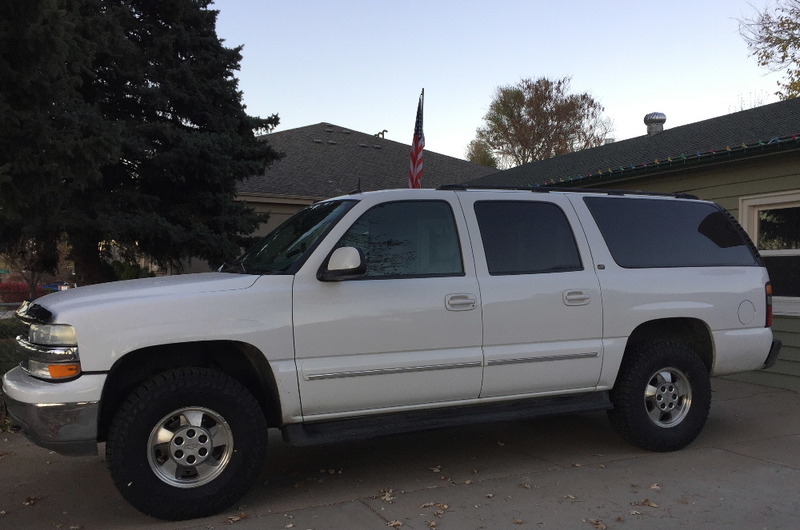

Final picture: Lift + new tires (285/75/16 Falken Wildpeak AT3W):
OK, so I'm quoting my own message from almost 2 years ago in this thread to ask a question: I'm really not happy with the way the rear end sits just slightly lower than the front, even with the Z71 springs. When I pull a trailer it's even worse (though I do have a WD hitch that helps a lot.)
My question for the group: I'd like the rear to be a smidge higher, but not too high. So should I get a 1" spacer or a 2" spacer? Seems to me that a 1" spacer is not neccessarily going to give me 1" of lift because the spacer just pushes up the spring and the spring just compresses a little more, right? So would a 2" be better?
And with either one, am I going to need longer shocks? I don't really want to replace the Bilstein 5100's I put in back in 2016 if I don't have to.

A 1” spacer should give you exactly 1” Of lift. If you put the spacer on top of the spring you will be moving the body up 1” from the spring. And if you got the 0-3” 5100s then you’ll be fine keeping the ones you have.

I've been running 33's (285/75/16) on the factory "cyclone" wheels for almost 2 years now. No rubbing at all. Z71 springs in the back (my 'Burb is an LT) and eBay lift keys up front. Runs great, handles well. I'm a pretty mild off roader (you don't take a Suburban onto gnarly trails anyway!) and this setup has worked very well for me. I'm pretty happy overall, my total investment in my lift is under $600 and that includes the $150 I had to pay to a shop to bust the factory T-bar keys loose (they were rusted in place - thanks to my truck spending it's first 8 years in Wisconsin!)
