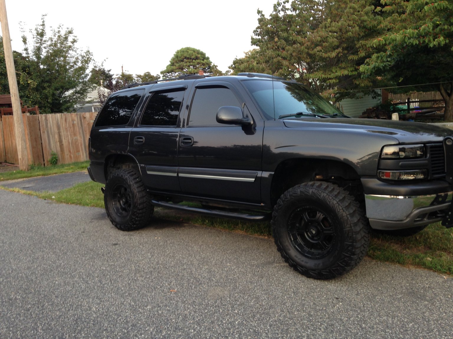

View attachment 58874 View attachment 58873 View attachment 58872 2006 Yukon slt 2wd
5100 Bilstein all around, 2" zone tortion keys, 3" spindle lift. Trying to figure out what to go with for the rear, z71 coils or spacers?

I like it man. What size wheel spacers are you running?

I am running the same lift on my 04 and I also ran this lift on my 02. I have a 1.75" wheel spacer on the rear and nothing on the front. The lift spindles push the front end out about 1.5" inches over stock. This makes the track width basically the same front and rear. It appears that @06yukon619 is running wheel spacers in the front and nothing in the rear.

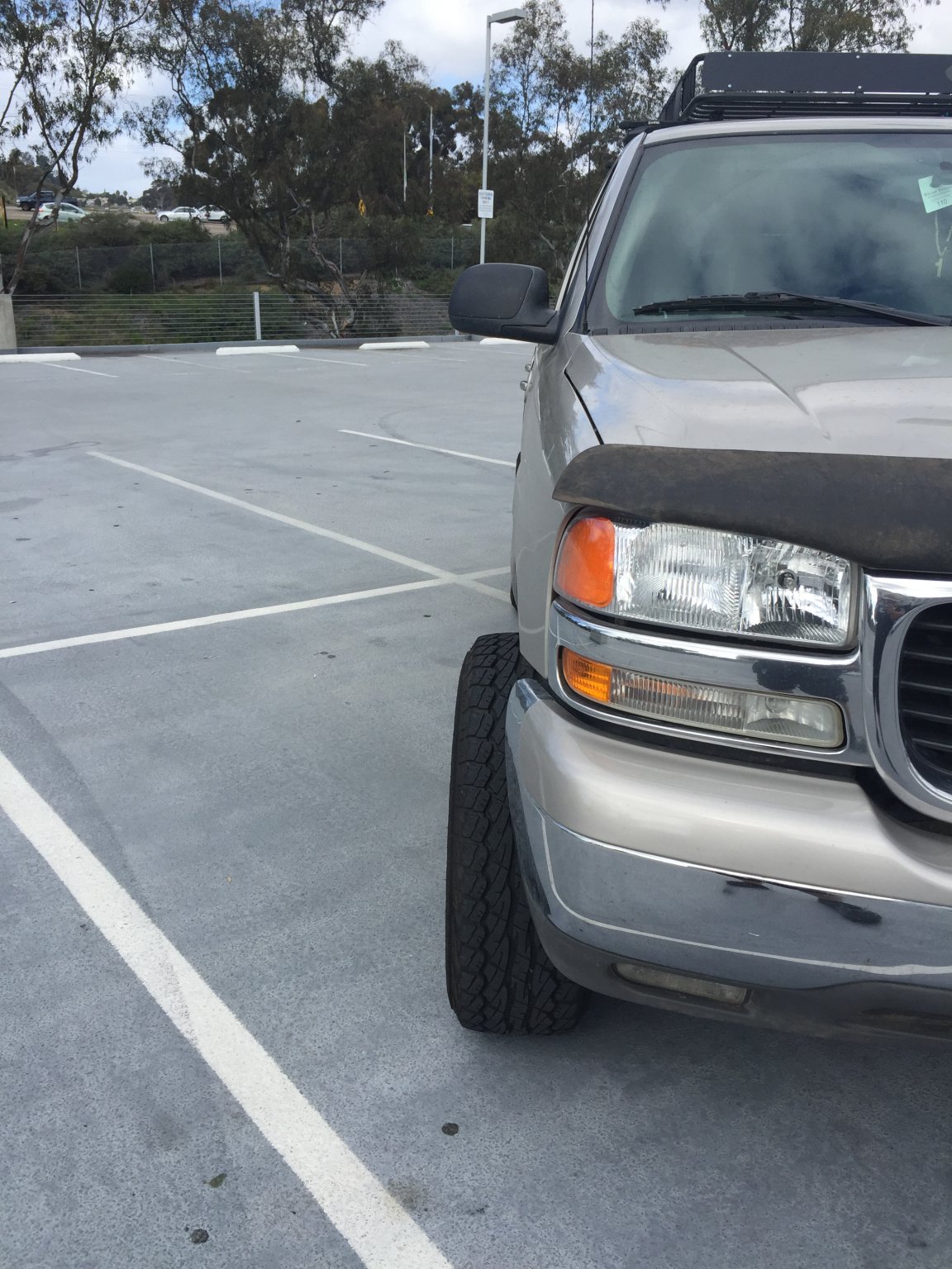

Final picture: Lift + new tires (285/75/16 Falken Wildpeak AT3W):

Ah, forgot to give the final measurements with the new tires:
All measurements taken from the ground to the bottom of the wheel well opening:
LF: 38.25 (+2.75" from stock)
LR: 38.5 ( + 2.125")
RR: 39.125 ( + 2.5")
RF: 37.75 (+ 2.25")
Trailer Hitch: 15.625 (+ 2.25")
Got her all washed and shined, vacuumed out and put the 3rd row seat back in: Now that we're done with camping she's the "Wintertime Family Bus."
