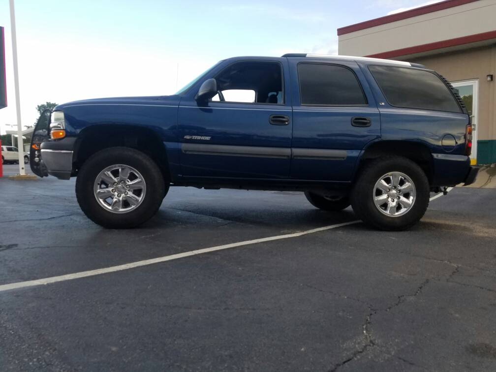

Update installed z71 springs. So currently have life Keys, passenger torsion bar on driver side, and z71 springs
Sent from my SM-G930V using Tapatalk
Good looking truck, better get some spacers in the back though or you will be getting pulled over for runnin' shine.

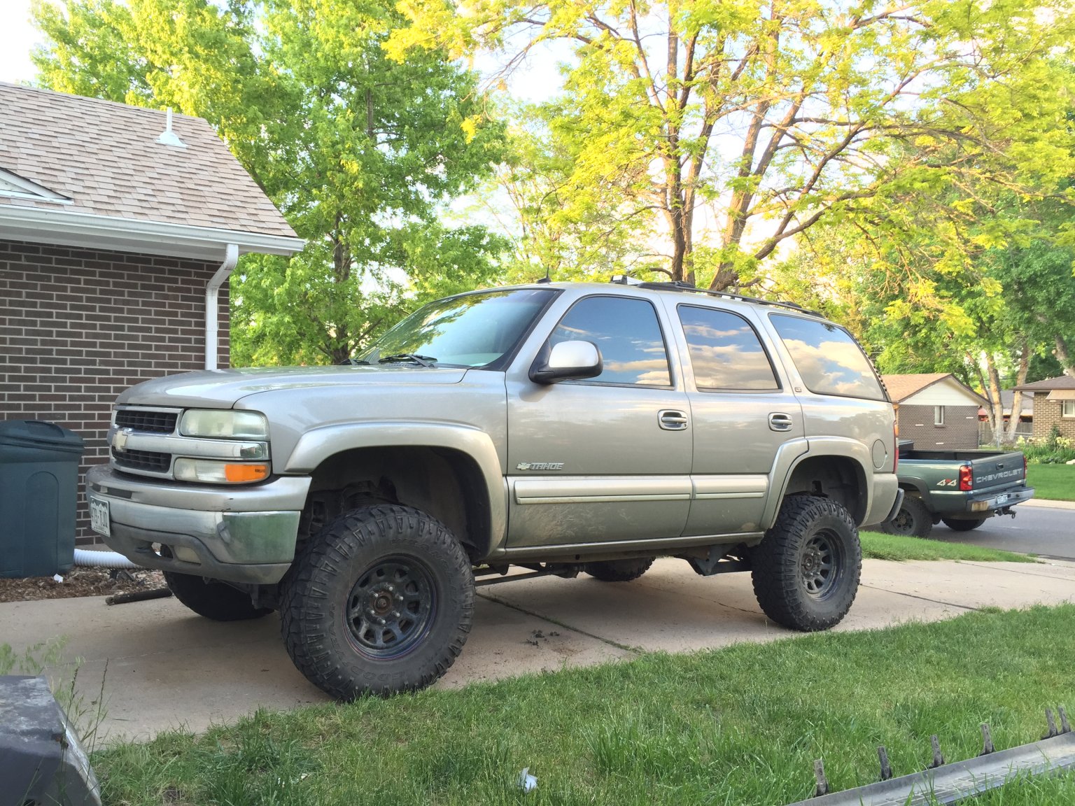

I bought my 2003 Tahoe a little over a year ago. It already the lift so I'm not completely sure what it is, but I think it is a 5" Skyjacker. I added the wheels and 33" duratrecs. With the lift, tires, and G80, this thing is pretty unstoppable on the trails out here in Colorado.

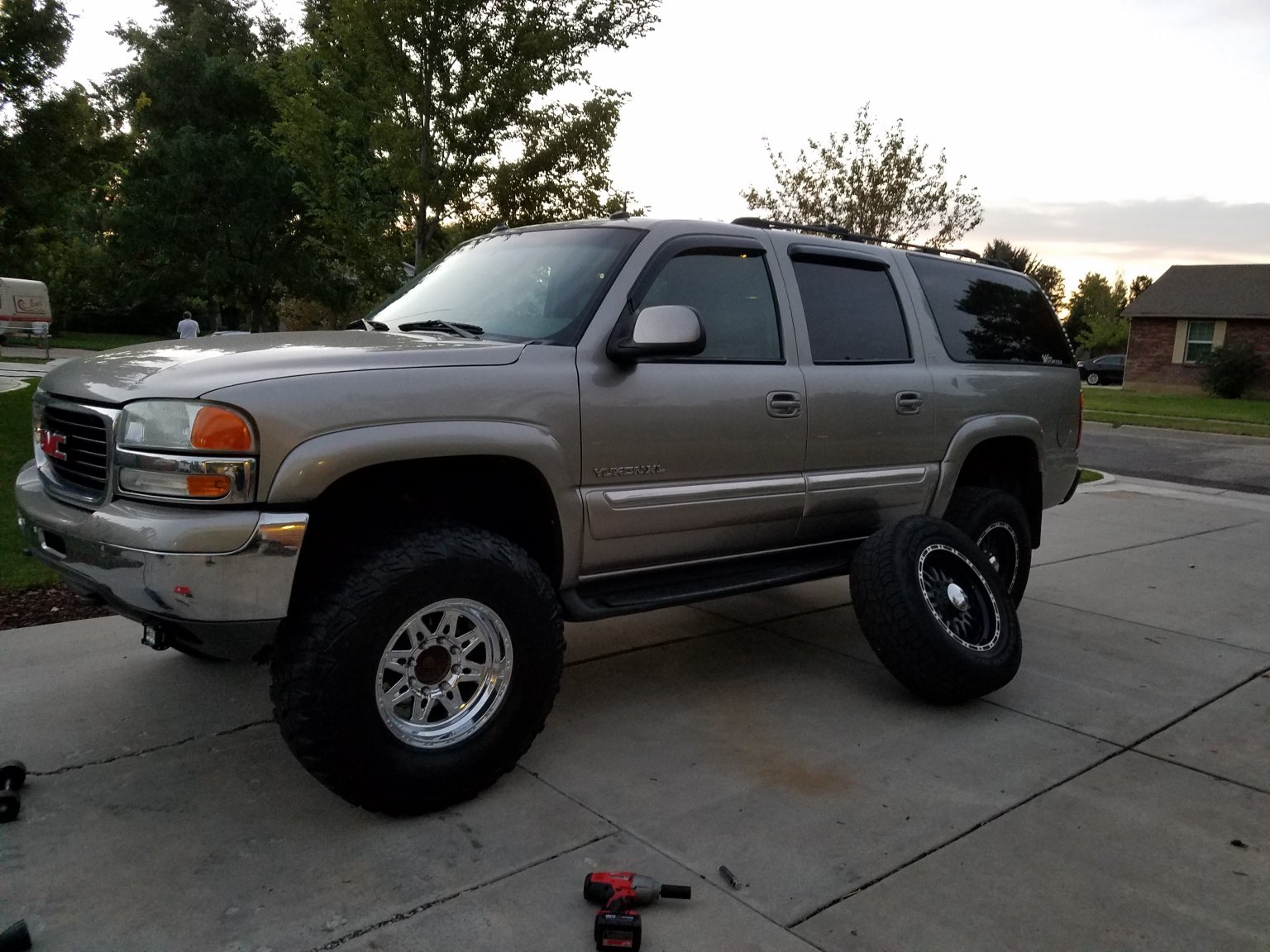

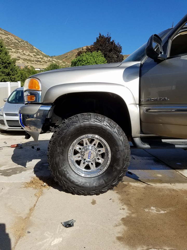

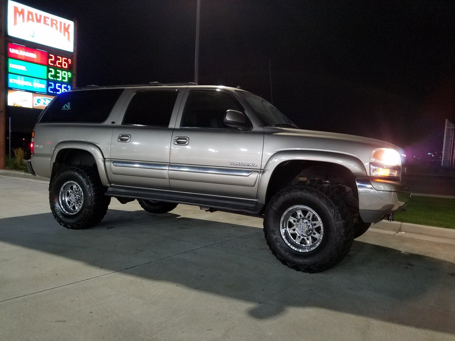

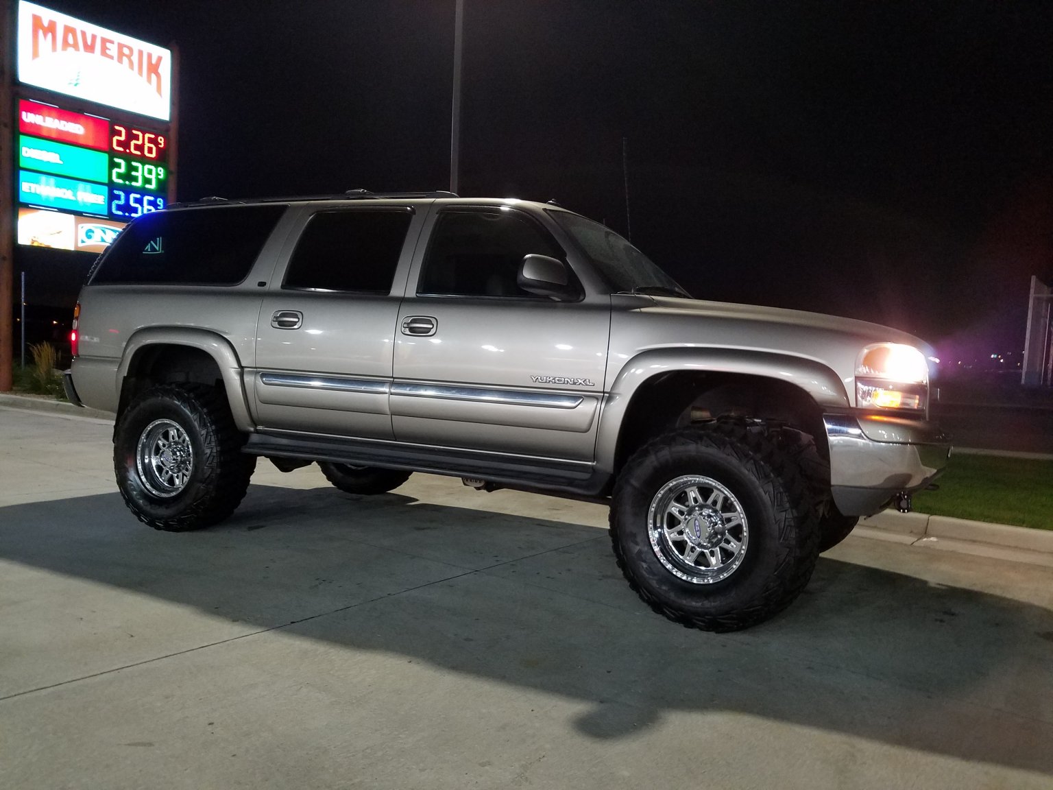

I'm new to GMC/Chevrolet but I can say I love this SUV. 6" Tough Country no body lift. I went from 33" 37" so I had to crank the keys a little and big hammered the back of the front wheel wells. I will eventually cut the front bumper. It doesn't rub except when turning in reverse, turning on bumps but going straight is smooth. 20160905_200720.jpg 20160905_205518.jpg

I'm new to GMC/Chevrolet but I can say I love this SUV. 6" Tough Country no body lift. I went from 33" 37" so I had to crank the keys a little and big hammered the back of the front wheel wells. I will eventually cut the front bumper. It doesn't rub except when turning in reverse, turning on bumps but going straight is smooth. View attachment 66533 View attachment 66534
Wow. When civilized society does finally break down, that is the truck I want.
UtahYukon
Aug 21, 2016

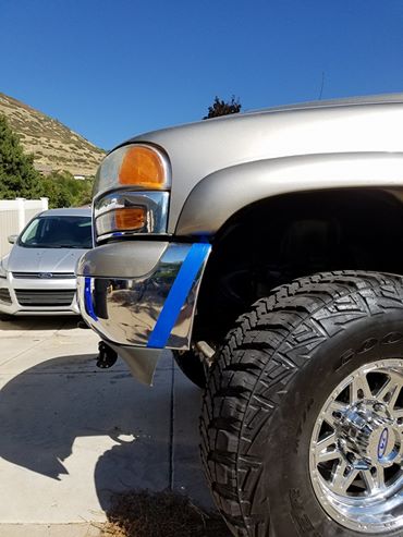

I read on the inter webs that I could cut to fit... so I did! Cut bumper and cut and ground the tar out of the rear of the front wheel well. If you do this WATCH OUT for the rear AC lines on passenger side.

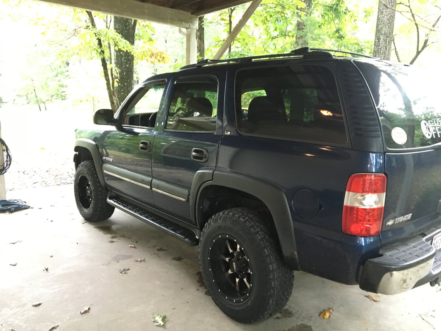

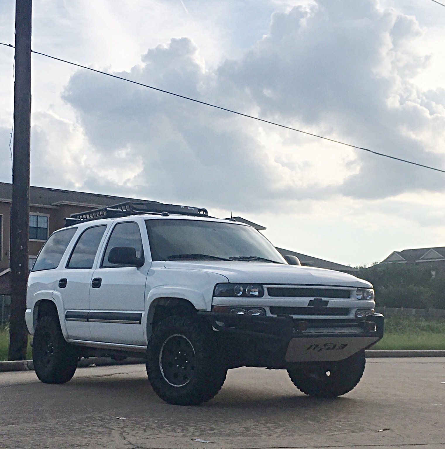

Keys, Spacers, Cognito front sways, TJ rear sways, 17x9 4.5" back spacing, 295/70r17, wheels sprayed w/ bedliner, got beat up changing the tires so working on removing bedliner around the lip of the wheel, then polishing the aluminum or removing all and re-painting, shock extenders for now, Bilstein 5100s going on early next week
Coming soon
Spindles, c50r Spring, spohn track bar, ss brake lines, moog UCAs, pitman, idler, tie rod ends, 4.11 gears, tune

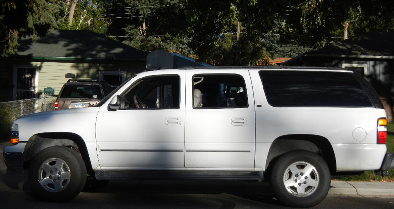

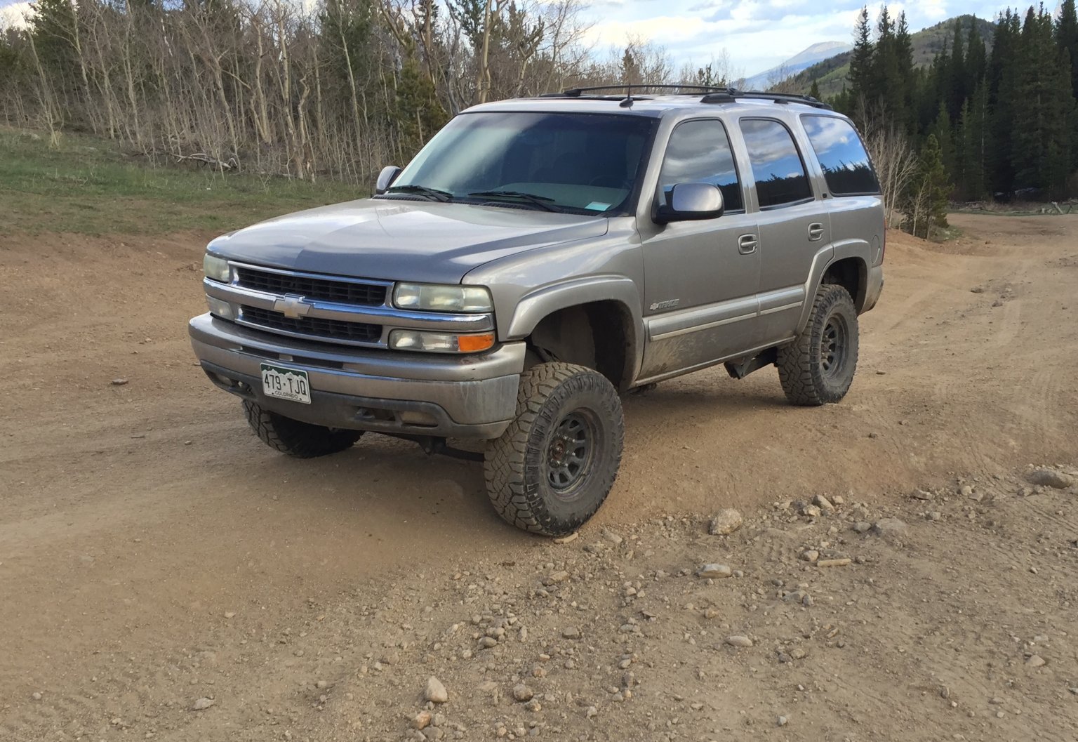

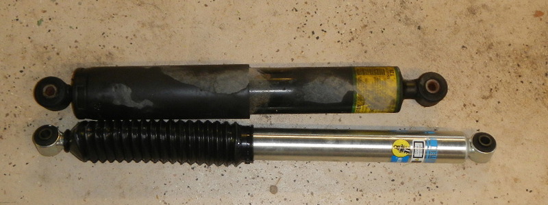

(I already posted this in the "what did you do to your NBS today?" thread but I wanted to get it here for those who might be looking to do a similar lift. Vehicle is a 2004 Suburban LT 4x4, non-autoride.)
Finally got my lift done! I decided to go with a basic set of keys up front, Z71 springs in the rear rather than a spacer (my Suburban is an LT so the Z71s are taller), Bilstien 5100's all around and just to be on the safe side, new sway bar end links up front.
A friend from another board (Expedition Portal) came over on the weekend of 9/24 to help me install the kit. We got the rear end done in less than 2 hours, moved on to the front. Got the shocks and sway bar ends but could NOT get the T-bar keys out no matter what we did! I should point out my truck spent its first 8 years in Wisconsin and has some pretty significant surface rust. Apparently the keys were rusted to the bars.
So, I threw in the towel and took it to a shop. They ended up putting it on the lift and using an air hammer (and lots of PB blaster) and finally got them loose. Since there was so much rust I went ahead and replaced the bolts and the nuts (retaining plate) for the T-bar keys as well.
I took measurements before and after. Before measurements were about 35" at the front fenders, 36.5" at the back and 13.5" at the bottom of the trailer hitch.
After measurements were 37" front, 38" rear and almost 15" at the hitch.
Before:
After:
I haven't got the alignment yet, I want to make sure the keys are exactly where I want them before I do that. Now that my lift is on I can consider tires. I had been thinking about 285/75/16's (I have a set of 16" "cyclone" wheels) but with as much lift as I have now I'm considering maybe even 295's.
EDITED TO ADD: For those interested, here is a side by side comparison of the components: LT vs Z71 springs:
Factory rear shocks vs Bilstien 5100s:
Didn't get a photo of the front shocks, unfortunately. They were in pretty bad shape! Replaced those with Bilstiens as well.
