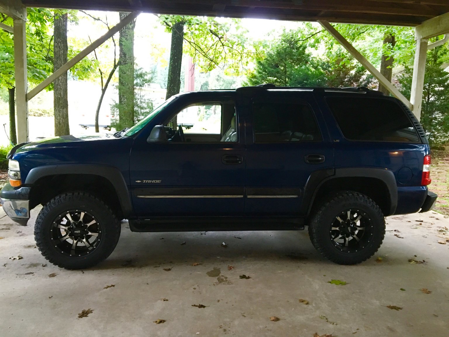

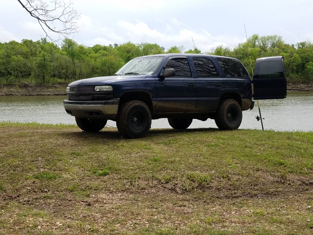

When I first installed my 6in RCX lift I ran 35/12.50/18 Open Country MT's for a couple years with no spacers. Here's a pic from years ago with that setup (no spacers)
After adding a 3in body lift and keys runnin 37/13.50's I ended up throwin on some 2in wheel spacers just because I wanted to widen the stance. Not for clearance.

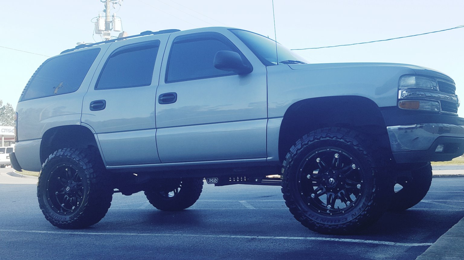

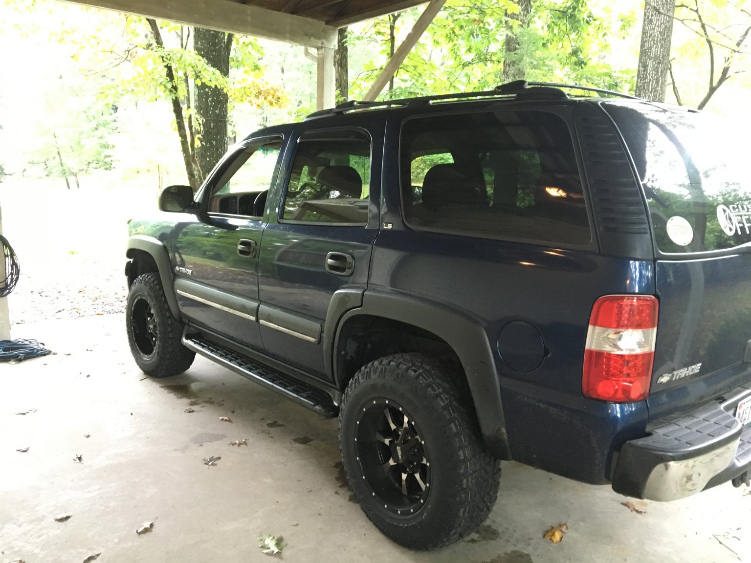

2005 Tahoe Ls, 6 inch RCD lift with Bilstein shocks, 20x10 -24 offset with Toyo 35x12.50 20's

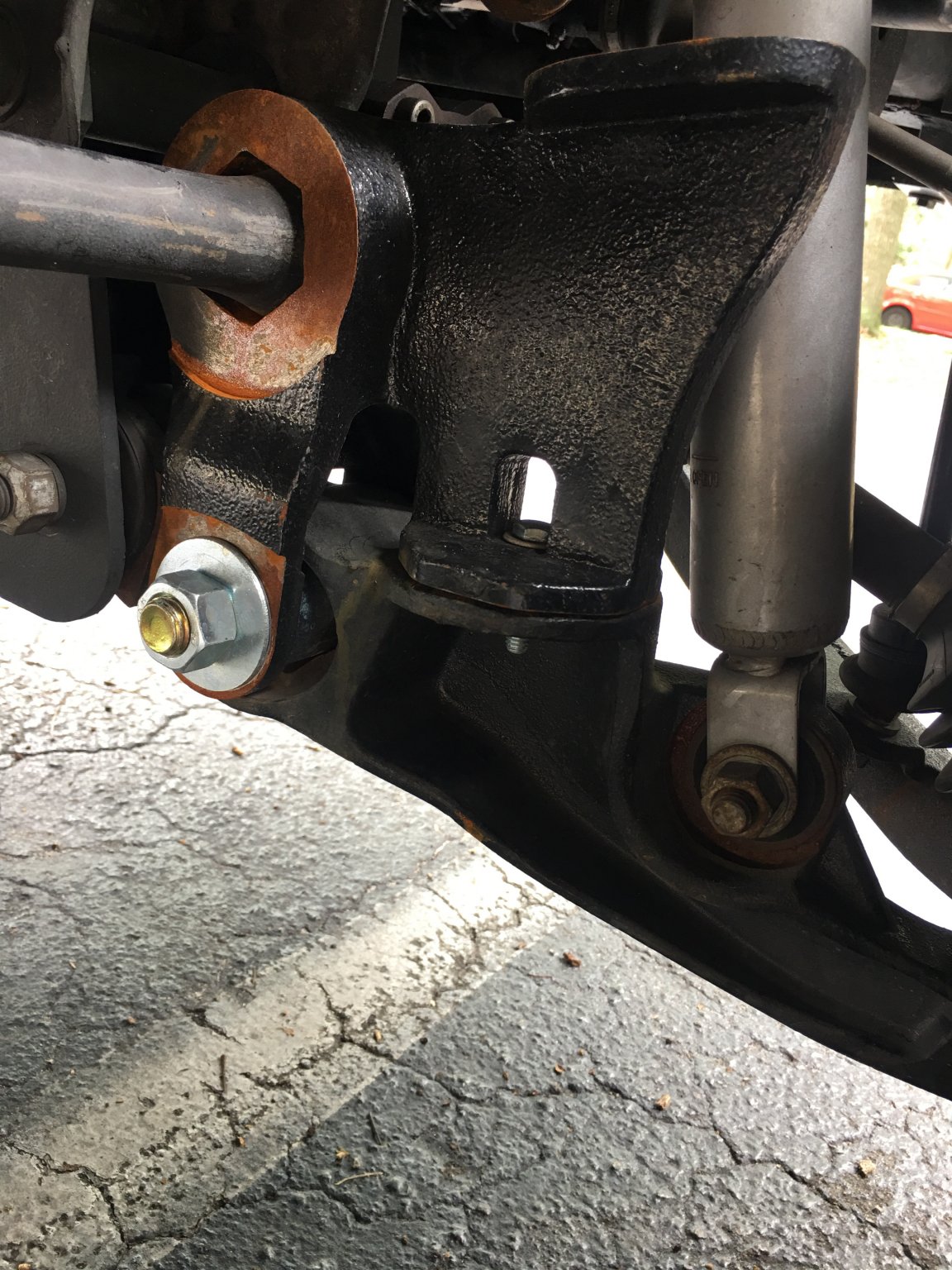

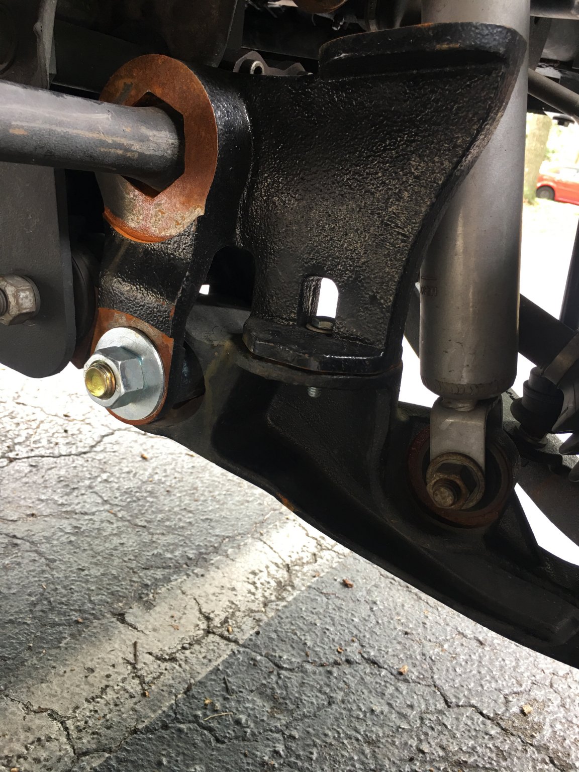

Lookin real good brother, ridin high! I just recently upgraded my 6in RC lift with the NTD brackets. The torsion bars hangin below the frame, I couldn't take it anymore lol. Especially with as much of the frame showing with the 3in body lift to make room for the 37/13.50's

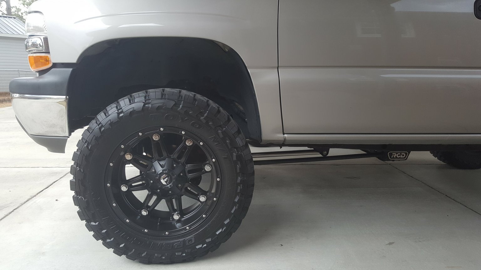

Lookin good brother, ridin high! I just recently upgraded my 6in RC lift with the NTD brackets. The torsion bars hangin below the frame, I couldn't take it anymore lol.
I was going to order the Z71 rear springs and front keys to give it another inch or so after I put on the Nfab side steps that have been sitting in my garage for a month. Yours looks awesome, but RCD lifts don't have anything to raise the torsion bars, so I'm S.O.L.

Order the brackets from RC and the bracket sleeves! It's all you need and they'll work with any other suspension lift because the bracket literally sits on top of your current LCA to raise the torsion bar hole to the factory location. It was approx 150 bucks and I had them in two days.
All you have to do is remove the torsion bars, put the new brackets on the LCA's with the sleeves that go in the original torsion bar holes, remove the cross member brackets that drop it (for the rear of torsion bars/keys) and reinstall it in the factory location. Reinstall the torsion bars.
I know, I know, I should've painted the machines surfaces before I installed them. I'll get around to it one day. lol.

I'll definitely look into it, thanks for the info! I don't really mind the torsion bars, since i sanded them down and painted them.

Mine didn't, they came with spacers, that's why I was going to get the springs. Look up the RCD kit and you'll see.

Yeah I didn't mind them before I added the 3in body lift but after that they really stuck out like a sore thumb. At least you now know the option is there lol.
