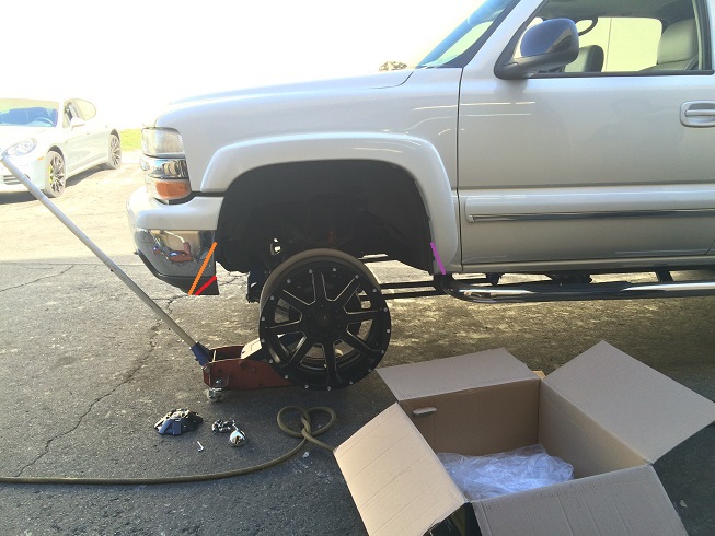

Here is a picture for you showing off 3 different cuts you may need to do depending on your lift setup and wheel width:
So as you can see there are 3 lines drawn on that picture. You have a red and orange line on the front of the fender well and a purple line on the back of the fender well. (Original pic is from 20Hoe3, I just added the colored lines in paint)
***Here is what these color coded cut lines mean to you based on how much lift you have and how your lift is done***
*** If you are only running a 6" lift and your torsion keys are in their stock position (meaning you do not have a leveling kit/ ford 3" lift keys stacked on top of your 6" lift) then this is what these lines mean to you: ***
+ If you are running wheels that are somewhere in between 0 and -24 offset, then the red line is the only trimming that you should have to do to have full clearance.
+ If you are running wheels that are somewhere in between -25 and -44 offset, then the orange line is the only trimming you should have to do to have almost completely full clearance.
+ If you are running wheels that are somewhere in between -45 and -76 offset, then you will have to do trimming alone the orange and purple line in the pic to get extra clearance.

*** If you are running a 6" lift and you also have a leveling kit stacked on top of your 6" lift to achieve 8.5"/9" of total lift in the front OR if you are running a 8"-9" suspension lift (like the McGaughy's Suspension lift) then this is what these lines mean to you: ***
+ No matter what width wheels you are running, as long as you are only running 35"x12.50" wheels then I believe the only trimming you should need is the red line along the bottom of the front bumper.
+ If you are following this write up, have 8.5"/9" of suspension lift in the front, made the red cut line, and you still rub and decide that you need to make the orange or purple cut lines on your truck, please post here and let me know all of the details of your wheels/tires/lift so I can update this for future users!

*** HOW TO MAKE THESE CUTS ***
+ If you are doing the red cut line, as long as you have a steady hand and can make a clean cut, all you need is a dremel because the only material that you are cutting through is plastic.
+ If you are doing the orange cut line, you will need something a little stronger, a sawzall is what I used to make my cut line with through the metal part of my front bumper.
+ If you are doing the purple cut line, this cut is referred to as the "NorCal Mod"

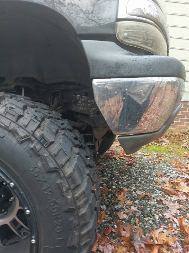

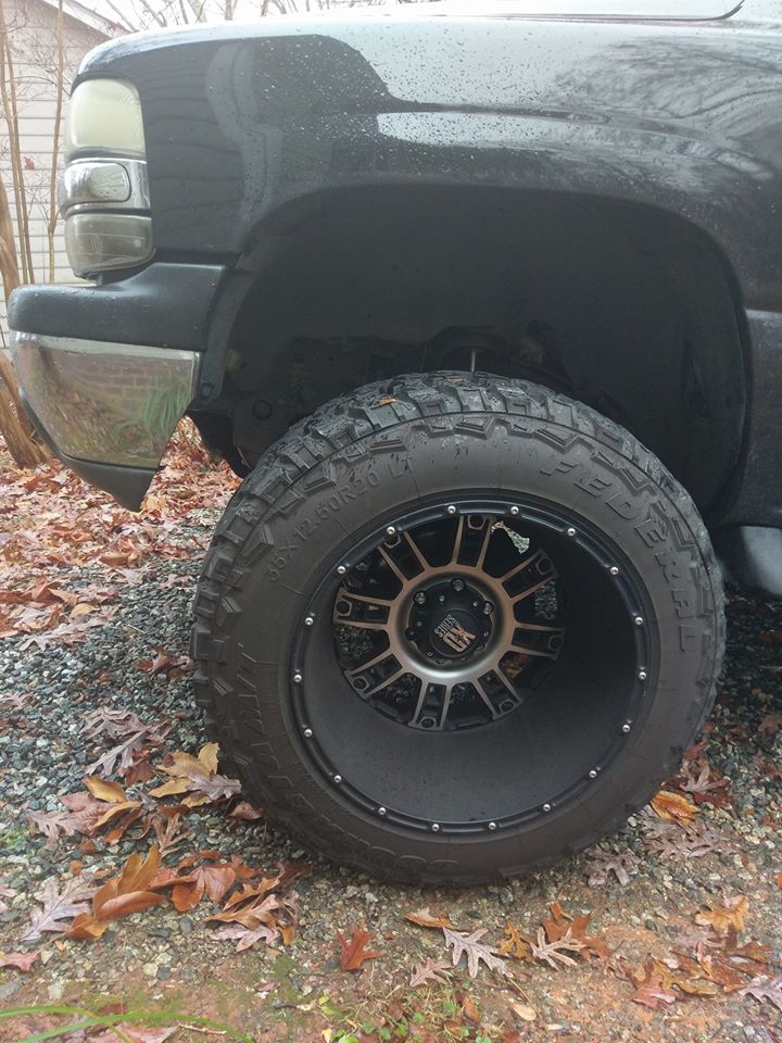

Here are some pics of my front bumper and how much I trimmed it for everyone to see:bumpercutdriverside.jpg

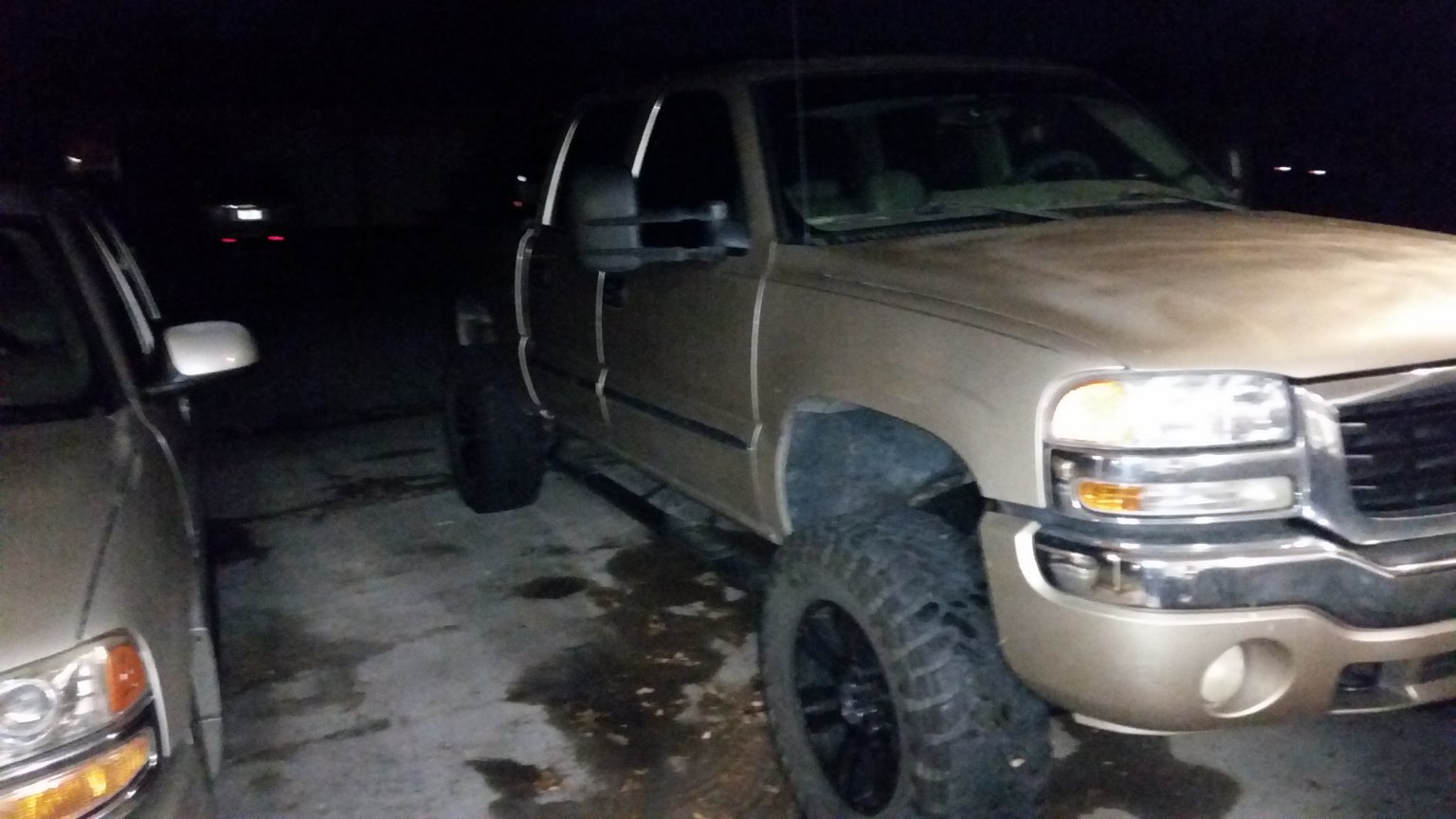

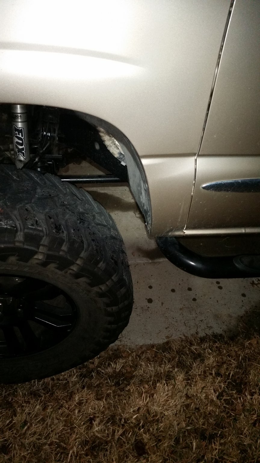

I just saw this post and it's dark outside so this is all I have in my phone. I go take some pics real quick and see what they look like. 20170220_194657.jpg 20170220_194727.jpg
You can't see what I did but it gave me some clearance. I'll get better pictures Wednesday afternoon in the daylight at full crank.
