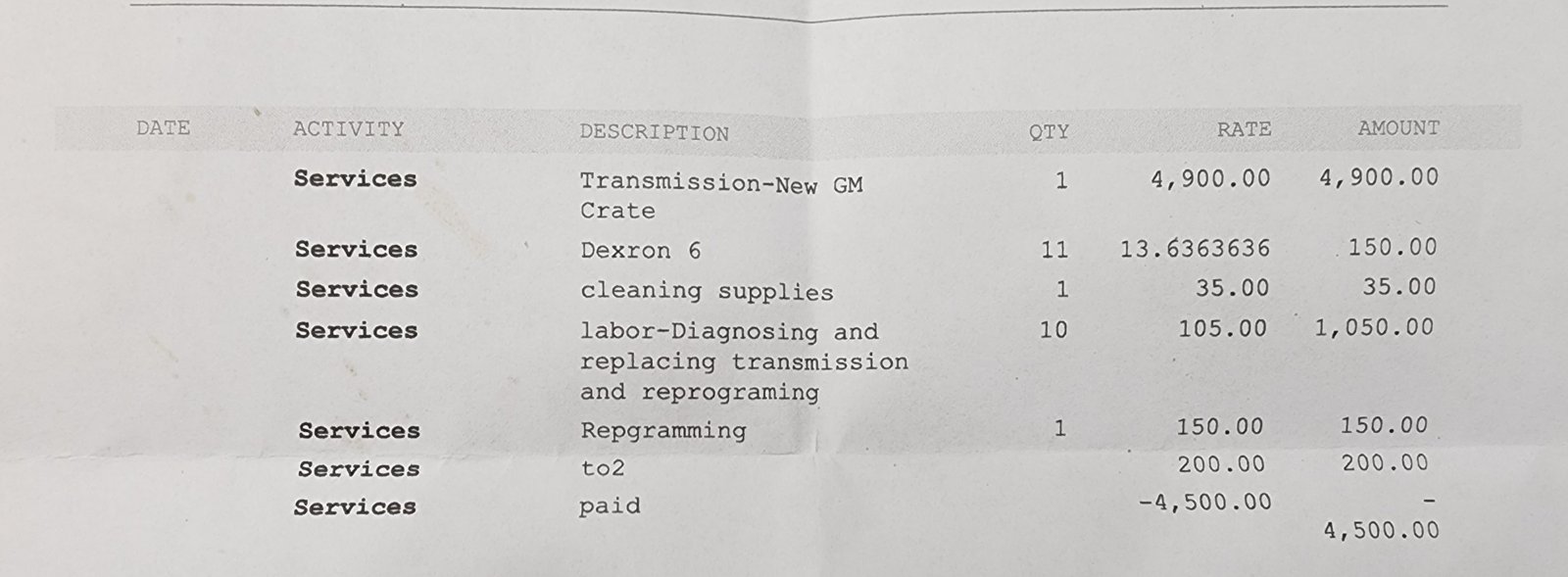

Nick, thank you. Here is the history:
July 2023: Engine rebuilt due to lifters, deleted, custom tune optimized for towing.
July 2024: Transmission blows while towing. New GM transmission installed by local (ohio) mechanic where my car died. Taken to a GM dealership to program.
Last week: Transmission clucking begins.
It actually did a bit of clunking when I was towing before the transmission blew.
I don't think the local mechanic did any of those things you mentioned above. The rear main seal was replaced when the engine was rebuilt.
My local mechanic, who has the Denali right now, said the transmission was 'programmed' to act the way it is.
I have no idea what's going, just that the clunking is not normal and I don't want it to blow another transmission.

The GM units come ready to plug and play, no adapt relearns or programming needed. If all of your downshifts are harsh, it can be your tuning and/or non-transmission causes, as also suggested. Engine/powertrain sensors and switches can also cause irregularities in transmission behavior. These include the MAF, TPS, Ignition switch/module and many more.
These symptoms can also be caused by weakness in the transmission itself, specifically the compensator feed system which is a combination of apply, accumulation and exhaust circuits designed to mechanically control shift timing, firmness as well as prevent centrifugal apply of clutch packs inside the unit when they are not supposed to be on/working. It can also be the torque converter failing which, in case of it being so new, it would be defective.
If it's just the 3-2 downshift that indicates to me something's potentially weak in the 3-5-R hydraulic circuit causing the clutch not to release timely. This can also be cauesed by the TEHCM or valve body (or both).
I'd rule out any non-transmission causes first then contact a GM service center and see what they will do for disgnosis and warranty replacement if/as necessary.
Whichever shop or dealership svc center did the trans R&R work should have also inspected all mounts, the driveline, wheel bearings, flexplate and other systems underneath to catch and repair/replace anything that's worn/bad. They should have also done the rear main seal, flushed your lines and transmission cooler(s) to ensure all contaminant from the previous trans failure was removed.

But wouldn't the vehicle not work properly if it went back to the default tune? I mean I told the transmission guy that he could not flash
You're welcome...I would definitely have the mechanic go over the vehicle with a fine tooth comb to rule in or out causes and sources of your clunking. Even a worn rear transmission mount can causr those or similar symptoms.
Not sure i like his explanation about the shifting but maybe that is simply the extent of his knowledge. Shift strategy logic is programmed to the TEHCM based on OS variant which is driven by a number of factors including model/sub-model, installed powertrain package, variant of valve body (they changed a few times over the years in the 6L80s and 90s) and more.
Keep us posted.

I'm curious who tuned the tranmission?
My guess is that the new trans is just the stock calibrations.. And that whomever tuned
the vehicle last year did some of the normal mods thru HPTuners that makes the
6L80E a "nice" transmission to have. (personally imo the factory settings suck!)
yeah, I was going to say, who ever tuned it can flash it back to stock as a test right? you don't have to have a dealer do it. it would also tell you if the tcm was replaced or not. as the new one would need to be re credited?
