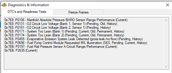

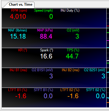

Well, as I figured, it left me on the side of the interstate otw home from work. Just ran HP Tuners on it, at idle fuel pressure is 42-43 psi, but when you give it some gas it drops to 7-8 psi. And get these....
