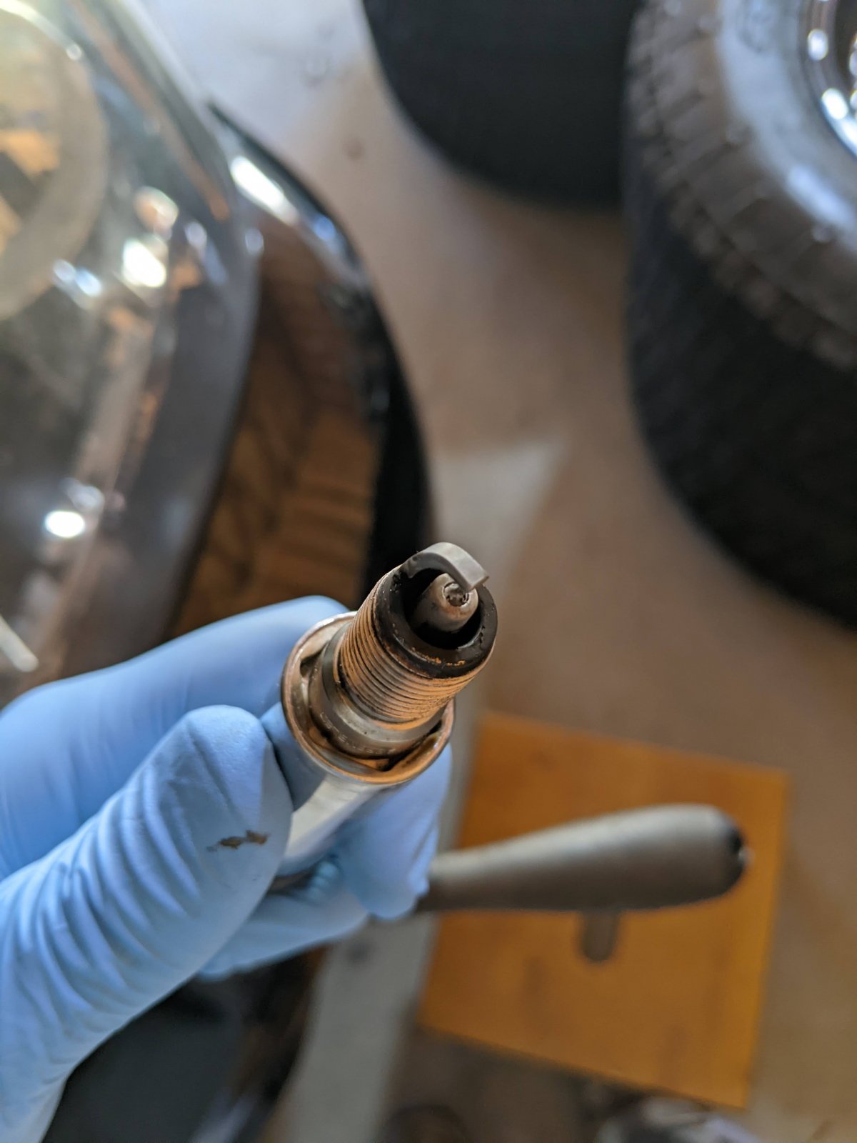

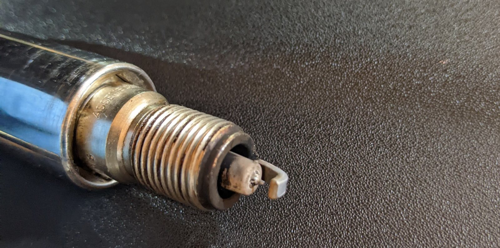

2010 Avalanche - Had a rough idle problem that was solved with new plugs a while ago, but now I feel like it's coming back after only 800 miles. Pulled a few plugs (1, 2, 3, 7) today to check them out. I could be wrong, but I don't think they're supposed to look like this after 800 miles. They all had oil in the threads and carbon/soot down near the tips. I've already done the oil pan deflector thing and have a catch can on order. I'm thinking I probably need to change out the valve cover also as I've never done that so I assume it's the old design. What else do I need to look at? Is this something other than oil causing this?

What brand and type of plug are you using ???? May just be the wrong plugs
or even counterfeit parts that you installed.
These are AC Delco 41-110 Iridiums from RockAuto. I think the plugs I had with the original rough idle issue may have been counterfeit as I got them off Amazon. In that thread someone suggested buying from RockAuto this time so I avoid that issue. That's what I did so these should be genuine plugs.

You didn't try to "gap" them did you??? Just covering the bases this is very
abnormal. Did you replace plug wires too ??

Have you looked at your short- and long-term fuel trims?
I have not looked at this. Honestly, I'm not sure what it is. :) I will see if I can view it in the Torque app.
I did not gap the plugs, but I did check them all before installing. There were all at .04. I did not replace the wires this time, but they were replaced with the last set of plugs 20k miles ago. They are AC Delco 748UU.

Ok sounds good... Yes, don't touch the irridium gap.. Adjusting the gap in a different process
than traditional plugs and you can mess them up even checking them if not careful.
So, that being said: check your fuel trims as suggested. Make sure your oil is clean.
Make sure your Throttle body and MAF are clean as well as air filter...
Other than that, you may have an underlying issue if it is running rough after
just several hundred miles.... after a service.
I would suggest using some good injector cleaner too (like Techron) or similar

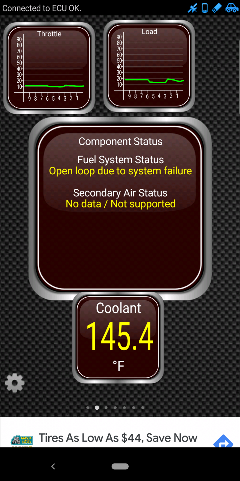

Does this offer any useful information? I don't know what this might mean other than it thinks there's something wrong in the fuel system, whatever that means.
