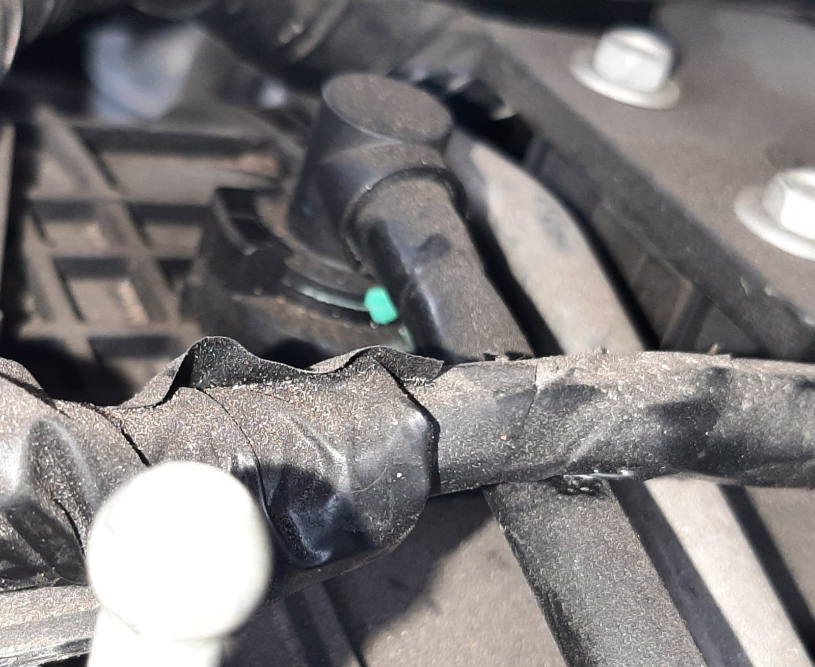

The last thing I am doing is an oil catch can. Can any one help me with the manifold connection? My stock tube is hard plastic to the plastic elbow. I think the elbow comes off with 1/2 turn? How did everyone else connect? Remove the plastic tube and use the stock elbow or a different fitting? Pic below
That fitting on the top of the manifold is super brittle and I've never known them to just disconnect. I'd recommend cutting the 90° bend out of that tube, located down a few inches where it curves back to run towards the back of the rocker cover. Just cut it an inch or two in each direction going from the center of that bend. Slip your catch can hoses over the remaining straight pieces of pipe.
