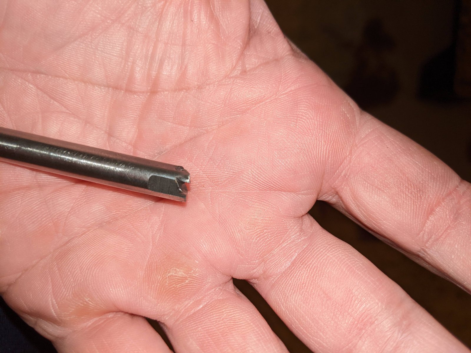

Of course I had to give it one more try before I started putting everything back together. What do you know, the lifter freed up and shot the pushrod right out like it's supposed to. So, in theory my truck should be drivable now once I get my computer back. However, the damage that the tool took when the lifter finally freed up has me a little worried. I'm guessing there's a little piece of metal floating around in there somewhere now. My plan was to put a bottle of Rislone in it and let it idle for a little while and then change the oil anyway. Hopefully whatever came off the tool will get caught by the filter. AFM delete kit is scheduled to be delivered Friday and I talked to the shop about bringing it in Monday morning.
